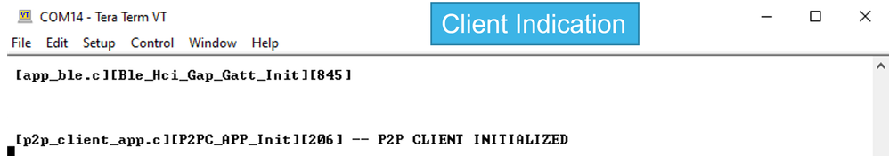

4.1 Initial Power Up
Figure 3: Client Indication Initial State

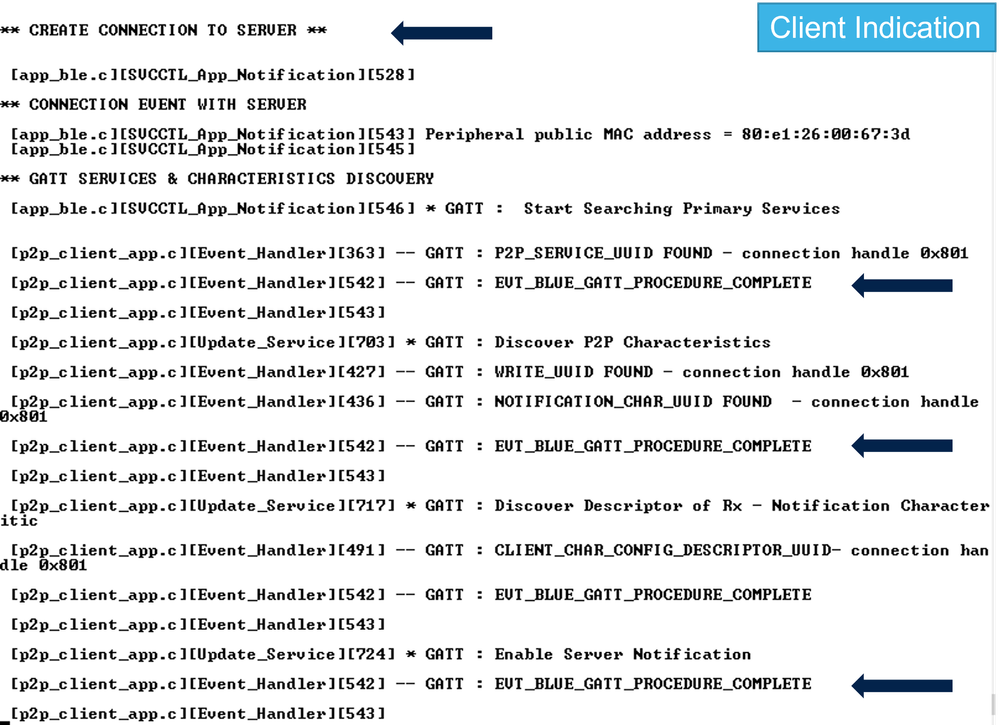

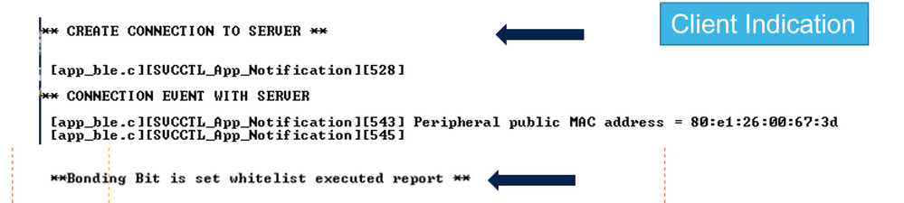

4.2 Scanning/Advertising Connection Process
Figure 5: Client Connection Process and Connected State

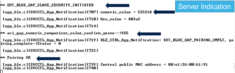

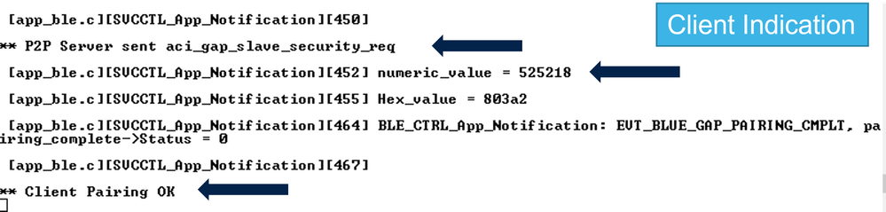

4.3 Security, Pairing, Numeric Comparison
Figure 7: Client Pairing, Security Confirmation
Figure 8: Peripheral Pairing, Security Connected State

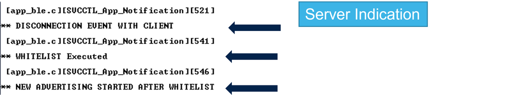

4.4 Disconnection from Client and Restart Advertising From Server

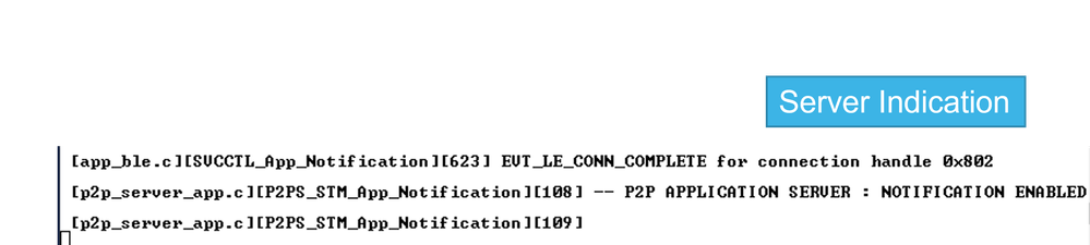

Figure 9: Client Intentional Disconnect With Peripheral
Figure 10: Server, saving Whitelist and New Advertising with Whitelist Filter

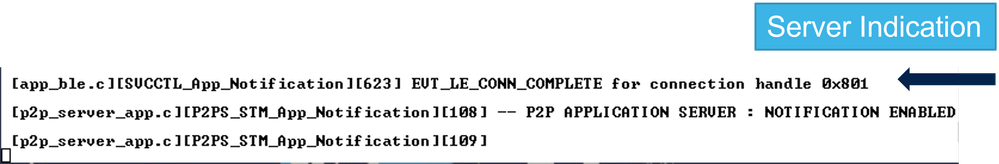

4.5 Reconnection Confirmation Client and Server
Figure 11: Client Reconnection with Whitelist Device
Figure 12: Peripheral Connection with Client
