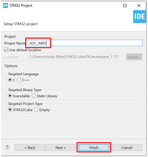

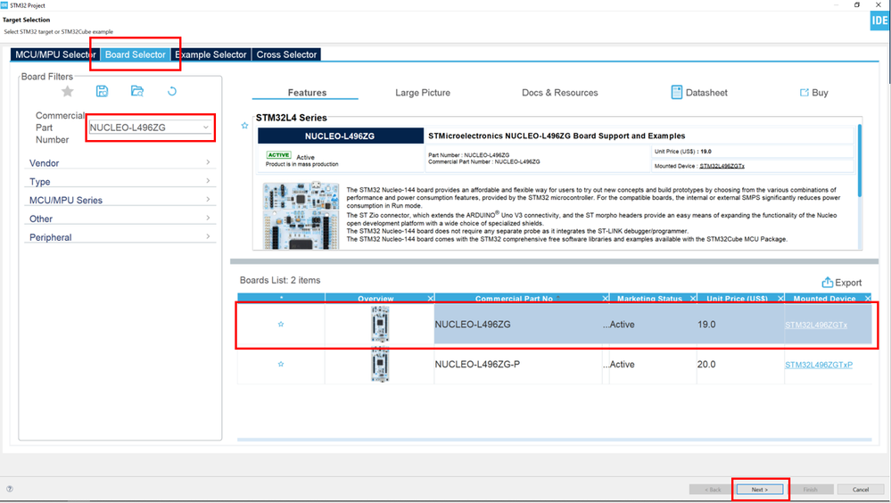

  2. Create a new project using the NUCLEO-L496ZG board
  1. Give a name to the project

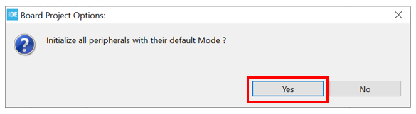

  1. Initialize all peripherals with their default mode settings by clicking on Yes

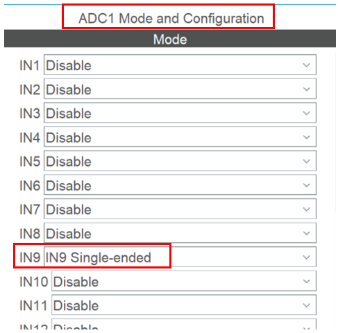

We will do a continuous conversion mode on channel 9 which is PA4.

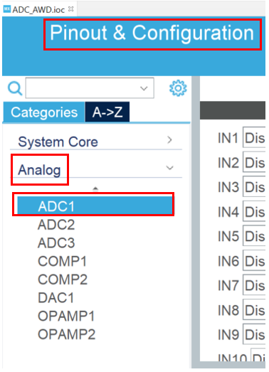

The ADC1 can be found in the Pinout & Configuration Tab of the STM32CubeIDE under “Analog”.
  1. Enable ADC1 Channel 9 which is an alternate function for PA4

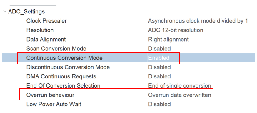

  1. Configure ADC1 Parameters settings
We will enable the continuous conversion mode of the ADC1 so that the channel is continuously converted. We also want to overwrite the data so that no overrun situation occurs because we do not want to have to read the converted value after every conversion. We will keep the rest of the configuration by default.

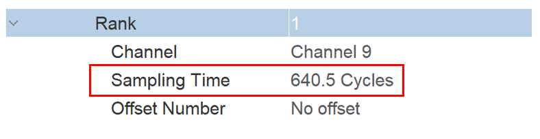

  1. Change the sampling Time of channel 9

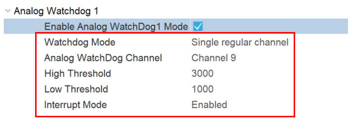

  1. Enable Analog Watchdog 1
  1. Configure the Analog Watchdog 1
For this configuration we will select a single regular channel watchdog mode on channel 9 that we have previously enabled. As described before we will use the following threshold for the analog watchdog window:
High Threshold: 3000
Low Threshold: 1000
We will also enable the Interrupt mode so that an interrupt is generated when the converted channel is outside the defined window.

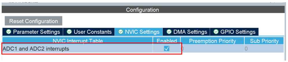

  1. Enable ADC1 Interrupt
We are going to use the call back function of the ADC analog watchdog so interrupts need to be enabled for ADC1.

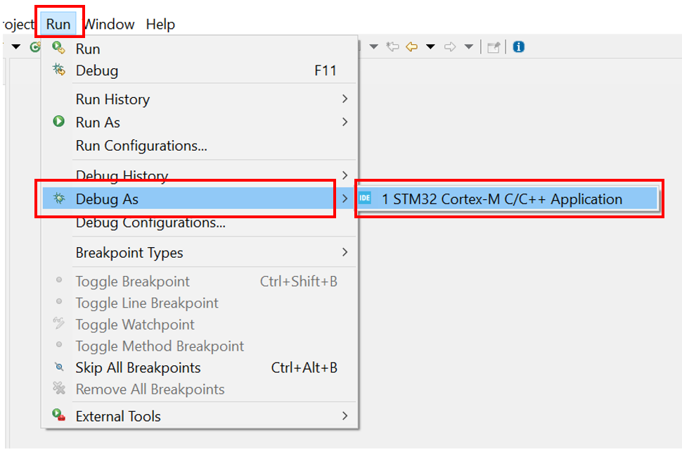

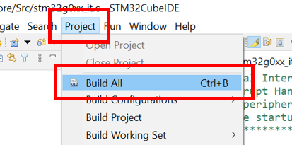

  1. Build the project, enter debug mode and run the code
After the project is built, enter a debug session and then click on the Resume icon to run the code.
Now if you change the potentiometer position you will see that the LEDs will turn on and off depending on whether the converted channel is outside the analog watchdog window or not.
