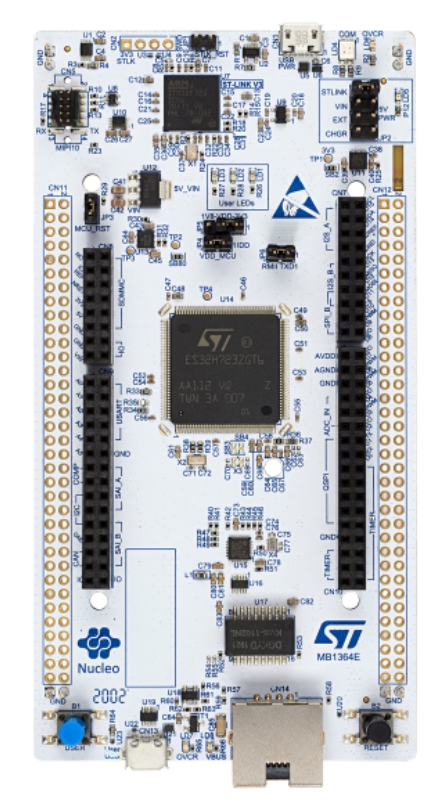

    • A micro USB cable used to power the Nucleo board from a host machine and to load the code into the STM32
    • Nucleo-H723
Figure 1. Nucleo-H723 boardFigure 1. Nucleo-H723 board

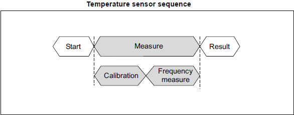

The DTS generates a square wave with a frequency that is proportional to the temperature. The frequency is measured either with the PCLK or the LSE clock. This article shows how to configure and use this peripheral using the STM32CubeMX with a Nucleo-H723. Figure 2 shows the temperature sensor sequence measurement.
Figure 2. DTS sensor temperature measurement sequenceFigure 2. DTS sensor temperature measurement sequence
The frequency measurement starts by software. The reference clock used in this article is the high-speed clock which is PCLK. The quick measurement is disabled so the calibration starts automatically before the temperature measurement. According to the DTS specification, the counter clock must be slower than 1 MHz during the calibration phase and it is disabled automatically during the temperature measurement. As the DTS clock input exceeds that frequency, the divider must be used. For sampling time, 15 samples setting is used. A High and Low Threshold can be set to define a temperature window, that if exceeded, will generate an interrupt (that is, if the temperature is higher or lower than the thresholds).

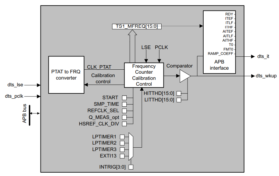

Here is the block diagram of the DTS shown by figure 3: Figure 3. DTS block diagramFigure 3. DTS block diagram

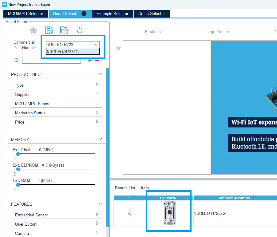

  2. Start the project based on a board by selecting [ACCESS TO BOARD SELECTOR] and type the board name as shown in the figure Figure 4. Select the boardFigure 4. Select the board

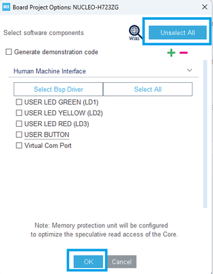

  3. Disable the BSP code generation as shown in figure 5:Figure 5 Disable BSP code generationFigure 5 Disable BSP code generation

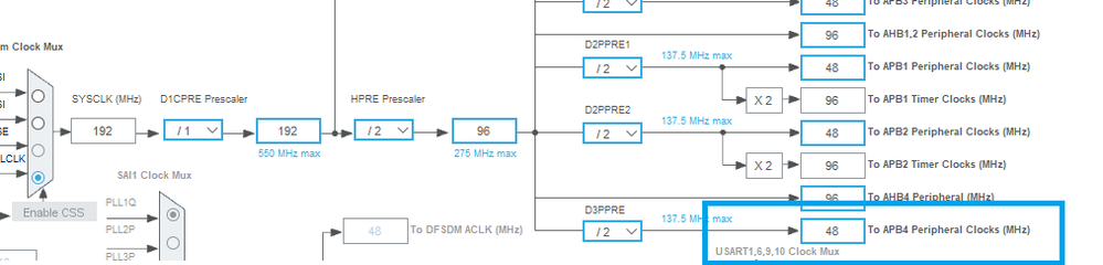

  5.  Check what’s the PCLK frequency value feeding DTS. In STM32H723, DTS is attached to APB4 bridge (refer to the reference manual of the product/ Section "Memory organization"). We need to look at APB4 frequency. Figure 7 shows that in this case the APB4 frequency is set at 48 MHzFigure 7. PCLK clockFigure 7. PCLK clock

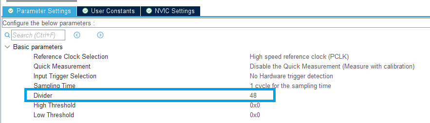

  6. The DTS is configured as described earlier in the article. The figure 8 shows the DTS configuration in STM32CubeMX:
  • Start the measurement using software.
  • The Reference clock is set to be clocked with the high-speed reference clock, which is PCLK.
  • Measurement with calibration is used. So, the quick measurement is disabled.
  • As stated in step 5, the APB4 clock = 48 MHz. Set the divider to 48 to let the DTS counter clock run at 1 MHz.
  • For the sampling time, we use 15 samples that are used to get the highest precision.
  • No thresholds are used in this example.
Figure 8. DTS configurationFigure 8. DTS configuration

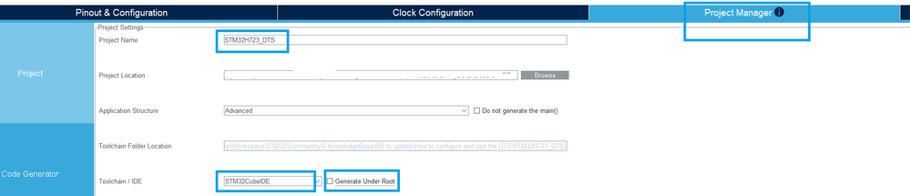

  1. As shown in figure 9, go to [Project Manager] tab, give a name to the project, for example STM32H723_DTS, select the toolchain [STM32CubeIDE] and uncheck the box [Generate Under Root]:Figure 9. Project configurationFigure 9. Project configuration

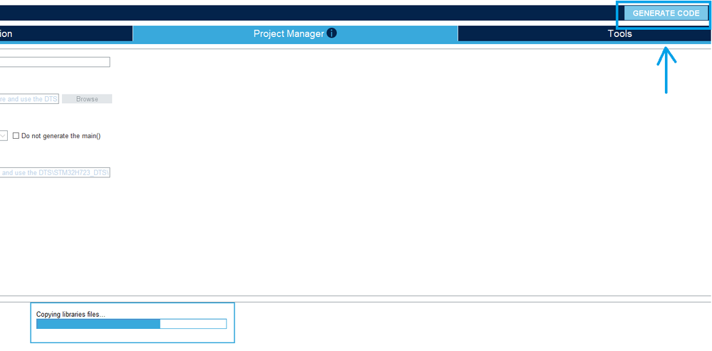

  2. Generate the project by clicking the [GENERATE CODE] button as shown in figure 10:Figure 10. Generate the projectFigure 10. Generate the project

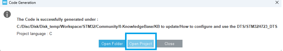

  3. Click [Open Project] in the window shown by figure 11:Figure 11. Opening the projectFigure 11. Opening the project

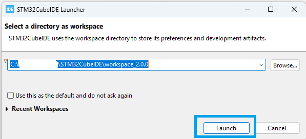

  4. Launch the project by clicking [Launch] button as shown in figure 12:Figure 12. Launch the project in STM32CubeIDEFigure 12. Launch the project in STM32CubeIDE

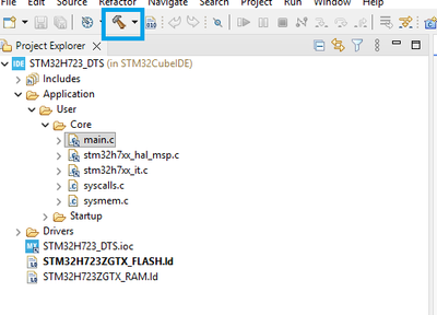

  6. Compile the project as shown in figure 13:Figure 13 Compile the projectFigure 13 Compile the project

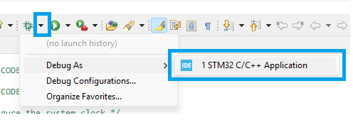

  7. Start a debug session as shown in figure 14:Figure 14 Start a debug sessionFigure 14 Start a debug session
