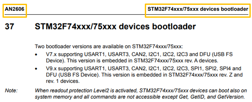

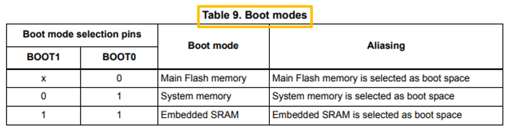

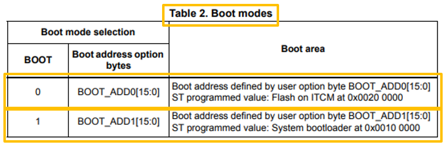

During your review, it’s important to check that the proper boot configuration is selected. We will take the STM32F746 as an example, the boot modes table for this specific device can be found in the reference manual. Using this table, we see that the configuration of the BOOT0 pin and the boot base address programmed in BOOT_ADD0 or BOOT_ADD1 will determine whether the device boots from internal flash or the system bootloader. If choosing to boot from the system bootloader, we would then need to reference AN2606 to review the list of supported peripherals that can be used to update the internal flash when booting from the system bootloader.
Each STM32 series is unique and may have different mappings for system memory, therefore it's always a good idea to double check that you are using the proper IOs for system memory. another point to consider, is that some STM32 devices may have a BOOT1 pin and fixed boot addresses. For example, the STM32F103 has both a BOOT0 and BOOT1 pin. These two pins' states combination will determine whether the STM32 boots from main flash memory, system memory or embedded SRAM. As a rule of thumb, always refer to your respective STM32 device's reference manual and corresponding AN2606 section for further details.

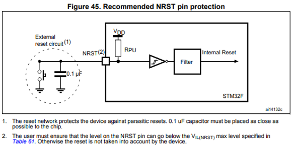

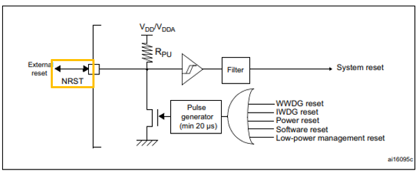

This is a simplified diagram of the reset circuit inside the STM32, however newer parts may have revised this internal circuit so always make sure to double check your STM32’s datasheet.
The NRST pin is a bidirectional pin; this means that you have the option of resetting the STM32 from an external source or this pin can also generate a result pulse output whenever there is an internal reset. With that in mind, here are some points to consider:

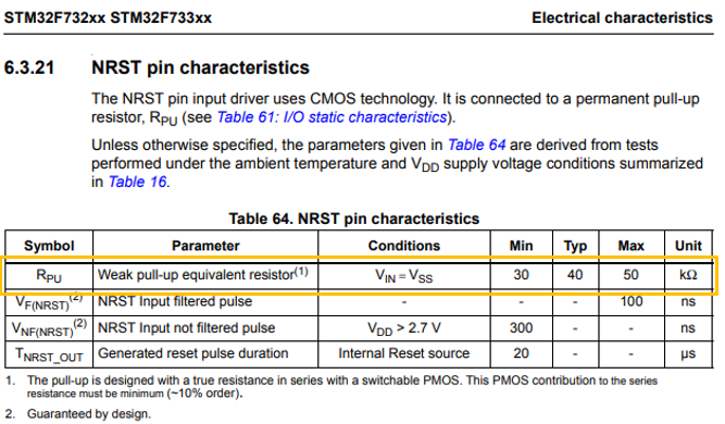

  • Typically, there is no need for an external pull-up resistor because there is already an internal pull-up resistor embedded. For resistor values, refer to the NRST pin characteristics table in your STM32’s datasheet.
  • If there is any reset pin drive, make sure that it is done in an open drain manner rather than push-pull due to internal reset sources. A somewhat common issue seen is that an external device or reset controller is configured as push-pull which leads to preventing the NRST from being asserted by the debugger or the STM32
  • The capacitance on the NRST pin should typically not exceed 0.1 uF. Too much capacitance will prevent the STM32 internally generated resets from pulling the line low enough to reset the part.

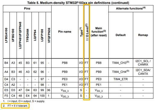

Start by locating the abbreviation used to indicate a pin’s 5V tolerance. This information may be present in the datasheet in the pin definition table as a footnote or separately in the legend and abbreviation table. Here, we see that FT stands for 5V tolerance. Looking at the pin definition table, there is an I/O level column that helps us in identifying if the pin is 5V tolerant.

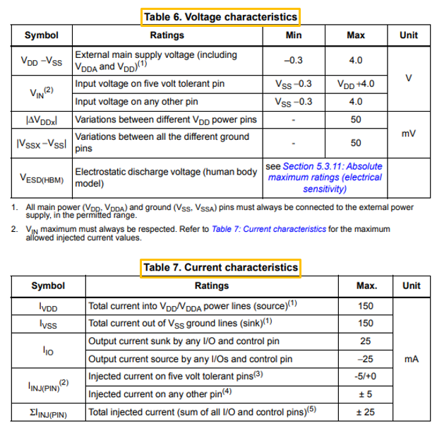

  • Make note of the absolute maximum rating tables available in the STM32’s datasheet, particularly the maximum voltage and current limits of each pin and overall microcontroller.
  • Configure the GPIO on the STM32 as open-drain and disable the internal pull-up/pull-down resistor present when interfacing with external 5V logic.
