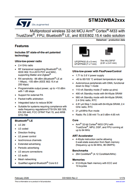

We always recommend checking the datasheet, which lists all supported Bluetooth features following the Bluetooth SIG’s guidelines. This applies, for example, to the STM32WB0, STM32WB, or STM32WBA.
Below is an example from DS15003, which is the datasheet for the STM32WBA2.
