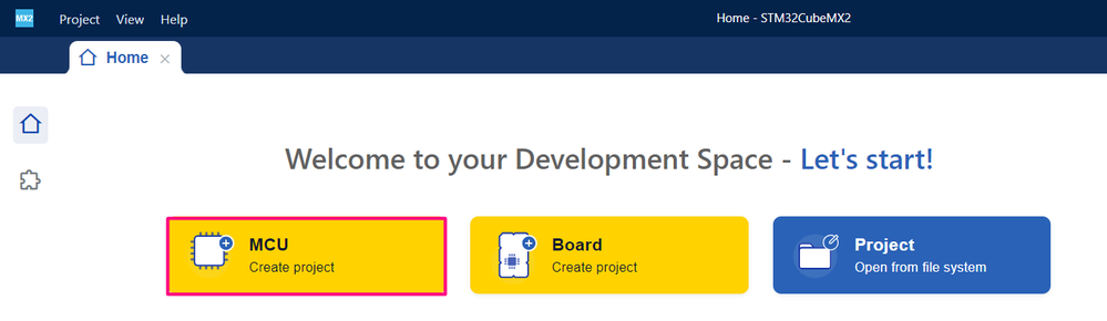

Open STM32CubeMX2. On the Home page, click the [MCU square] to create a new project.

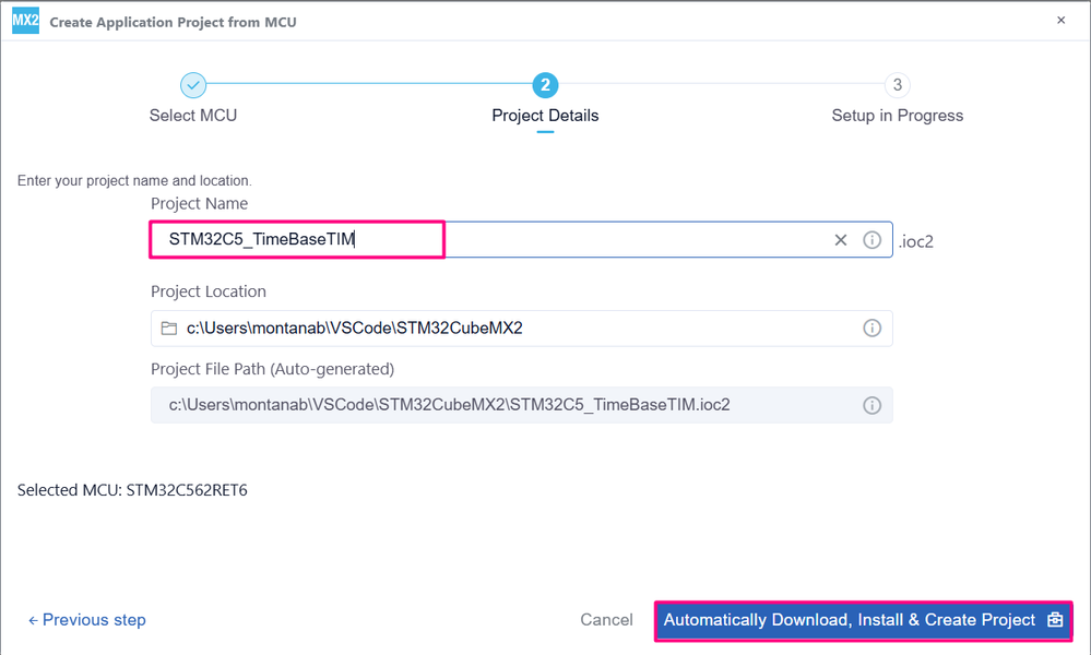

In the search field under MCU name, enter STM32C562RE and select your board. Click [Continue].
Enter your project name and location. Click [Automatically Download, Install & Create Project] to finish project creation.
Select [Launch Project] to start.

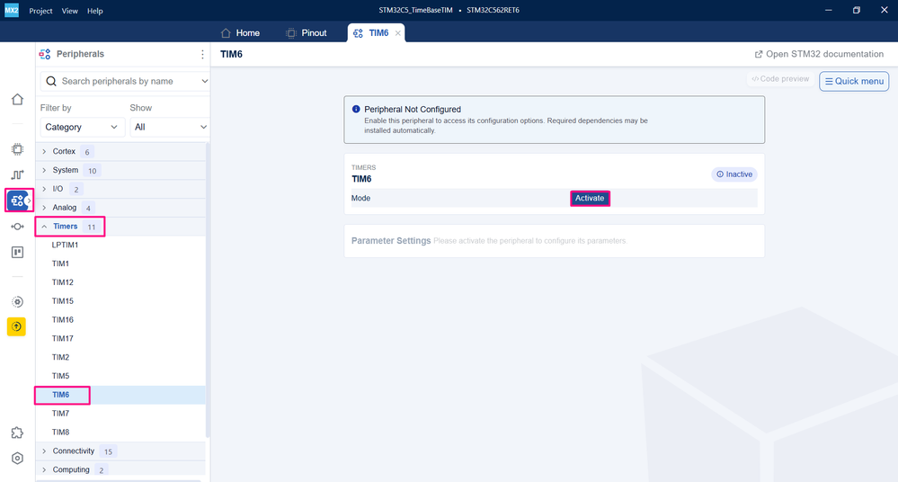

In the Peripherals tab, select Timers.
Select the timer that you want to use to replace SysTick and click [Activate]. For example, use TIM6.

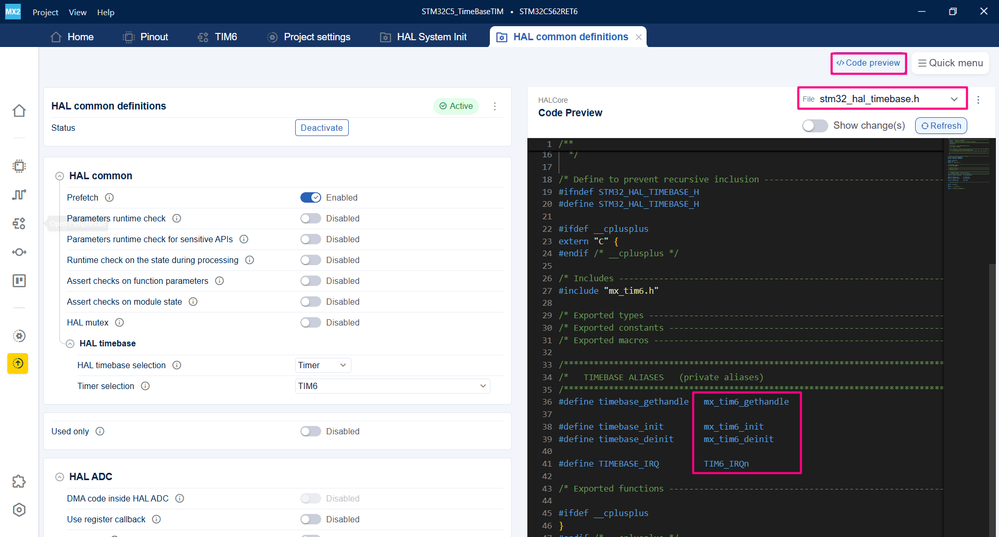

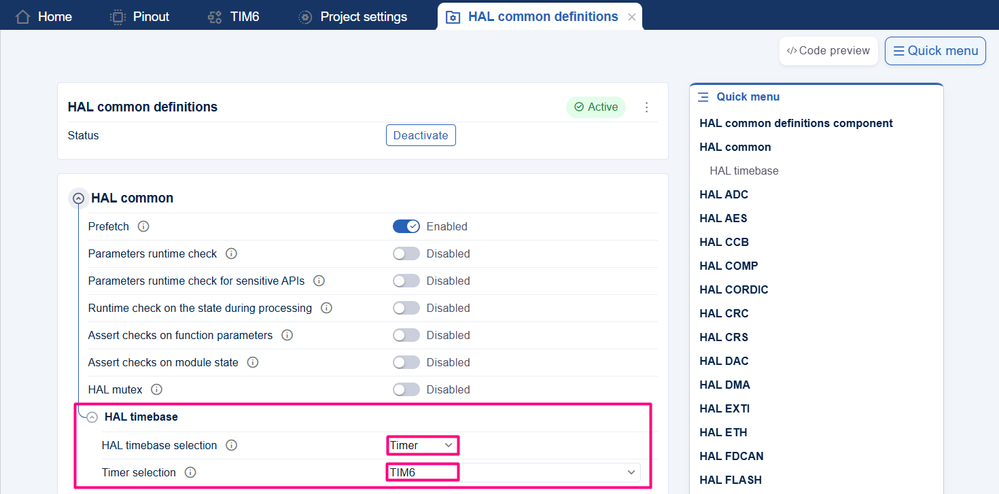

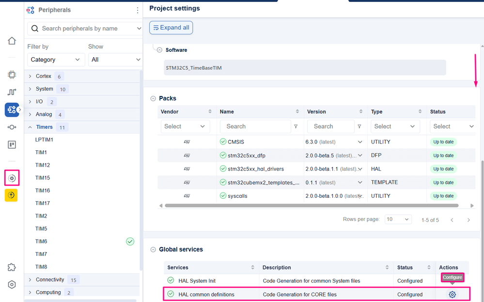

Go to the "Project Settings" tab, then scroll to the "HAL common definitions - Code Generation for Core" files.
In this section, select the resource you want to assign as the HAL timebase, in this case, TIM6.
It is also possible to check the generated code and the change on the stm32_hal_timebase.h to associate the time base with the selected TIM.

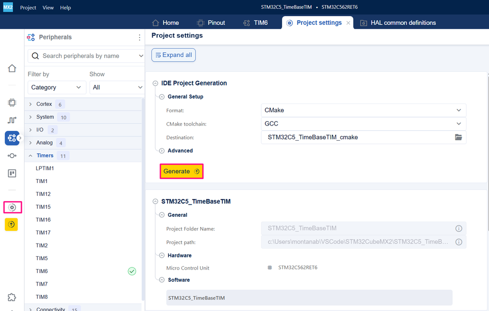

  1. Click on the [Project settings] icon and select the desired IDE.
  2. Click the [Generate] button.

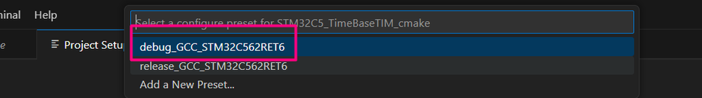

You are prompted with a selection. In case you miss click or that does not appear, press Ctrl+Shift+P, type CMake: Select Configure Preset, and choose your debug configuration.

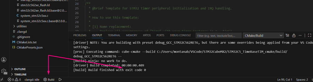

Build the project to ensure everything is set, then proceed to code implementation.

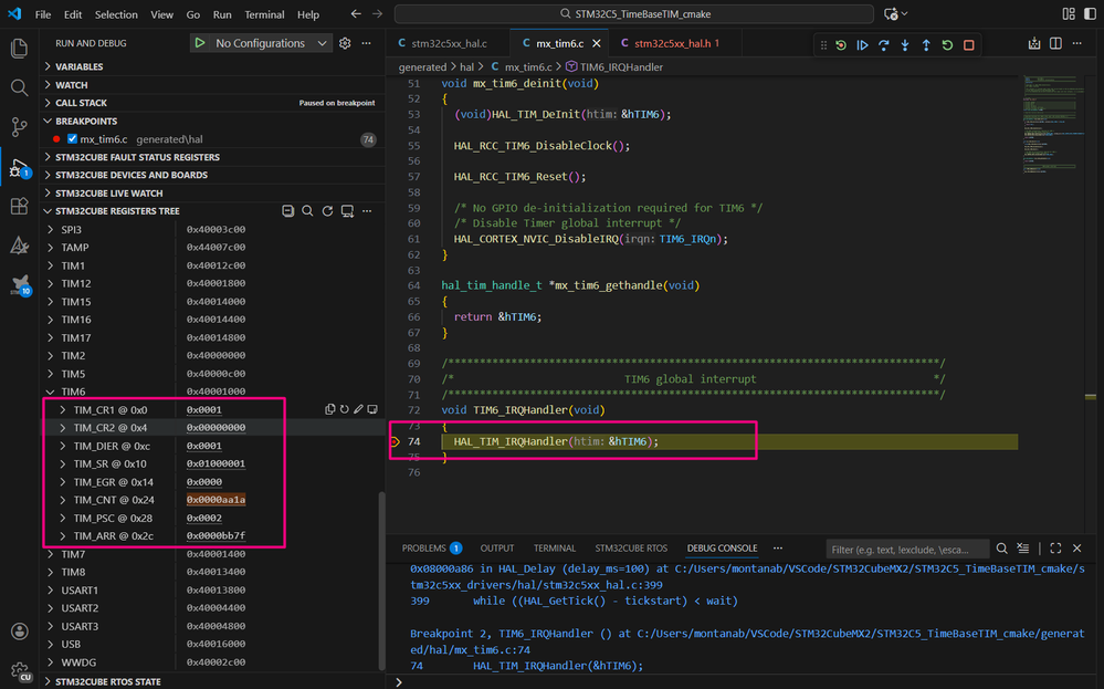

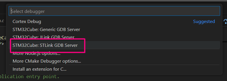

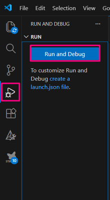

After building the application, locate the [Run and Debug] icon, create your debug session by selecting the STLINK GDB Server option:
It's possible to check the TIM6 register and callback to confirm the timebase change.

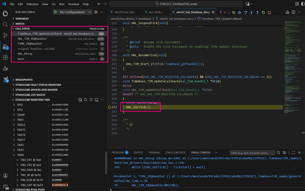

It's also possible to track the workflow via callstack.
Once SysTick is unassigned from the HAL timebase, you can freely use the SysTick as an RTOS kernel clock. The hardware abstraction layer driver does not interfere anymore. This approach prevents conflicts with other timers.
