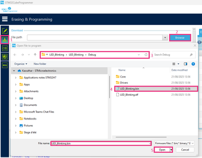

5. Download the extractable file attached at the bottom of the article and add the LED_Blinking.bin as shown in the figure below

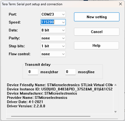

6. Open Tera Term and configure it to check the LED status

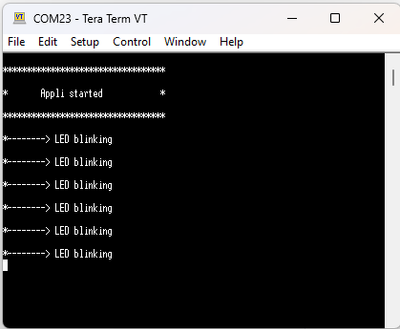

7. Remove the debugger link by removing CN2 ST-LINK jumpers on the Nucleo board, press the reset button, and we can see the led blinking and this message in Tera Term

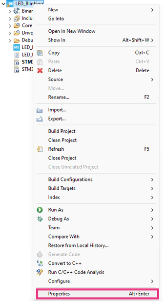

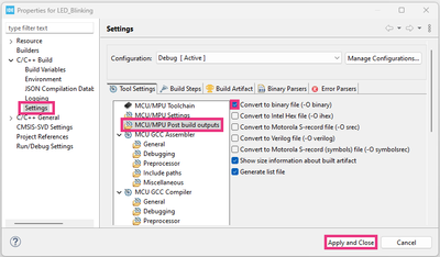

3. Right-click on LED_Blinking project to modify its properties
4. Select [Convert to binary file(-O binary)] to create a binary file as shown in the figure below

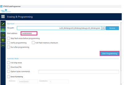

5. Add the new binary and click on [Start Programming] in STM32CubeProgrammer

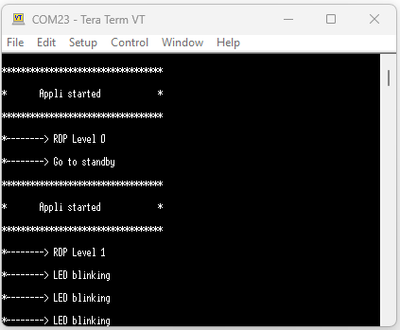

6. On Nucleo-L456RG, remove the debugger link CN2 ST-LINK jumper and press the reset button
You can see in the Tera Term that the RDP level is changing by transition to standby
