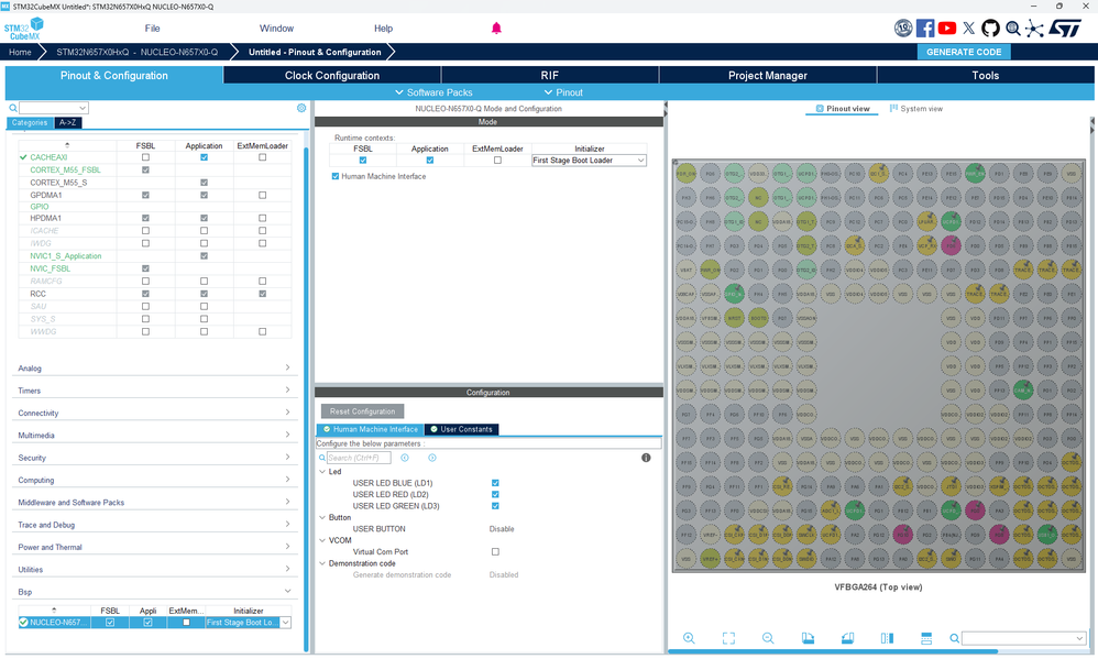

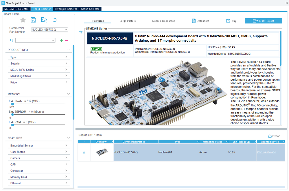

Begin your project by clicking Access to board selector and selecting NUCLEO-N657X0-Q, which corresponds to the STM32N6 Discovery kit board.
When asked to "Initialize all peripherals with their default Mode", click [No].
While some peripherals may be enabled by default, remove any that are unnecessary to avoid pin conflicts.
Select "Secure domain only" and click [OK]:
When prompted about board project options, you can select LD1, LD2, and LD3 as shown below:

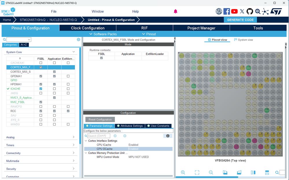

Navigate to "Pinout & Configuration."
3.2.1 System core

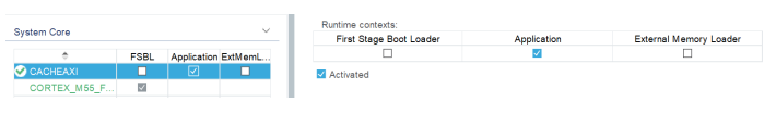

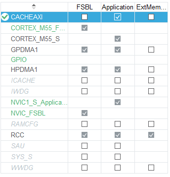

Enable the CPU ICACHE and CPU DCACHE.
Enable CACHEAXI.
Ensure that ICACHE is disabled.

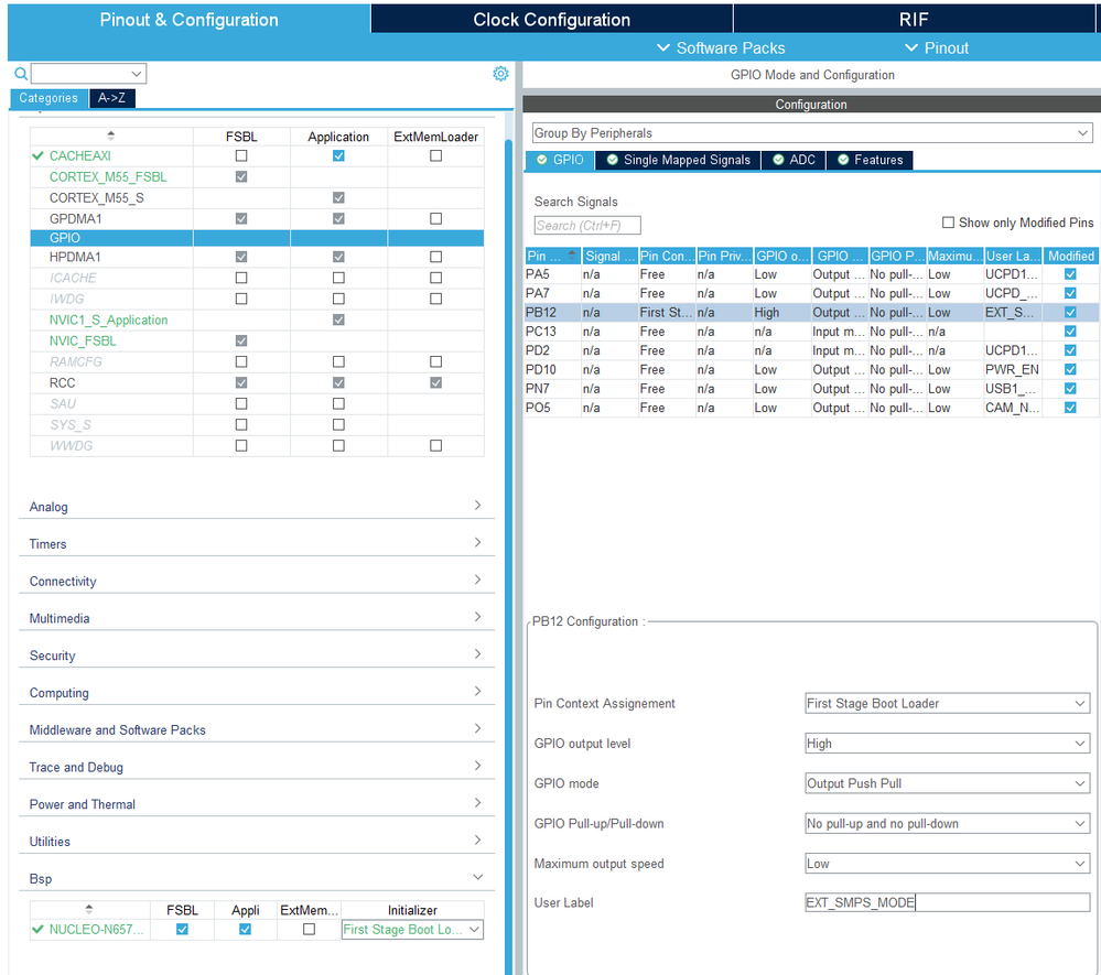

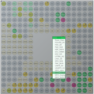

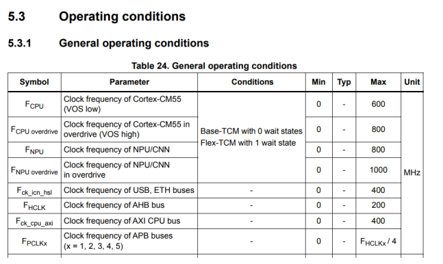

3.2.3 Overdrive mode
To enable overdrive mode, where the CPU operates at its maximum frequency (as shown below in the table from the STM32N6 datasheet), the EXT_SMPS_MODE pin must be configured. According to the NUCLEO-N657X0-Q user manual, this corresponds to pin PB12.
Therefore, pin PB12 has to be set as GPIO_Output:
And configured as follow in the GPIO menu:

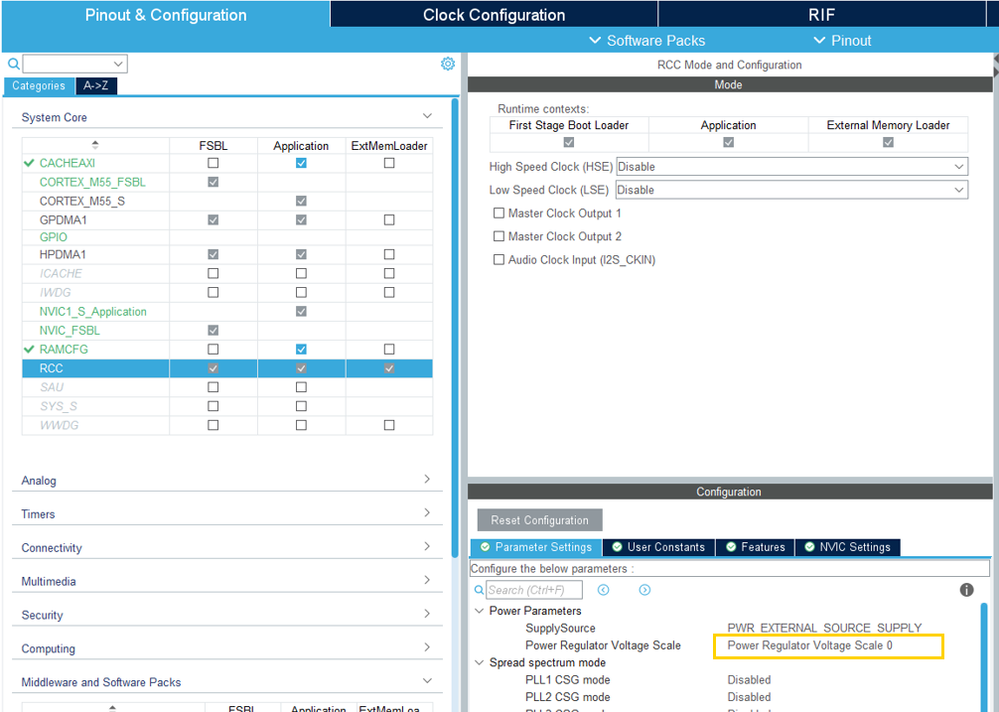

Additionally, the maximum CPU frequency in overdrive mode requires setting the "Power Regulator Voltage Scale" to "0." Ensure that this configuration is applied in the RCC section.
Since intermediate activations during inference are stored in RAM, enable the RAM controllers accordingly.

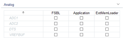

3.2.4 Analog
You can deactivate everything in this part to avoid potential conflict:

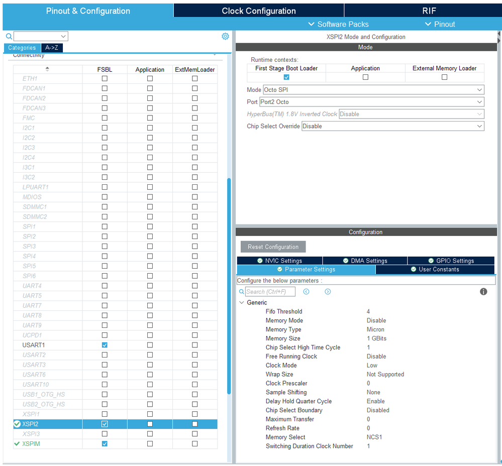

3.2.5.1 Configure serial communication with external memory

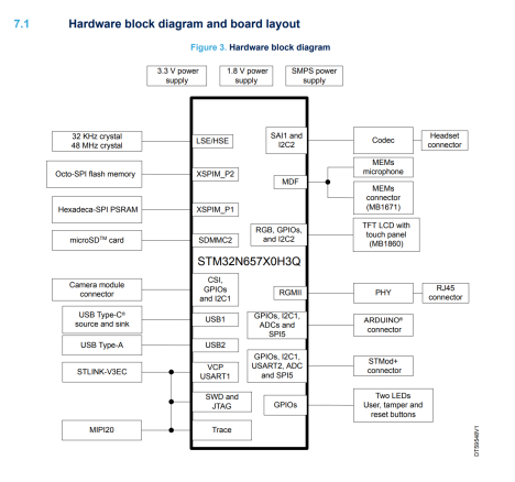

As shown in the image below from the NUCLEO-N657X0-Q user manual, the MCU is connected to the octo-SPI flash memory via the XSPI (extended-SPI) interface. Thus, XSPI2 is configured under the "Connectivity" section.

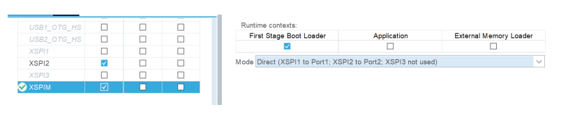

In XSPIM, select the operation mode as shown:
Then, configure XSPI2 as shown below:
  • Fifo threshold: 4
  • Memory Size: 1 GBits
  • Delay Hold Quarter Cycle: Enabled

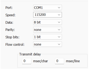

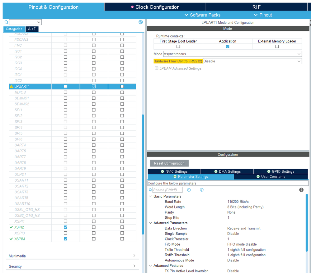

3.2.5.2 Configure serial communication for debugging

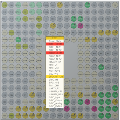

The serial interface LUSART1 (PE5/PE6), which supports the bootloader, is directly accessible as a Virtual COM port on the PC when connected via the STLINK-V3EC USB connector (CN6). We use this interface to redirect the ‘printf‘ output, enabling easy debugging through a serial terminal. Enable LUSART1 for the Application runtime context, set the mode to "Asynchronous", and configure the baud rate to 115200 bit/s
As you can see below, there is a conflict shown in orange. To fix it, change the pin PA11 to LUSART1_CTS:

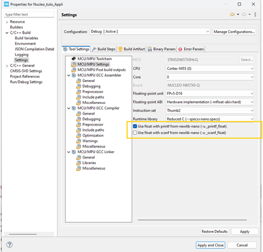

To redirect ‘printf‘, additional code needs to be added to your project. This is done later.

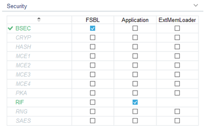

3.2.7 Security
To ensure boot security, enable "BSEC" for the FSBL. Additionally, since the NPU is used in the application, activate "RIF" for the Application. Check the boxes as shown below:

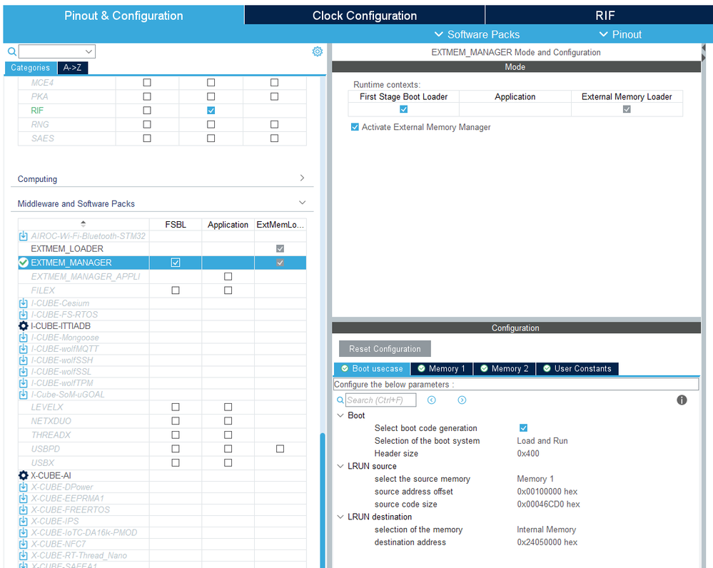

3.2.8.1 Configure external memory manager middleware
With the serial interface already configured, you can now set up the external memory loader. Start by selecting [Load and Run] under "Selection of Boot System". The remaining parameters depend on the size of the generated binaries.

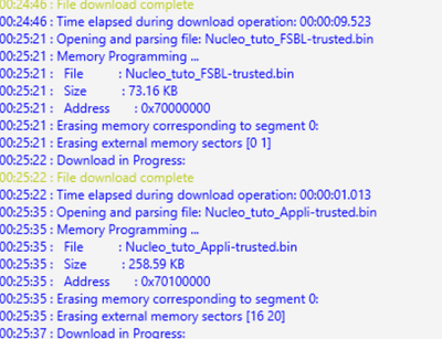

If you are unsure of the sizes, you can first generate the binaries using estimated values, then adjust the configuration accordingly and regenerate.
For this project, the FSBL binary is approximately 65 KB, and the Appli binary is around 295 KB. The board’s memory map is shown below.

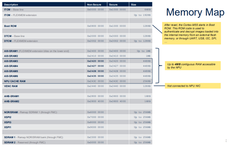

Note two key addresses in this map: the secure RAM block starts at address ‘0x34000000‘, and the octo-SPI flash (interfaced by XSPI2) starts at address ‘0x70000000‘.
Upon power-up, the boot ROM is executed first. After that, the FSBL (stored at the beginning of flash) is copied into RAM and executed. The FSBL then copies the Appli binary from flash to RAM and executes it. Thus, the FSBL binary is stored at ‘0x70000000‘.
The Appli binary should be placed at an address offset greater than the FSBL size. Choosing an offset of ‘0x00100000‘ (1 MB) provides ample space. The code size corresponds to the Appli binary size; ‘0x0004BAF0‘ (310 KB) offers a suitable margin.
By default, "Memory 1" is the source memory, corresponding to the XSPI2 interface. The destination address should be set to the start of the secure RAM block, where the Appli binary is loaded.

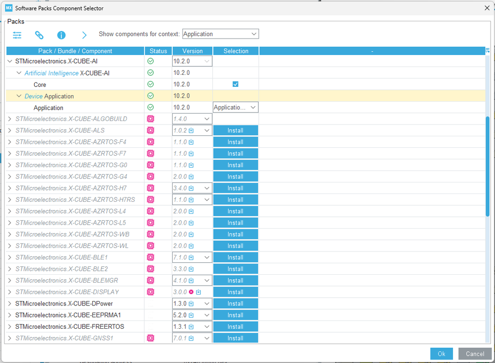

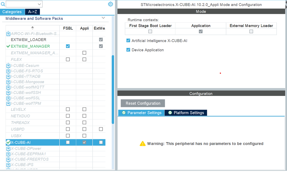

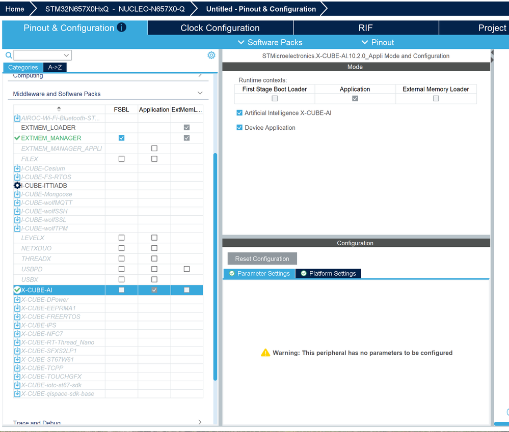

3.2.8.2 Configure the X-CUBE-AI middleware
The X-CUBE-AI middleware is used to generate application code for running neural network inferences. Enable it in the Application context and select "Application Template" as the application type.
When asked if you want to automatically fix peripherals and clocks, click [No].

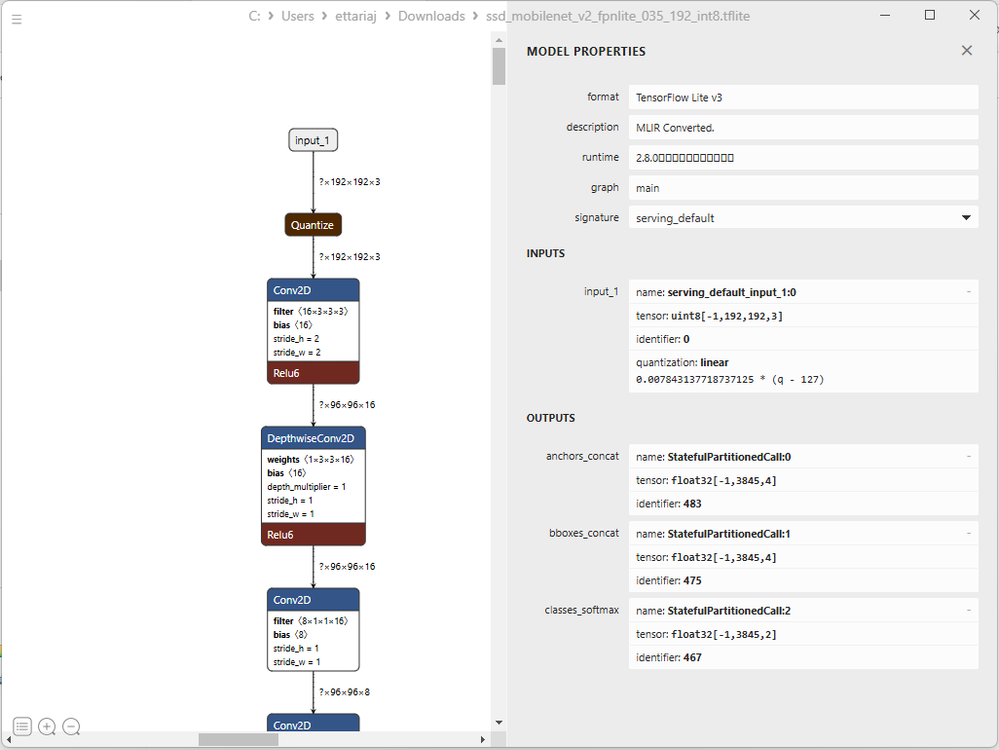

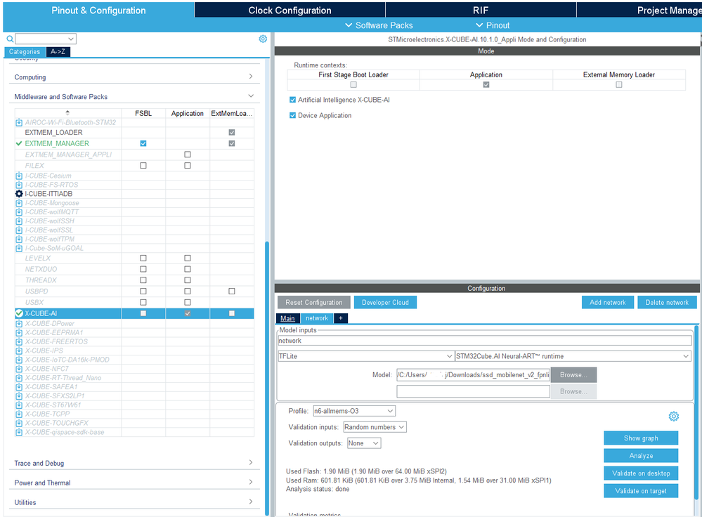

In this tutorial, the object detection model from the ST model zoo is used (link). Get the quantized .tflite model.
For your information: You can find script to retrain, deploy example application and much more for different use cases (image classification, object detection, audio detection etc.) on our GitHub model zoo services:
GitHub: AI model zoo services for STM32 devices

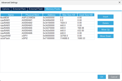

Select "TFLite" and browse for your model. Additionally, select the profile "n6-allmems-03" if not already used by default.
In the "Advanced Settings" (accessible via the blue icon above "Show Graph"), you can view the memory pool used by X-CUBE-AI. This pool stores the model’s fixed weights in flash and its activations in RAM. The OctoFlash pool begins at address ‘0x71000000‘, so after generating the model weights image, it should be downloaded to this address. The image generation process is explained later in this tutorial.

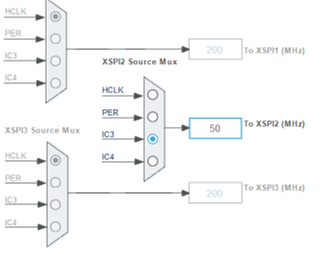

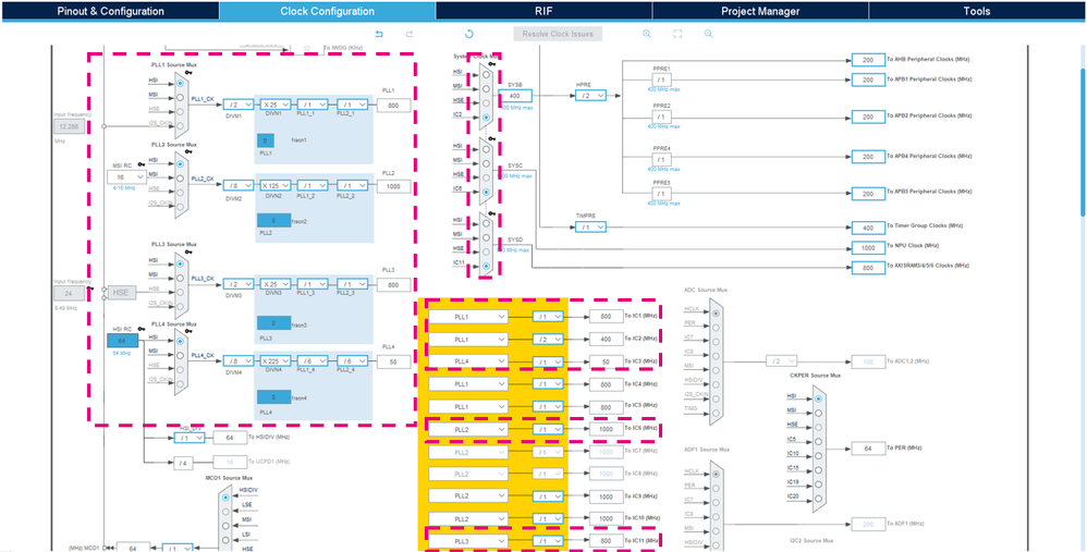

3.3 Configure the clocks
Configure the clock according to the maximum supported frequencies (shown earlier in the overdrive mode section).
High-speed OTP optimization is not enabled for XSPI. Therefore, the XSPI2 clock must be reduced. Configure IC3 with PLL4 as input and a prescaler of 1, then set IC3 as the input for the XSPI2 clock multiplexer. You should have this:
Finally, click on Resolve Clock Issues to solve the LPUART1 Source Mux issue.

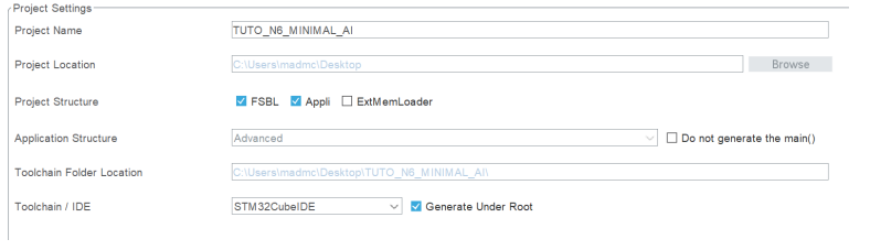

3.4 Project manager

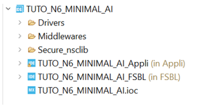

At this point, the CubeMX design and configuration are complete. In the "Project Manager" section, click [Generate Code] to export your project. Ensure that both FSBL and Appli are included and select STM32CubeIDE as the target toolchain.
4. STM32CubeIDE
After exporting your project from CubeMX, you will have the following structure. There are two nested projects: one for the FSBL and one for the Appli. The "Drivers" folder, which includes CMSIS and HAL drivers, is located outside the global project, and both nested projects access it by including the appropriate headers. The same applies to the ‘Middlewares‘ folder.

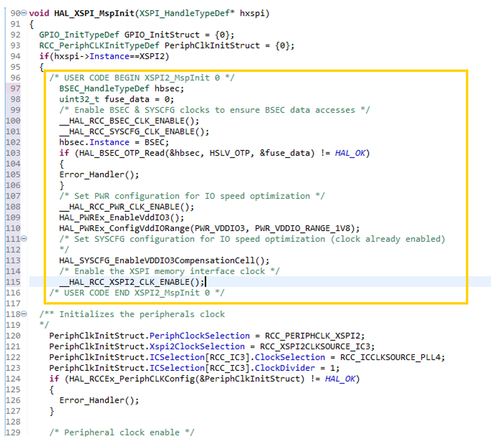

4.1 Add code in the FSBL

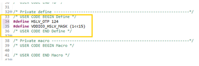

First of all, you should complement BSEC initialization. First, add the following constants into the private define area of stm32n6xx_hal_msp.c
#define HSLV_OTP 124
#define VDDIO3_HSLV_MASK (1<<15)
Then proceed to add the following piece of code into the HAL_XSPI_MspInit function.
BSEC_HandleTypeDef hbsec;
uint32_t fuse_data = 0;
/* Enable BSEC & SYSCFG clocks to ensure BSEC data accesses */
__HAL_RCC_BSEC_CLK_ENABLE();
__HAL_RCC_SYSCFG_CLK_ENABLE();
hbsec.Instance = BSEC;
if (HAL_BSEC_OTP_Read(&hbsec, HSLV_OTP, &fuse_data) != HAL_OK)
Error_Handler();
/* Set PWR configuration for IO speed optimization */
__HAL_RCC_PWR_CLK_ENABLE();
HAL_PWREx_EnableVddIO3();
HAL_PWREx_ConfigVddIORange(PWR_VDDIO3, PWR_VDDIO_RANGE_1V8);
/* Set SYSCFG configuration for IO speed optimization (clock already enabled)
HAL_SYSCFG_EnableVDDIO3CompensationCell();
/* Enable the XSPI memory interface clock */
__HAL_RCC_XSPI2_CLK_ENABLE();

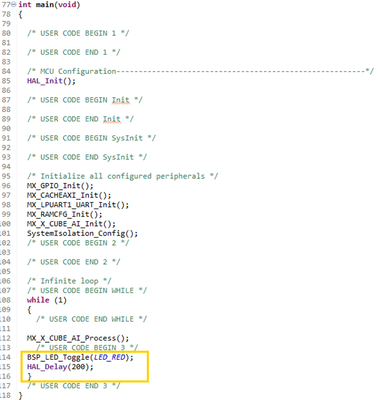

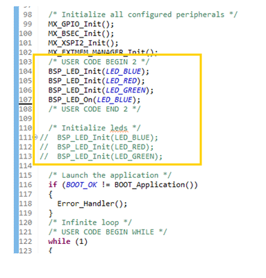

Now, you should add some code into the main functions of each project to use the LEDs to flag good execution. In the FSBL, to turn on the blue LED add functions call accordingly to the following image. Note that the initialization added by STM32CubeMX was commented out and this same piece of code was added under the User Area Code 2. This was done because the function to turn the LED blue on has to be called before booting the application. This is the only User Area Code available for such a purpose. Be aware that the section commented out may uncomment itself after STM32CubeMX modifications so be sure to comment it before rebuilding.
In FSBL main.c:
BSP_LED_Init(LED_BLUE);
BSP_LED_Init(LED_RED);
BSP_LED_Init(LED_GREEN);
BSP_LED_On(LED_BLUE);

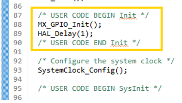

Moreover, the Overdrive mode selection pin must be high before configuring the clock. Make sure to add the GPIO init function before the system clock initialization, as shown in the image below.
MX_GPIO_Init();
HAL_Delay(1);

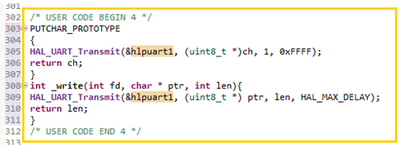

Next, go to the Appli project. At the top of ‘main.c‘, in the private define section, declare the following macro for the ‘put_char‘ function.
#define PUTCHAR_PROTOTYPE int __io_putchar(int ch)
Then, in the ‘User Code 4‘ section at the bottom of ‘main.c‘, implement the following functions:
PUTCHAR_PROTOTYPE
HAL_UART_Transmit(&hlpuart1, (uint8_t *)ch, 1, 0xFFFF);
return ch;
int _write(int fd, char * ptr, int len){
HAL_UART_Transmit(&hlpuart1, (uint8_t *) ptr, len, HAL_MAX_DELAY);
return len;

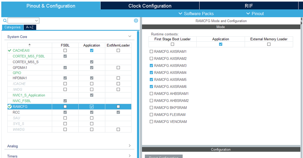

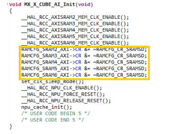

Within ‘main.c‘, in the X-CUBE-AI initialization function, add the following lines (if not already present) to enable the RAM sections that were previously initialized and enabled:
RAMCFG_SRAM2_AXI->CR &= ~RAMCFG_CR_SRAMSD;
RAMCFG_SRAM3_AXI->CR &= ~RAMCFG_CR_SRAMSD;
RAMCFG_SRAM4_AXI->CR &= ~RAMCFG_CR_SRAMSD;
RAMCFG_SRAM5_AXI->CR &= ~RAMCFG_CR_SRAMSD;
RAMCFG_SRAM6_AXI->CR &= ~RAMCFG_CR_SRAMSD;
Important note: Depending on the version of CubeMX, X-CUBE-AI, and the STM32N6Cube package, you may have different things in this MX_X_CubeAI_Init() function. Edit it if needed to have exactly what is in the image above.

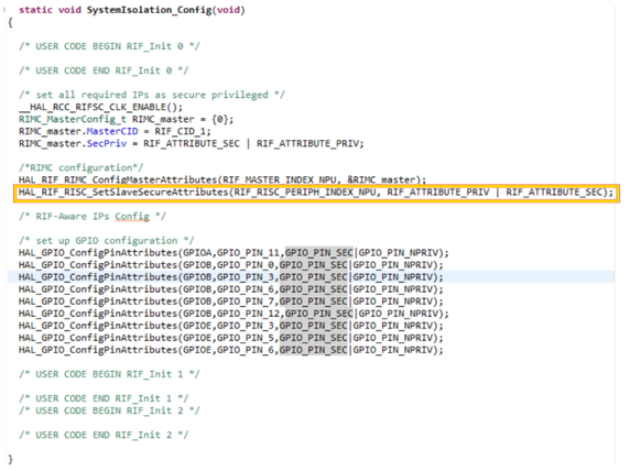

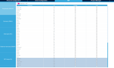

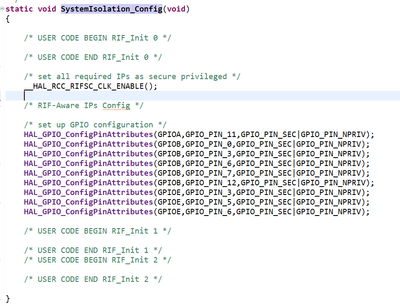

Add the following line to the RIF (SystemIsolation_Config) function to complete the slave configuration:
HAL_RIF_RISC_SetSlaveSecureAttributes(RIF_RISC_PERIPH_INDEX_NPU, RIF_ATTRIBUTE_PRIV | RIF_ATTRIBUTE_SEC);
Important note 2: Make sure that the part of the code above the line we add is present in the generated code. If not, it may indicate an issue in the RIF configuration. Make sure to look back at the Security configuration in CubeMX and that the NPU is selected in the RIF tab of CubeMX.

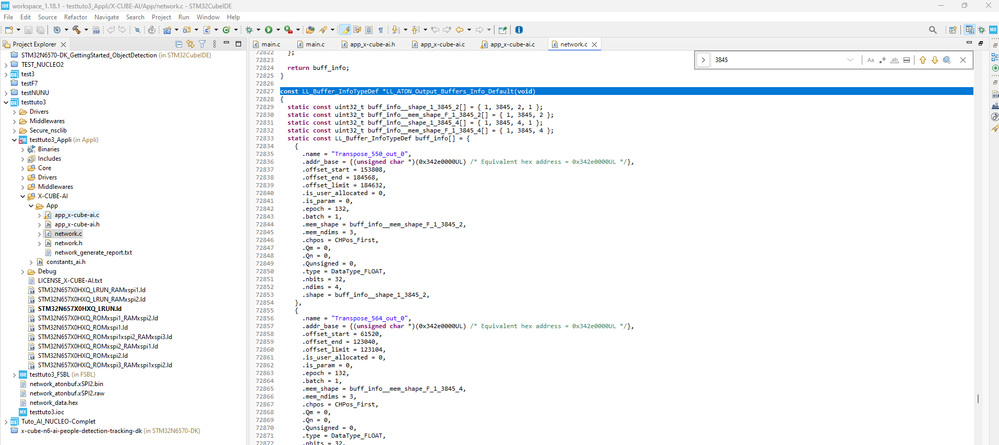

Finally, you need to handle the input and output buffers to feed your neural network and retrieve the inferred results. Since both the NPU and MCU have their own cache memories, these must be properly managed before invoking the low-level inference function. This is to ensure that both units access up-to-date data in memory and that any results are stored in a mutually accessible region. Therefore, you must perform a cache clean and invalidate operations.
The ‘MX_X_CUBE_AI_Process‘ function below implements the following features:
  • Calculating buffer sizes.
  • Filling the input buffer with constant values.
  • Cleaning and invalidating the MCU DCACHE and invalidating the NPU cache prior to inference.
  • Converting integer table values to float and printing them via UART.
The last functionality is implemented because memory is always allocated as an int table, but for this model, the output format is float. An int is 8 bits, and a float is 32 bits. Therefore, reading a single element from the array does not yield 19 valid values. Instead, four consecutive 8-bit values must be concatenated and interpreted as a single 32-bit float. You can copy the ‘MX_X_CUBE_AI_Process‘ function from the script below. After pasting it, press [Ctrl+I] to autoindent the code properly.
// Initialize the two following variables at the begining of the file
uint32_t buff_in_len, buff_out_len;
void MX_X_CUBE_AI_Process(void)
    /* USER CODE BEGIN 6 */

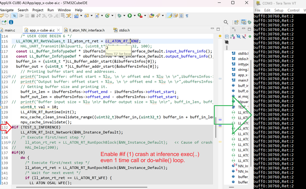

	LL_ATON_RT_RetValues_t ll_aton_rt_ret = LL_ATON_RT_DONE;
	const LL_Buffer_InfoTypeDef * ibuffersInfos = NN_Interface_Default.input_buffers_info();
	const LL_Buffer_InfoTypeDef * obuffersInfos = NN_Interface_Default.output_buffers_info();
	buffer_in = (uint8_t *)LL_Buffer_addr_start(&ibuffersInfos[0]);
	buffer_out = (uint8_t *)LL_Buffer_addr_start(&obuffersInfos[0]);

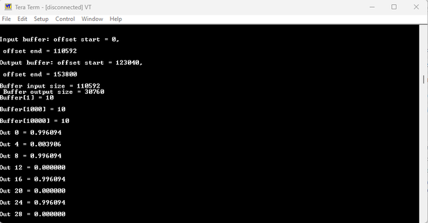

	// Printing buffer start and end addresses.
	printf("Input buffer: offset start = %lu, \n \r offset end = %lu \n \r",ibuffersInfos->offset_start,ibuffersInfos->offset_end);
	printf("Output buffer: offset start = %lu, \n \r offset end = %lu \n \r",obuffersInfos->offset_start,obuffersInfos->offset_end);
	// Getting buffer size and printing it.
	buff_in_len = ibuffersInfos->offset_end - ibuffersInfos->offset_start;
	buff_out_len = obuffersInfos->offset_end - obuffersInfos->offset_start;
	printf("Buffer input size = %lu \n\r Buffer output size = %lu \n\r", buff_in_len, buff_out_len);
	uint8_t val = 10;
	LL_ATON_RT_RuntimeInit();
	// Run 10 inferences
	for (int inferenceNb = 0; inferenceNb < 10; ++inferenceNb) {
		/* - Inference - */
		/* Pre-process and fill the input buffer */
		// Fill input buffer with constant data.
		for(uint32_t i = 0; i < buff_in_len; i++){
			buffer_in[i] = val;
		// Clean and invalidate MCU DCache and invalidate NPU cache.
		mcu_cache_clean_invalidate_range(buffer_in, buffer_in + buff_in_len);
		npu_cache_invalidate();
		// Check that input buffer was properly assigned with "val".
		printf("Buffer[1] = %d \n \r", buffer_in[1]);
		printf("Buffer[1000] = %d \n \r", buffer_in[1000]);
		printf("Buffer[10000] = %d \n \r", buffer_in[10000]);
		//_pre_process(buffer_in);
		/* Perform the inference */
		LL_ATON_RT_Init_Network(&NN_Instance_Default); // Initialize network instance

You most likely have to enable use float with printf as shown below:
This model has a 3-dimensional output buffer. To validate the output, only the first dimension is used in this example. Configure a serial terminal, such as Tera Term, with the settings shown in the image below. You are able to observe all the output buffer values.
You can use the Python script provided in the annex (provided at the end of this article). This is used to compare whether the quantized and optimized model running on your MCU produces the same outputs as the original model running on your PC.
To ensure that the application was correctly copied, that the peripheral initialization succeeded, and that the main loop is not stuck during inference, add the following two lines of code to blink the red LED:
 BSP_LED_Toggle(LED_RED);
 HAL_Delay(200);

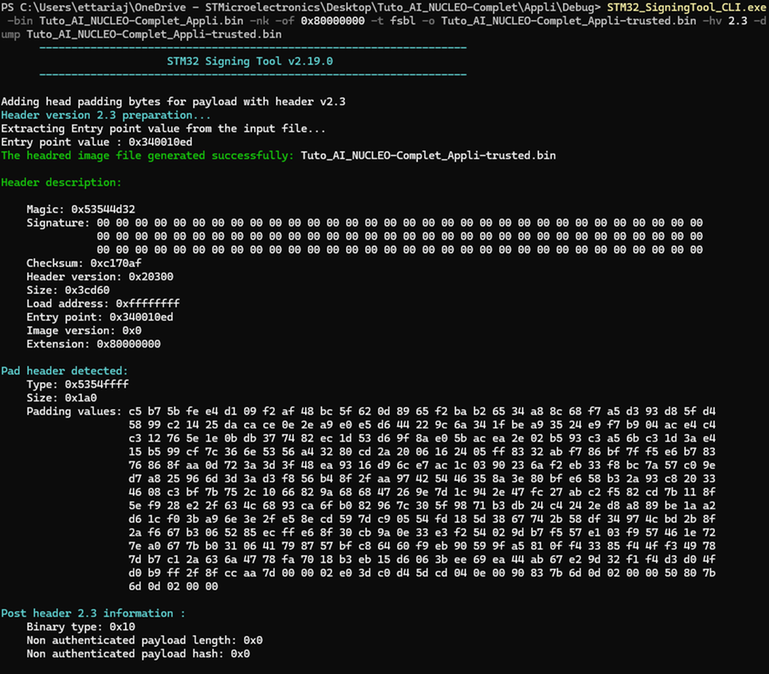

5.1 Sign binary files with Signing Tool
Embedded systems that implement security features such as TrustZone®, as in the STM32N6, require firmware authentication. The STM32-SignTool is a key utility that ensures a secure platform by signing binary images using ECC keys. These signed binaries are used during the STM32 secure boot process to establish a trusted boot chain. This process ensures authentication and integrity checks of the loaded images.
In short, you must sign the generated binaries before flashing them to the N6.
The Signing Tool executable is located in your STM32CubeProgrammer installation directory (by default: C:/Program Files/STMicroelectronics/STM32Cube/STM32Cube Programmer/bin). To run the commands shown below, you can add the ‘bin‘ folder to your environment variables so that you can execute them from any directory.
Otherwise, run the command directly from the bin folder, specifying the full path to the binary file. Starting from STM32CubeProgrammer version 2.21.0, a new parameter is needed at the end "-align". Please make sure you use the updated command, as follows:
STM32_SigningTool_CLI.exe -bin <your_project>.bin -nk -of 0x80000000 -t fsbl -o <your_project>-trusted.bin -hv 2.3 -dump <your_project>-trusted.bin -align
In our case, you want to sign two files:
  • Your_Project_Folder/FSBL/Debug/<Your_Project_Name>_FSBL.bin
  • Your_Project_Folder/Appli/Debug/<Your_Project_Name>_Appli.bin
And you should end up with 2 new files:
  • <Your_Project_Name>_FSBL-trusted.bin
  • <Your_Project_Name>_Appli-trusted.bin
For reference, the terminal output should look like:

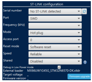

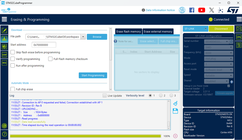

5.3 Flash binaries with STM32CubeProgrammer
We now have all three image files: the FSBL, the application, and the model weights.
Open STM32CubeProgrammer and ensure that your ST-LINK configuration matches the image below and confirm that the firmware is up to date.

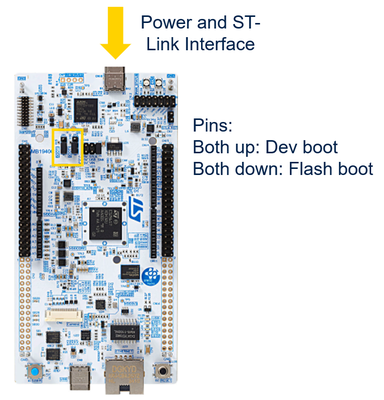

Set your NUCLEO-N657X0-Q board to development boot mode (Boot1 and Boot2 to the right) and click [Connect] in STM32CubeProgrammer.
Boot switches on the Nucleo board:
On the image, the board boots from flash mode.

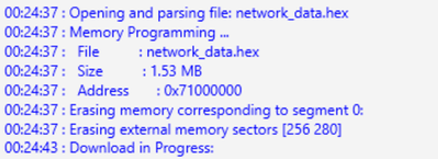

FSBL and application are binary files, and their flashing addresses must be specified manually.
  • Flash FSBL to the start of OctoFlash at ‘0x70000000‘.
  • Flash the application to ‘0x70100000‘, based on the offset defined in the external memory loader.
  • The weights image is a ‘.hex‘ file with a predefined address (‘0x71000000‘), specified in the ‘objcopy‘ command.
For example:
To flash the images:
  1. Put the board into development boot mode by sliding both BOOT switches to the right.
  2. Flash all binary and hex images.
  3. After flashing, switch the board to flash boot mode. Now, both switches to the left.
  4. Power-cycle or reset the board.
At boot, the boot ROM loads the FSBL from flash to internal RAM. The FSBL then loads the application from flash and executes it.

The input size and output size can be understood by opening the model.tflite file that was downloaded earlier.
Tool: Netron
X-CUBE-AI allocates both input and output buffers as INT8 tables. For the model used in this tutorial, the input buffer data type is INT8, therefore the memory size allocated corresponds directly to its dimensions (192x192x3 = 110592 bytes).
However, the output buffers data type is FLOAT32, which means the memory size allocated is four times greater. So, for example, for the third output buffer on Netron, which is the first one you see on LL_aton_buffers_output_info whose dimensions are (3875,2), 3875x2x4 = 30700 bytes were allocated. Then, as you can see on MX_CUBE_Ai_Process, the output buffer INT8 values must be "cast" to FLOAT32. Therefore, we use a float pointer to point at the beginning of an INT8 table of length 4.
In the serial terminal, only this output buffer used as the example was printed out, as well as in the Python script.
By opening the network.c file in Appli/X-Cube-AI/App, you can find information about the outputs of the model generated by X-CUBE-AI:
In the function LL_Buffer_InfoTypeDef *LL_ATON_Output_Buffers_Info_Default, the three outputs are listed in order, and the first one corresponds to the size 3845 * 2 (so the last one in netron).

By default, "memory 1" is the source memory corresponding to the XSPI2 interface. The destination address must be set as the beginning of the secure RAM block from which the Application binary is loaded.
Based on this, if I enabled AXIRAM3,4,5,6 in RAMCFG, should I set the LRUN destination address of EXTMEM_MANAGER to 0x34200000?
Julian E.
@nhwzzang,
If you enable AXIRAM3,4,5,6 in RAMCFG, and you want the application to be loaded into AXIRAM3, then yes, you should set the LRUN destination address of EXTMEM_MANAGER to 0x34200000, which is the start address of AXIRAM3.
Have a good day,
Julian

However, as I followed the example, I faced multiple issues.
  1. When I generate the code from CubeMX, the SystemIsolation_Config only have the pin attributes setup and it is missing code.  I have tried to select the NPU in the RIF tab but can not. I have tried your iloc file as well I made my own based on the tutorial instruction and I faced the same issue. I have attached images below. If you could explain why, it will be helpful for me.
  3. I have also tried writing commenting the AI code , so that in the while(1) I can toggle LEDS. I have generated the bin files and the hex data for the model weights. However, it seems to me that the board does not leave the FSBL stage. The LED is not blinking. I have also tried to mass erase the excterbal memory in the STM32 programmer but I could not because it is secured by a memory protection unit. YousefDessouki_2-1761000158162.pngYousefDessouki_3-1761000169314.png
I am new to STM32 world and this is my first STM32 board and thistutorial was very helpful. However, If any clarification regarding this matter will be greatly appreciated.

Nice tutorial @Julian E. , i experienced the same issue as @YousefDessouki

I have had probably the same issue like you when programming the NPU in the nucelo board. I will share with my experience as well as the binary files in a github repo so you can test it.
My main issue was in the external memory mangement unit. in the CubeMx, you should use 0x34000000 as the destination of the source code ,not 0x24050000 as in the tutorial images. Also RIF_Isolation function do not edit it. As for the selection of the NPU in the RIF config tab, this is not an issue. Your main issue is probbaly in the CubeMx ioc files. Make sure to use STM32N6 MCU package version v1.1.1 . You can download it from the CUbeMx itself and make sure to force use it when generating the code.
Below is the github repo link, the binary files u will find them in the debug folder of each of Appli and the FSBL. You will also find the .hex file for the weights. Try using the binary files on the STM32programmer initially.
https://github.com/YousefDessouki/STM32_N6_NuceloBoardwithNPU.git
Let me know if there is any issue :)

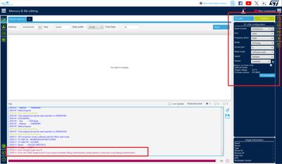

Hi Julian E., thank you very much for your document. I encountered a problem when connecting the device: when my computer is connected to the development board, STM32CUBEPROGRAMMER can find the device, but the connection fails. Please help explain the root cause of the problem and how to solve it.
alucart
Associate
Hi Julie E.
Thanks for step by step posting,
I did follow example until can interact both FSBL-Appli core blink difference colors LED.
But need a by pass MX_X_CUBE_AI_Process(); in Appli.
Because if I let it fully run on MX_X_CUBE_AI_Process(void) it will crash at capture screen.
add (My manual printf uart1)
snprintf
(ai_msg, sizeof(ai_msg),"buffO:%lu,Ret:%ld \r\n",buff_out_len,ll_aton_rt_ret);
HAL_UART_Transmit(&hlpuart1, (uint8_t*)ai_msg, 32, 100);
run 10 inferences
I think probably at line.
ll_aton_rt_ret = LL_ATON_RT_RunEpochBlock(&NN_Instance_Default);
Because it stuck while loop and run away..
Do you have any suggest? Thank you

During the configuration of x-cube-ai software pack, I don't see the "developer cloud" tab where I must add and configure the model. Anyone else who has this problem?n6_cube_ai.png
jmeck
Associate II
Under Step 3.2.8.2, The CONFIGURATION block shows no configuration:  Instead just a warning: This peripheral has no parameters to be configured?  Screenshot 2026-03-03 152310.png
Julian E.
Hi @jmeck@ksharma,
I assume you use the latest version of X Cube AI... I will share this bug but I don't think we will fix it.
X Cube AI is no longer supported, we recently released STM32Cube AI Studio instead:
Meet STM32Cube AI Studio, the new go-to tool for e... - STMicroelectronics Community
I pushed internally to have more tutorials, we are working on it.
Have a good day,
Julian
jmeck
Associate II
Understood.  I also get errors with STM32Cube AI Studio; to be addressed in a separate topic post.
Thanks for the response!
Rafał
Associate
I just solved issue with CubeMX X-Cube-AI. I'm sharing it for people who like me need to have compatibilty:
1. Make sure you have env path to "C:\ST\STEdgeAI\4.0\Utilities\windows" (or location where you have that) FIRST!!! If not, add it, restart system.
2. Remove stEdgeAI from c:/St/STEdgeAI, I used maintenancetool.exe to remove all (I know, "why we set env path?" - for "windows reason")
3. Now go to CubeMX and get first possible board project, I used nucleo N6 like in this article, initialize with secure domain only proceed.
4. Now in CubeMX I jumped straight to middleware and X-CUBE-AI selection, when you select that, after confirm, you should get downloading window for stedgeai-10.2 - great you're on good path, if not, restart pc and try again, if not, remove all x-cube-ai and n6 fw from cubemx and install again newest versions (older you can add later)
5. now you should see all parameters for X-Cube-AI
6. Time to fix stedgeai-core - simply install again (I choose version 4.0 only) and becasue you already have "path", STM32Cube AI Studio should work now too... not for me ofc - I have clock issues, but I will look at that later.
