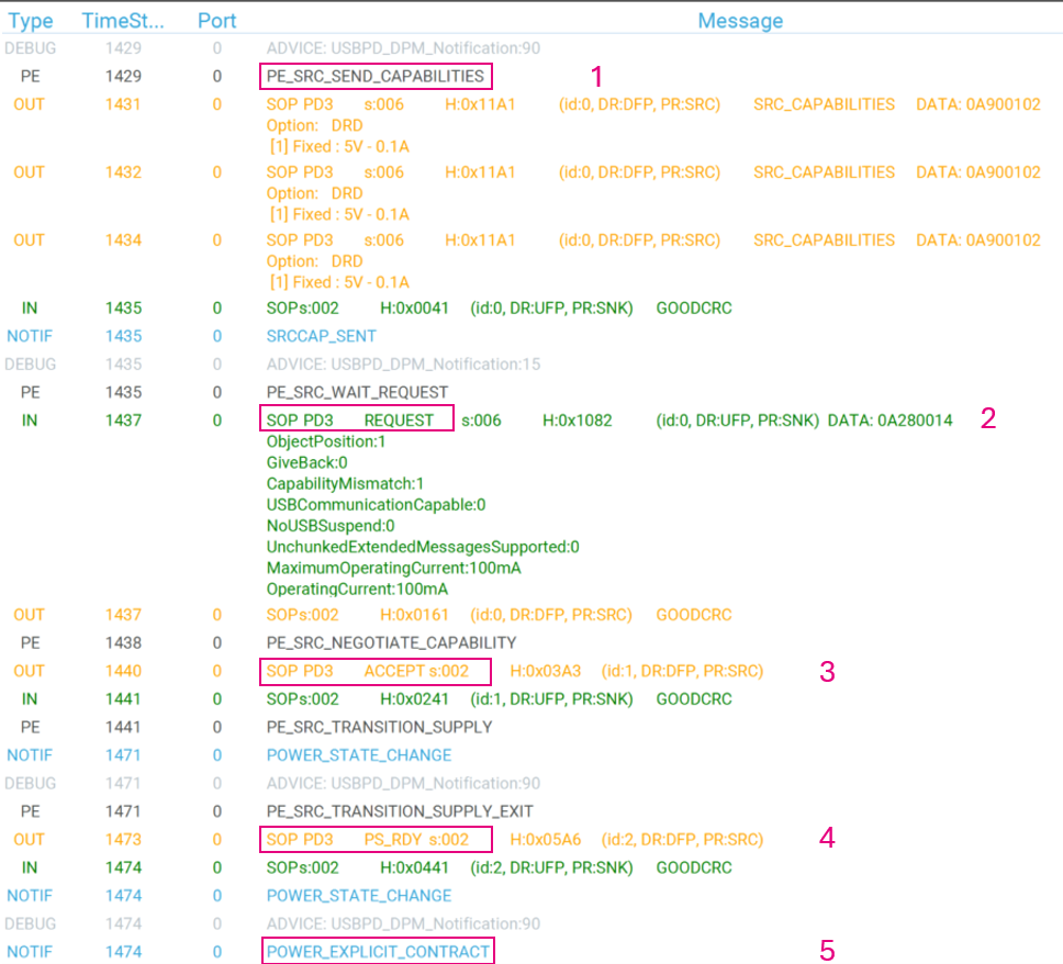

When the source application is configured correctly and a compatible USB PD sink is connected, the trace should typically show the following sequence:
The capabilities are sent by the source (OUT message).
The request is sent by the sink (IN message).
After receiving the sink’s Request, the source validates the requested power profile and replies with ACCEPT if it can support it.
Depending on the selected power path and voltage transition type, the output voltage may start changing immediately after ACCEPT. When the output has reached the requested level and is stable, the source sends PS_RDY.
The contract negotiation ends by the POWER_EXPLICIT_CONTRACT.
