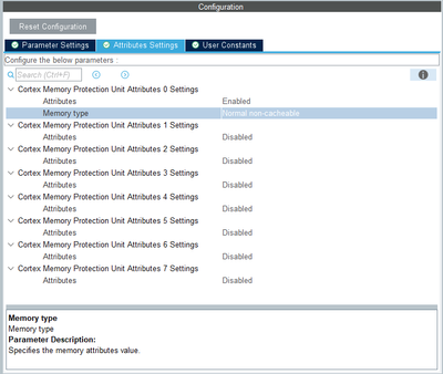

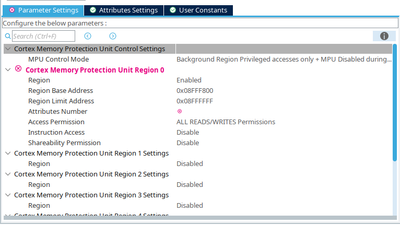

I'm currently developing on a H533RE. I could reproduce the issue (hard fault accessing the tempsensor calibration data) and I could fix it with the suggested MPU settings.
But I couldn't manage to have the MPU configured via CubeMX, for the dropdown "Attributes Number" has a list of non-selectable, greyed-out items (ATTRIBUTE 0..). Hovering the pink cross says:
Please select a new value other than '' from the provided list. Value not found.
Is it a CubeMX bug or my shortcoming?
Using stm32cubeide v1.19 (CubeMX 6.15.0), H5 HAL 1.5.0
Thank you in advance!
Tobias_Netzel
Associate
@oxullo, you need to define the attributes on the next tab, like this:

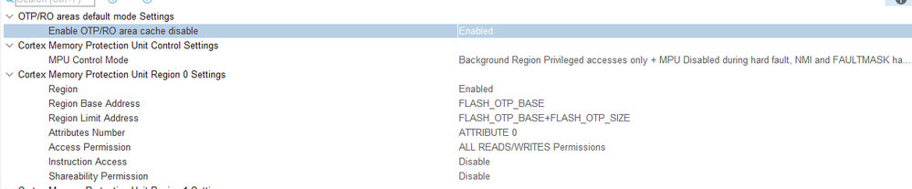

Hello, I am trying to do it as well, as soon I read the OTP memory, I go under the NMI interrupt.
I am not sure of you're memory address
region.BaseAddress      = 0x08FFF800;
Since the OTP start address is:
#define FLASH_OTP_BASE          (0x08FFF000UL) /*!< FLASH OTP (one-time programmable) base address */
Additionnaly, there is now a setting to disable area cache "OTP/RO areas default mode settings":
