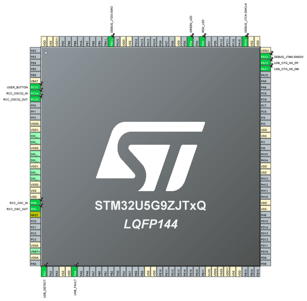

In CubeMX, create a master project for your STM32 MCU that has all your project's peripheral and middleware configurations (that is, FreeRTOS™, USB, RCC, etc.) minus the USBX middleware configurations.
For now, just configure:
  • FreeRTOS™ middleware.
  • TIM6 (or other TIMx peripheral) as the SysTick timebase.
  • RCC → LSE and RCC → HSE pins (as needed for USB).
  • USB pins & peripheral.
  • USB clock source in the CubeMX clock tree tab (if not already set correctly by default).
  • Default ICACHE settings (if applicable).
  • SWD debug pins.
  • On-board or external user LEDs and user button.
Refer to the attached "FreeRTOS + USBX" project for the specific configurations used on the STM32U5G9J-DK2 board.

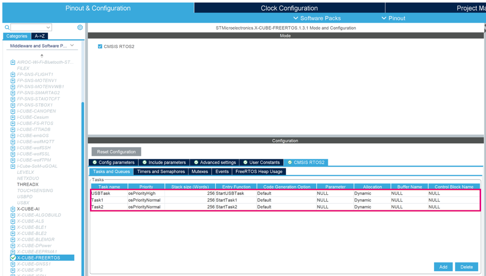

Add a FreeRTOS™ USBTask and a couple other tasks for testing purposes.

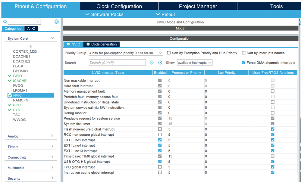

In the NVIC configurations, make sure that you have enabled the interrupts that are necessary for your design.

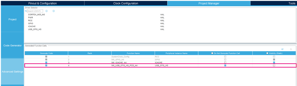

Configure the code generation settings to NOT generate the MX_USB_..._Init() function and make sure that its visibility is NOT static. This is because we place this function call in our USB application code, which is outside of main.c.
Generate the code when finished with the configurations. Build the freshly generated project to make sure that it builds successfully.

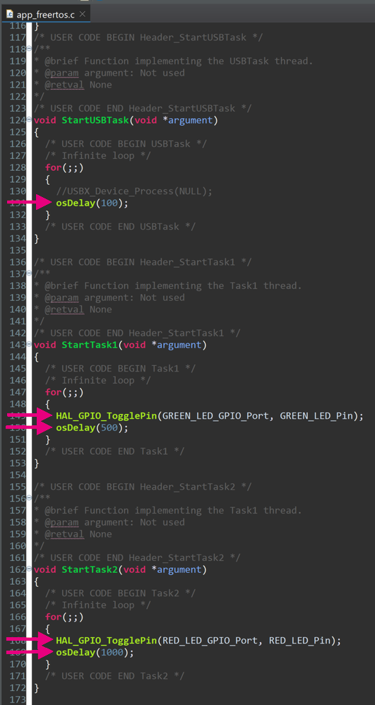

In app_freertos.c for example purposes: Blink the user LEDs in the Task1 and Task2 FreeRTOS™ tasks, and add osDelay() values for all three FreeRTOS™ tasks.
Build the project and launch a debug session to verify that the application runs properly on your board. You should see the on-board or external LEDs toggling accordingly depending on the osDelay() value.

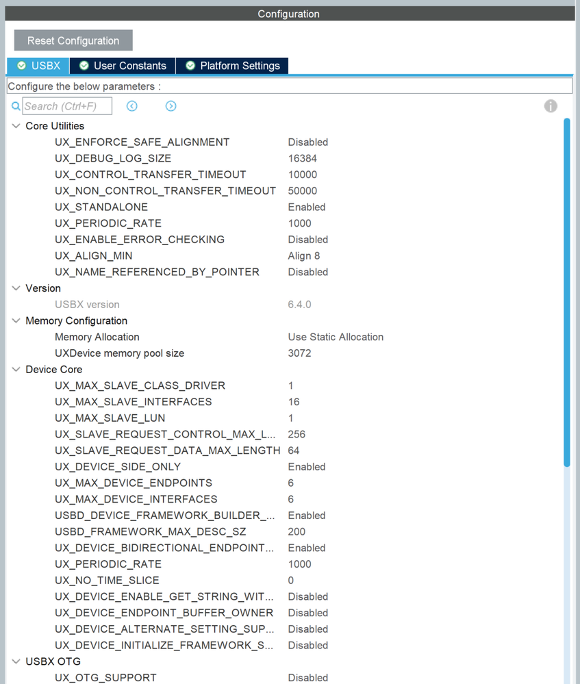

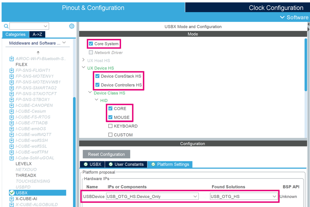

Configure the USBX middleware’s mode and platform settings accordingly. The mode configurations shown below are for a USB HID mouse device. If your USB application requires something different, then make sure that you use the correct mode configurations for your specific USB application.

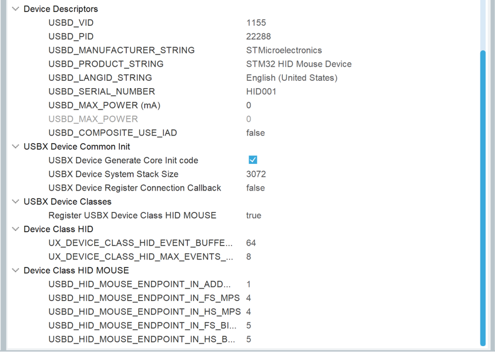

Configure the USBX middleware configurations as shown below.

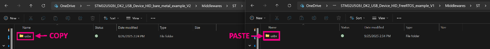

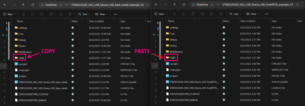

4. Copy over USBX folders
Copy the following files/folders from the "USBX only" project into your "FreeRTOS + USBX" project.
Folder 1: USBX
  • Copy from: C:\…\<USBX only project root folder>\USBX
  • Paste into: C:\…\<FreeRTOS + USBX project root folder>
Folder 2: usbx
  • Copy from: C:\…\<USBX only project root folder>\Middlewares\ST\usbx
  • Paste into: C:\…\<FreeRTOS + USBX project root folder>\Middlewares\ST
Note: If your “FreeRTOS + USBX“ project does not have a Middlewares\ST folder, then create it.

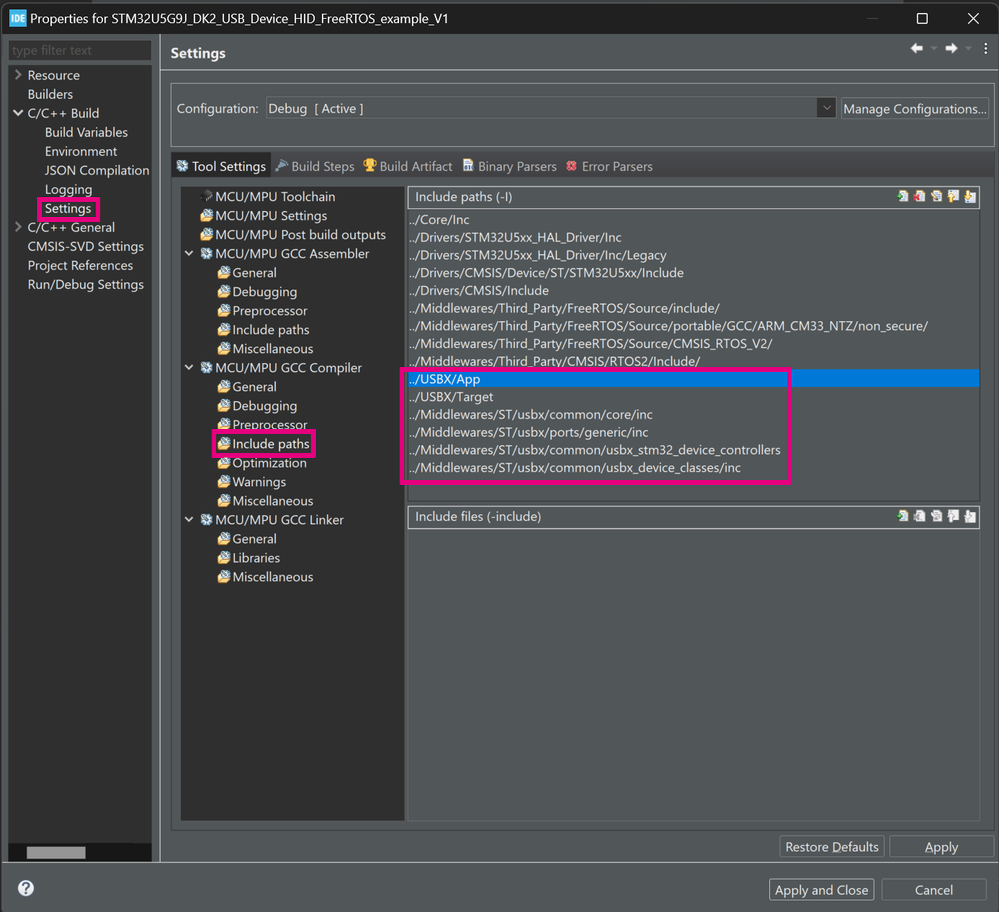

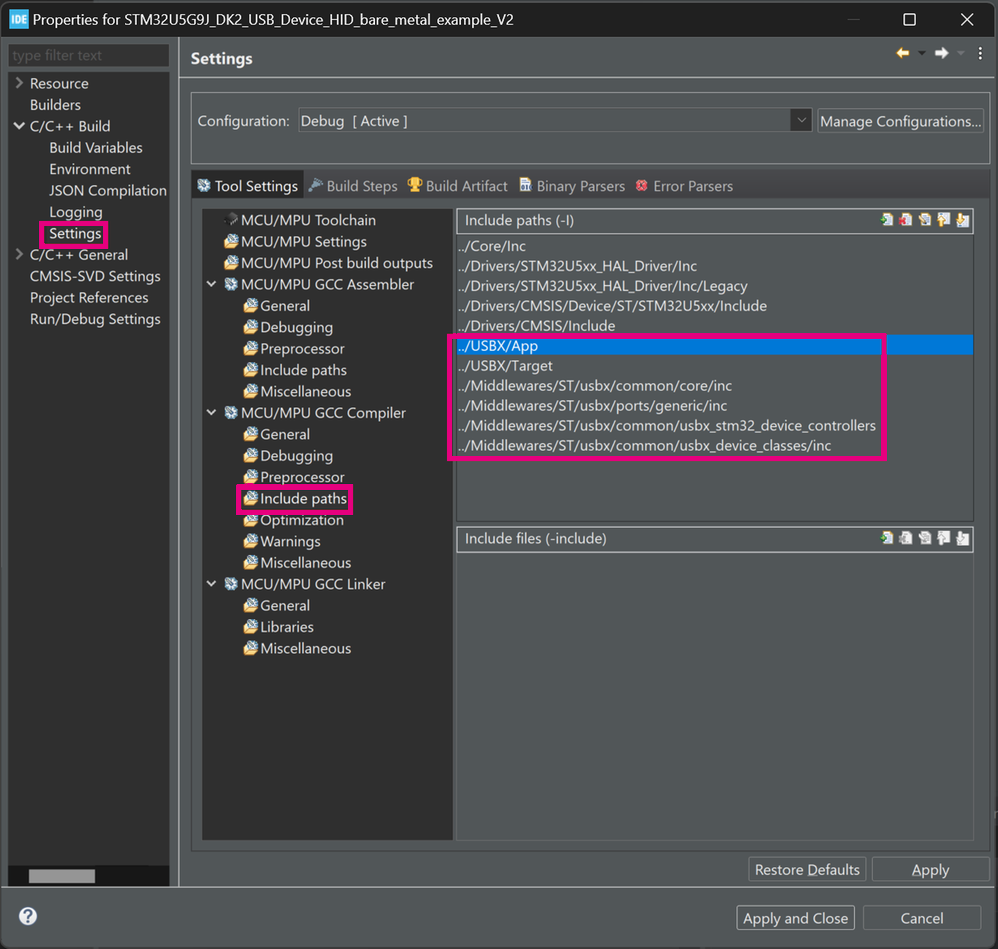

5. Update compiler include paths
In the "FreeRTOS + USBX" project, we need to add the compiler include paths for the files/folders we copied over.
Right click on the "USBX only" project→ Properties → C/C++ Build → Settings → Tool Settings → MCU/MPU GCC Compiler → Include paths. Copy all "../USBX/…" and "../Middlewares/ST/usbx/…" include paths that are listed.
Add them to the "FreeRTOS + USBX" project → Properties → C/C++ Build → Settings → Tool Settings → MCU/MPU GCC Compiler → Include paths.
For convenience, here’s a plain text version of the main compiler include paths you need to copy into your own “FreeRTOS + USBX” project:
  • ../USBX/App
  • ../USBX/Target
  • ../Middlewares/ST/usbx/common/core/inc
  • ../Middlewares/ST/usbx/ports/generic/inc
  • ../Middlewares/ST/usbx/common/usbx_stm32_device_controllers
  • ../Middlewares/ST/usbx/common/usbx_device_classes/inc
Click [Apply], [Rebuild Index], then [Apply and Close] when done.

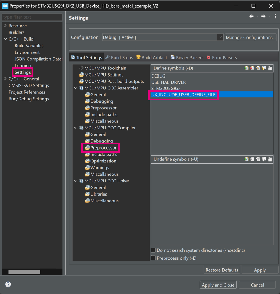

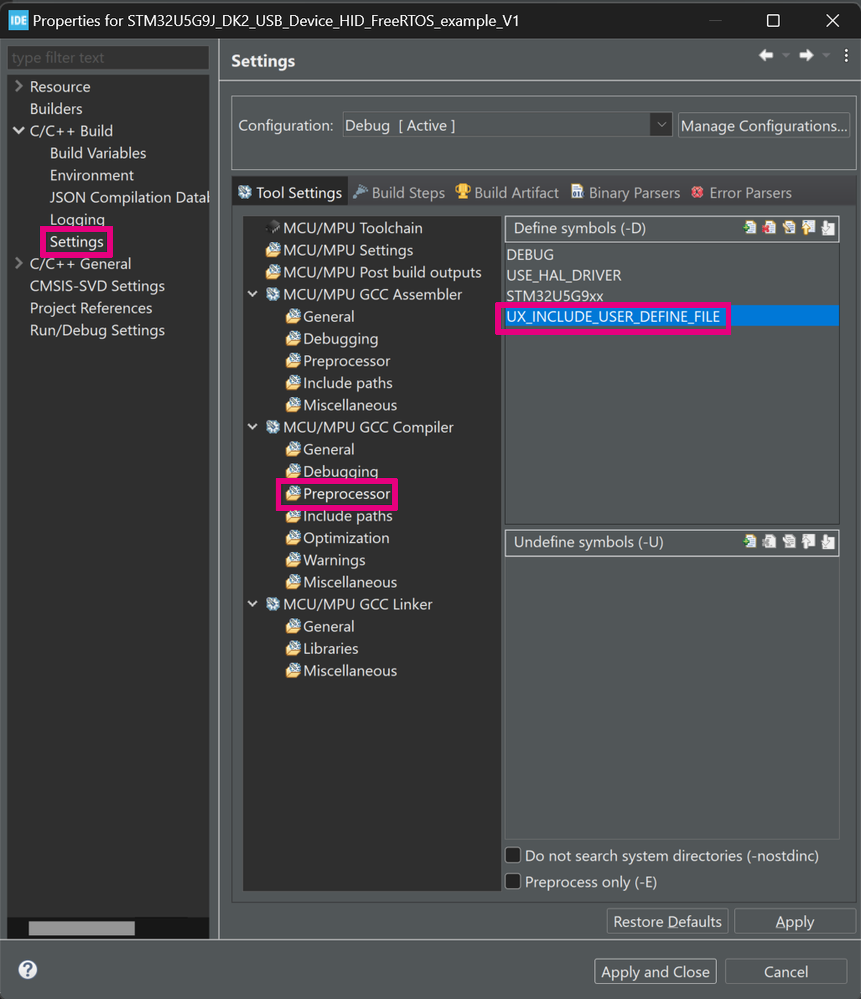

6. Update compiler preprocessor define symbols
In the "FreeRTOS + USBX" project, we need to add the USBX related compiler preprocessor define symbols.
Right click on the "USBX only" project → Properties → C/C++ Build → Settings → Tool Settings → MCU/MPU GCC Compiler → Preprocessor. Copy all USBX / UX related compiler preprocessor define symbols that are listed.
Add them to the "FreeRTOS + USBX" project → Properties → C/C++ Build →  Settings → Tool Settings → MCU/MPU GCC Compiler → Preprocessor.
For convenience, here is a plain text version of the main compiler preprocessor define symbol you need to copy into your own “FreeRTOS + USBX” project:
  • UX_INCLUDE_USER_DEFINE_FILE
Click [Apply], [Rebuild Index], then [Apply and Close] when done.  Build the "FreeRTOS + USBX" project to make sure that it builds without errors.

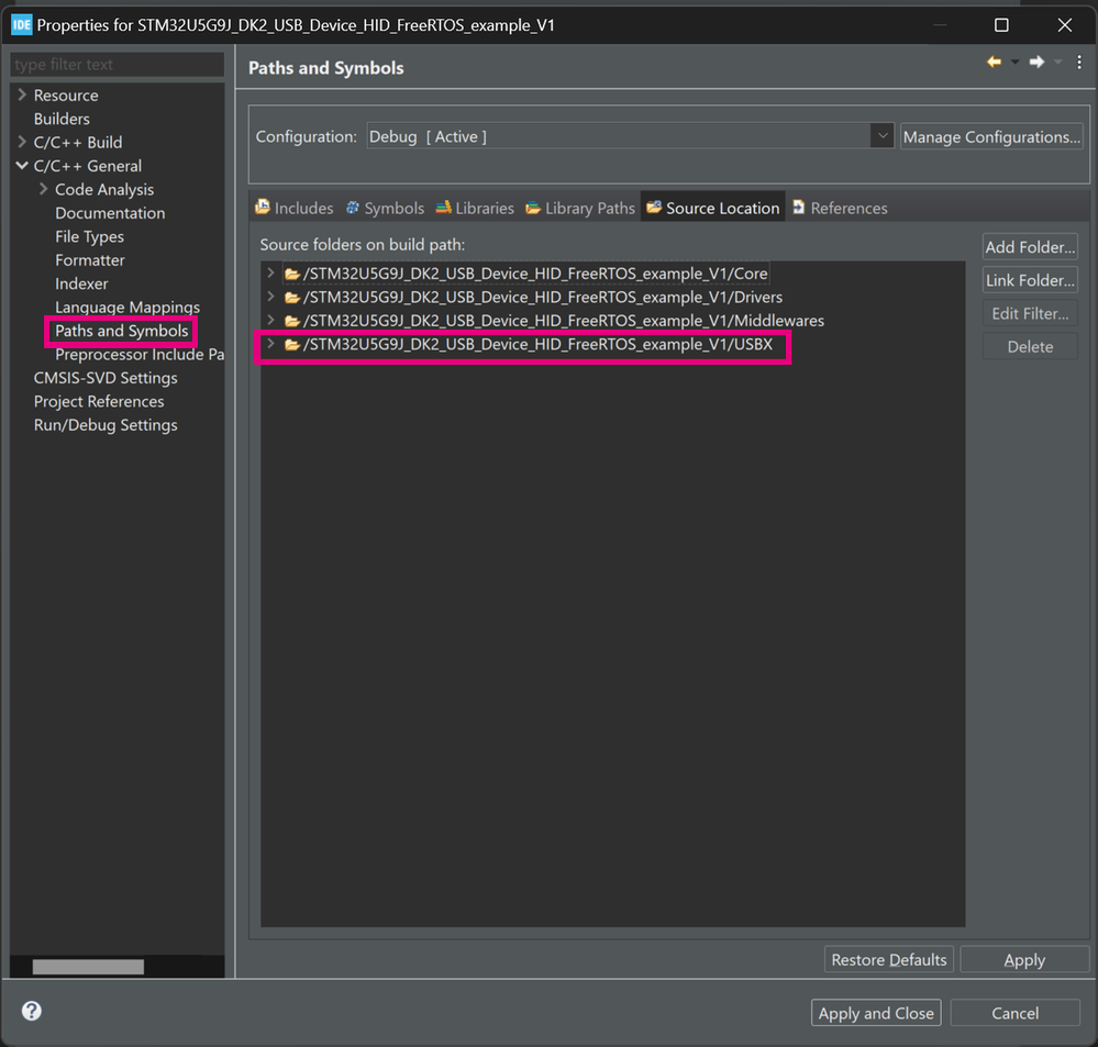

7. Update source folders on build path list
In the "FreeRTOS + USBX" project, we need to add the USBX folder to the source folders on the build path list.
Right click on the "FreeRTOS + USBX" project → Properties → C/C++ General → Paths and Symbols → Source Location. Add the /<FreeRTOS + USBX project root folder>/USBX folder.

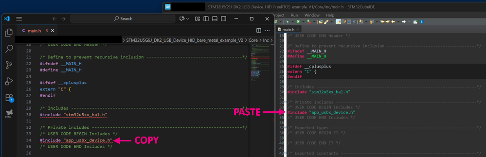

8. Add USBX includes
In the "FreeRTOS + USBX" project, we need to add the USBX related includes to main.h and main.c.
In the "USBX only" project, copy all USBX related includes in main.h. Paste them into the "FreeRTOS + USBX" project → main.h file between the "USER CODE BEGIN Includes" and "USER CODE END Includes" labels.
Note: The app_usbx_device.h header file shown above is specific to USBX configured as a USB device. So if your USBX configurations are different, you may have different header file names. Make sure you copy all USBX related includes from your main.h file, not just the one shown above.
In the "USBX only" project, copy all USBX related includes in main.c. Paste them into the "FreeRTOS + USBX" project → main.c file between the "USER CODE BEGIN Includes" and "USER CODE END Includes" labels. Note: If a specific include is already in main.h, there is no need to put it in main.c.
Save and build the "FreeRTOS + USBX" project to make sure that it builds without errors.

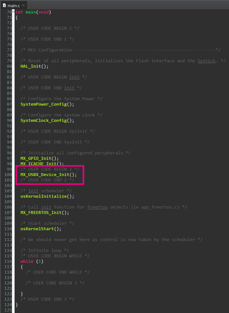

In main.c, you need to place the MX_USBX_Device_Init() function between the "USER CODE BEGIN 2" and "USER CODE END 2" labels.
Note: The MX_USBX_Device_Init() function is specific to USBX configured as a USB device. So if your USBX configurations are different, you may have a different MX USBX initialization function name.
Note: Aside from the MX_USBX_Device_Init() function, the rest of the code shown in main() is auto generated and is STM32 device specific and configuration specific. You may see different auto generated code in your main() function. Do not modify it with the auto generated code from the screenshot above.

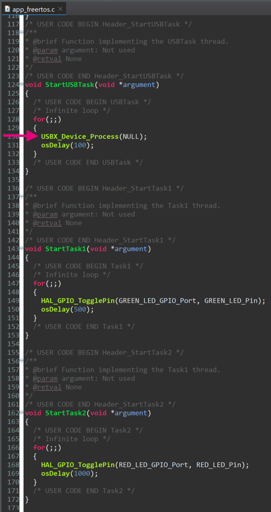

10. Move the USB process start function
In the “FreeRTOS + USBX” project, we need to move the USBX_Device_Process(NULL) function from main() to the FreeRTOS USB task in app_freertos.c.
  • Delete from main.c → main(): USBX_Device_Process(NULL);
  • Add to app_freertos.c → StartUSBTask(): USBX_Device_Process(NULL);
Note: The USBX_Device_Process(NULL) function is specific to USBX configured as a USB device. So, if your USBX configurations are different, you may have a different USB process start function name.
Note: StartUSBTask() is the name of the USB FreeRTOS task created in section 1 of this article. If you are using a different USB task start function name, then your StartUSBTask() function will have a different name.
When done, build the "FreeRTOS + USBX" project to make sure that there are no errors.

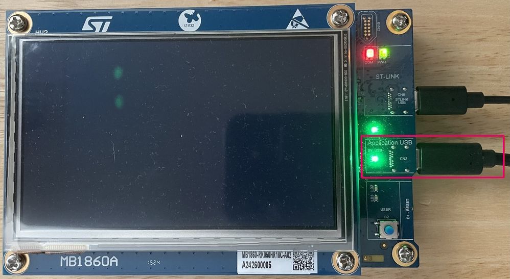

In the “FreeRTOS + USBX” project, launch a debug session and click Run / Resume to run the application on your board. Make sure that your second USB Type-C® cable is plugged into your PC and the application / user USB connector on your board (CN2 on the STM32U5G9J-DK2 board).
You should see the on-board or external LEDs toggling accordingly depending on the osDelay() values of the FreeRTOS tasks Task1 and Task2.
Every time you press the on-board or external user push button, your computer's mouse cursor moves.
