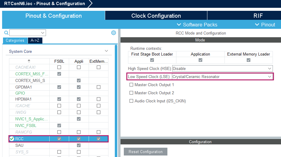

On STM32CubeMX, assign the RCC to the Low Speed Clock (LSE). You can do this in the [System Core] section.

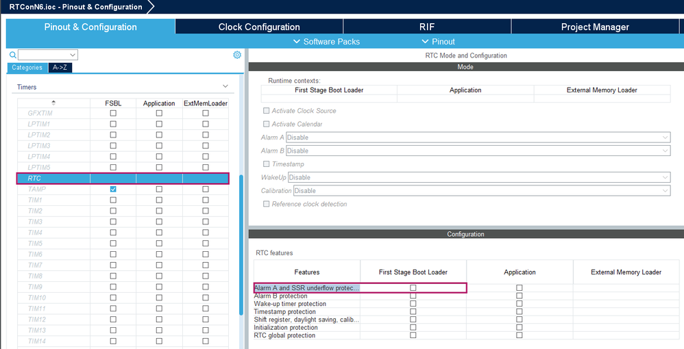

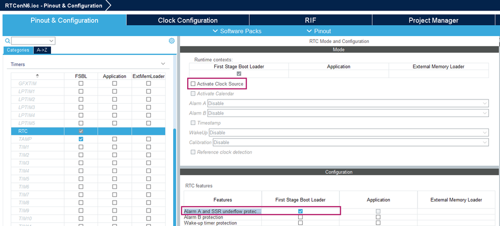

Under the [Timers] section, click on [RTC] and then click on the [Alarm A and SSR Underflow protection].
Here, you can independently assign the RTC features for your first stage bootloader (FSBL) or application. We choose the FSBL for this example.
Then, check the [Activate Clock Source] box.

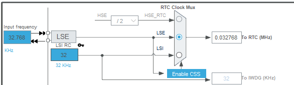

Along with that, on the “Clock Configuration” tab, you can change RTC Clock Mux from LSI to LSE.

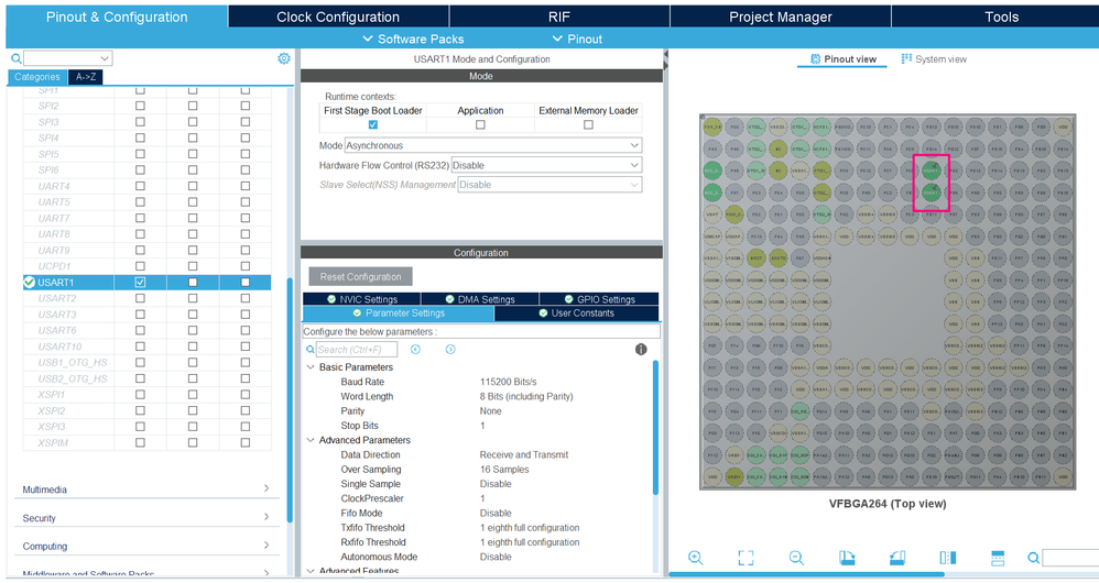

Locate the [USART1] under Connectivity and enable it for the FSBL, using the settings: 115200 / 8 / N / 1 and assign the pins PE5 and PE6 for Tx and Rx, respectively, as shown below:

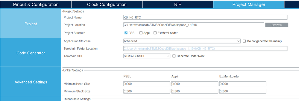

Under [Project Manager] you can select your desired Toolchain/IDE, choose [FSBL] as the project structure and click [Generate Code]. This example relies on STM32CubeIDE with only the FSBL and not generating the code under root.

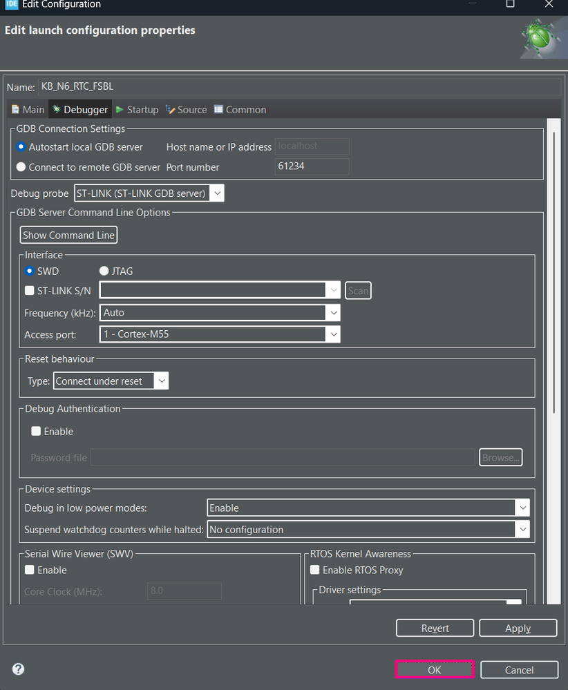

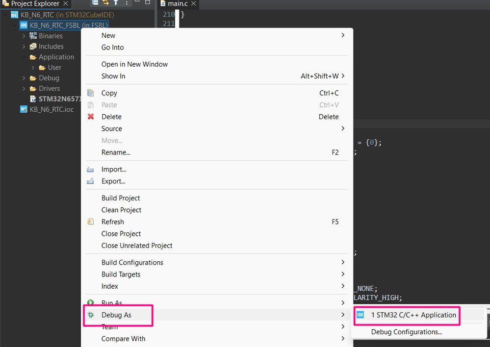

Build the project, configure the debugger interface, and load the code.

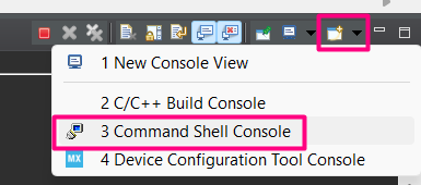

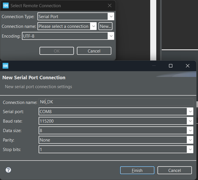

Before starting the application, configure the terminal for tracking the time and calendar.
This code sends messages via UART every second:
