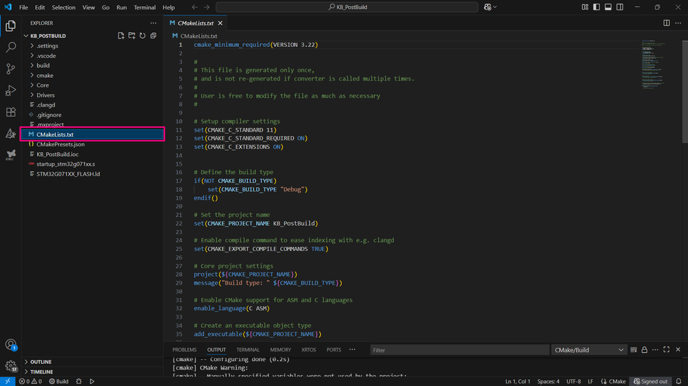

Import your project and locate the CMakeLists.txt file in the root of your STM32 project.
Insert the following code snippet at the end of your CMakeLists.txt file:

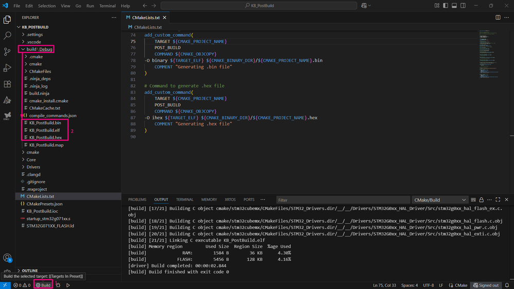

3. Verifying the output
Build the project by using the [Build] button at the lower left corner and after the build completes, navigate to the [build/] directory to verify that the *.elf, *.bin and *.hex files have been generated.
After generating the .bin or .hex files, you can flash them to your STM32 microcontroller using STM32CubeProgrammer to validate the code at runtime.

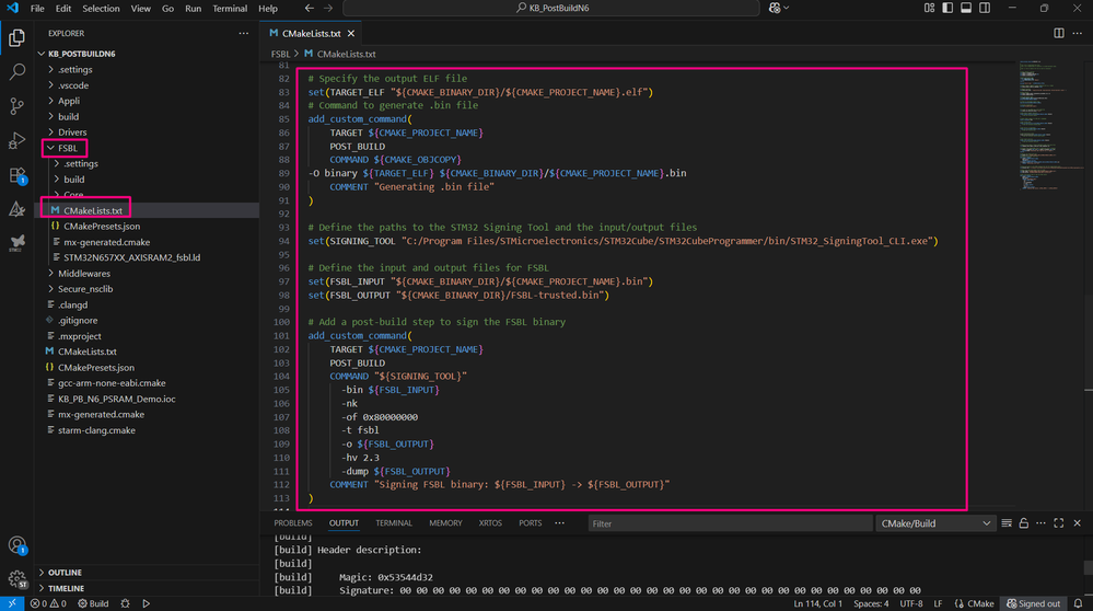

4.1 Example: signing the FSBL
Since the signing tool will be called every time a new build is performed, it is mandatory to echo the "y" to replace the previous signed binary. A possible way to implement this is shown below, slightly editing the previous commands. Starting from STM32CubeProgrammer version 2.21.0 a new parameter is needed "-align". Please make sure you use the updated command, as follows:
