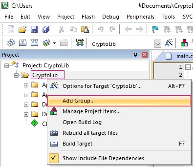

1. Right click on "Project: Cryptolib" and select "Add Group..."
2. Create a new group called, our example is: "Middlewares/STM32Cryptographic"

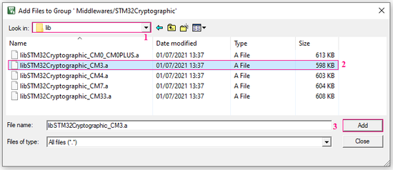

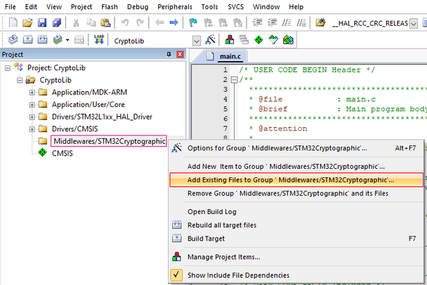

3. Right click on "Middlewares/STM32Cryptographic" and select "Add Existing Files to Group Middlewares/STM32Cryptographic’…
4.  The project example in this article is based on the STM32L1 MCU series 32-bit Arm® Cortex®-M3.
For this reason, it is necessary to add "libSTM32Cryptographic_CM3.a" from "STM32CubeExpansion_Crypto_Vx.x.x\Middlewares\ST\STM32_Cryptographic\lib"

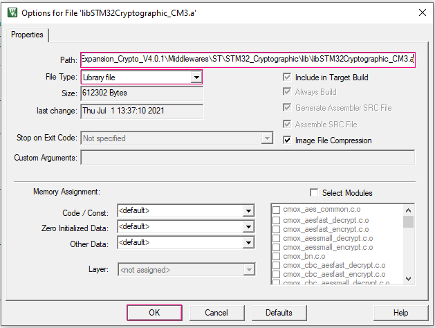

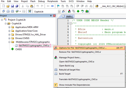

5. Right click on “libSTM32Cryptographic_CM3.a" in the Keil® project and select “Options for file ‘libSTM32Cryptographic_CM3.a'..."
6. Add the path of “libSTM32Cryptographic_CM3.a" and modify the file type to "Library file" as shown in the below figure:

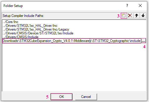

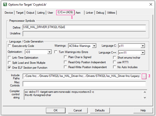

7. Right click on the project and select “Options for Target". Select "C/C++(AC6)" and add the path by following the steps below as demonstrated by the images:

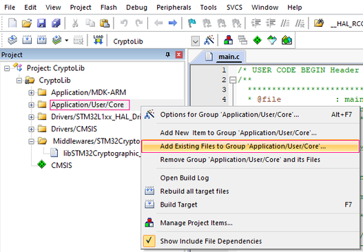

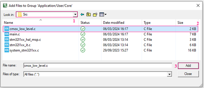

9. Right click on "Application/User/Core" and select "Add Existing Files to Group Application/User/Core"
10. Add the "cmox_low_level.c" file
