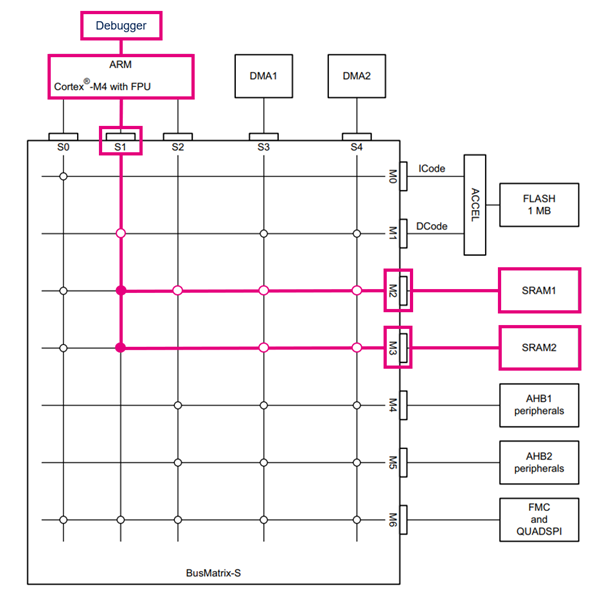

The D-bus (S1) is a crucial link between the Cortex®-M4 core's data bus and the BusMatrix. It is utilized by the core for literal loads and during debug access, providing uninterrupted access to SRAM. This facilitates efficient operation and debugging by offering a direct pathway to SRAM via the D-bus, enabling real-time data inspection and manipulation.

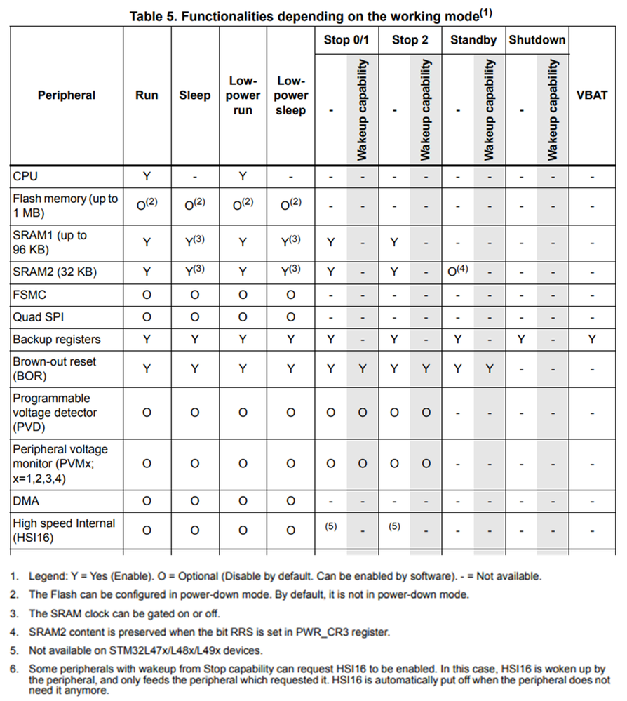

For example, in Sleep and low-power Sleep modes, the CPU is halted while all other functions remain operational (excepted USB OTG_FS and RNG in low-power Sleep mode). SRAM and register contents can be preserved, but the debug interface's access to SRAM is disabled to reduce power supply consumption.

As mentioned above, the D-bus allows for the manipulation of variables and analysis of the program in debug mode with the STM32L476.

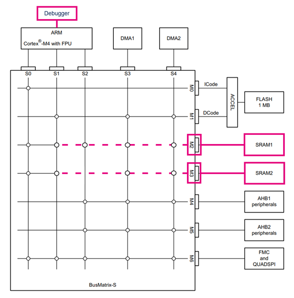

In Sleep and low-power Sleep modes, the VCORE domain is halted to reduce power consumption, and the SRAM clock can be gated on or off (the contents of the SRAM and registers can be nevertheless preserved). However, to further minimize power usage, the access paths to these SRAM memory blocks are power off.
While the STM32L476's low power modes are beneficial for power conservation, they introduce a configuration change for developers who need to debug applications:
  • Debugging in Sleep and low-power Sleep modes: The debug interface, which typically uses SRAM access for monitoring and modifying application state, is unable to perform these operations when the microcontroller is in Sleep and low-power Sleep mode.
  • SEGGER RTT and other debug tools: Real-time debugging tools that rely on continuous memory access are particularly affected, as they can only function with active SRAM access.

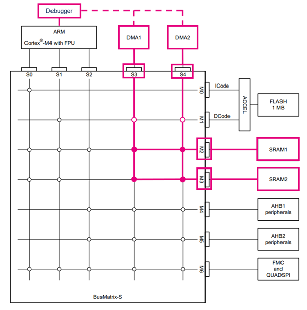

The Direct Memory Access (DMA) controller in the STM32L476 offers the solution to the SRAM access challenge during Sleep and low-power Sleep modes. While the CPU and its buses may be inactive during these modes, the DMA can remain operational. This is because the DMA is designed to perform high-speed data transfers independently of the CPU. It's particularly useful for power-saving strategies where the CPU is not required to be active.
The DMA's ability to access memory and peripherals without CPU intervention can be leveraged to maintain a "hidden" access path to SRAM during Sleep mode. By configuring the DMA to perform transfers involving SRAM, we can ensure that the BusMatrix, which arbitrates access to memory, remains active. This is due to the BusMatrix's design, which automatically activates when at least one master (such as the DMA) is on.

Begin by configuring the DMA channel with SRAM as the destination address. This can be SRAM1 or SRAM2, depending on where the data of interest resides.
Set the source address to a peripheral that is active during Sleep mode or another memory region that is not restricted in low-power modes.
Configure the transfer size and enable the DMA channel, ensuring that the transfer does not start immediately but is ready to be triggered.
