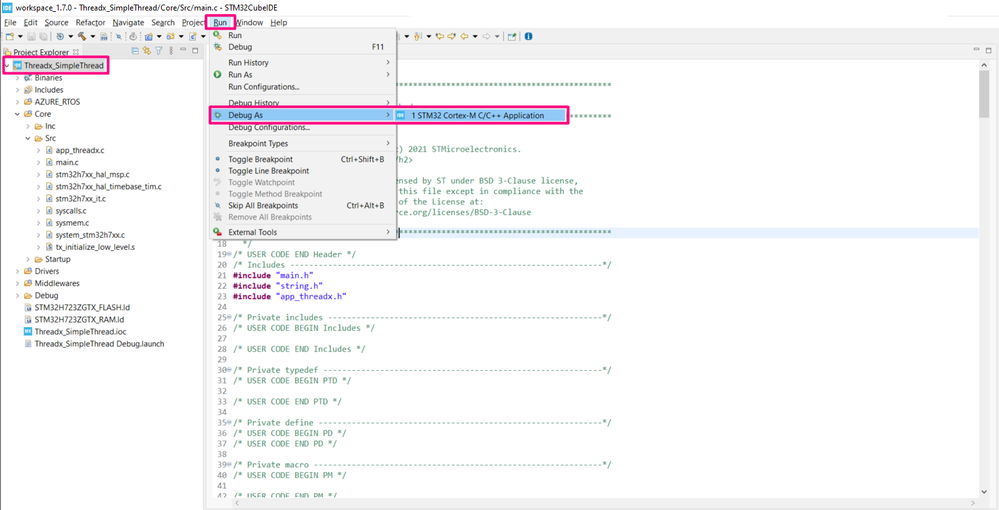

Connect the board to the computer and enter in debug mode by first clicking in the project name, then menu Run/Debug As/STM32:

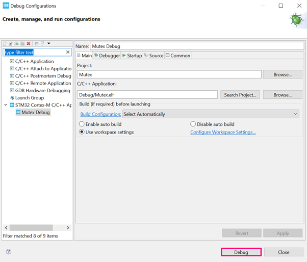

In Edit Configuration window, click Debug:

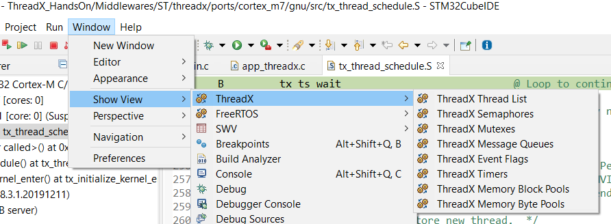

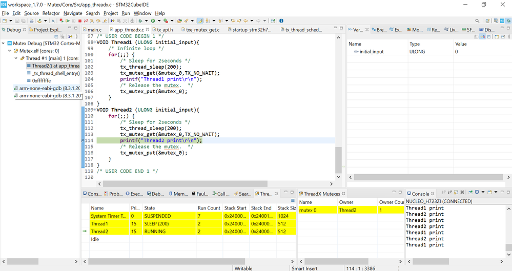

Once in the Debug perspective, click in the resume button to enjoy your ThreadX application with mutex working. You can also use the Window/Show View/ThreadX/ThreadX Thread List and do it again for the ThreadX Mutex to enhance the overall debugging options (the thread list will be automatically loaded once the application runs for a bit and is paused):

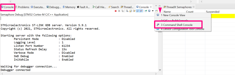

Now, the last step is to enable the console inside the STM32CubeIDE to see the print messages. Locate the Console tab and click Command Shell Console:

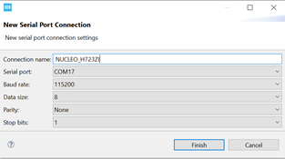

In the pop-up window, change the Connection Type to Serial Port and click on New… to add the VCOM related to your STLINK:
You can give the port a name, so it is easier for later usage as well, in this case, it will be labelled as NUCLEO_H723ZI:
By clicking finish, the message on the console will indicate it is now connected. By resuming the application (pressing F8), the printf messages will be displayed. Adding a breakpoint allows the Mutex and ThreadX information to be updated:

The Thread1() and Thread2() code is not correct. They call tx_mutex_get() with TX_NO_WAIT. This will return immediately even if the mutex was not available. If you really want to use TX_NO_WAIT, then you must check the tx_mutex_get() return value for TX_SUCCESS (got the mutex) or TX_NOT_AVAILABLE (did not get the mutex).
Better (and in this example, a more realistic) usage would be to use TX_WAIT_FOREVER.
