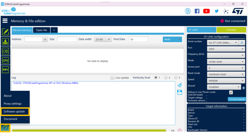

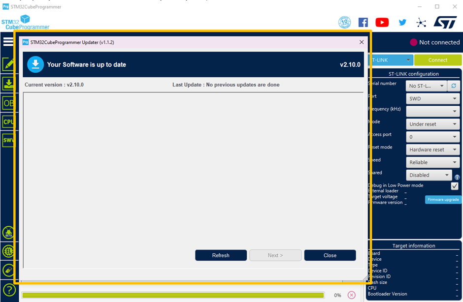

Step 1. Launch the STM32CubeProgrammer GUI (Graphical User Interface). In the bottom left-hand corner of the screen, select the ‘?’ icon. Then select the ‘Software Update’ option.
Step 2. A STM32CubeProgrammer updater pop-up window will appear. Note that the contents of this window may differ, depending on the current version of STM32CubeProgrammer you are running. If you have any updates to make, please follow the pop-up window’s on-screen prompts.

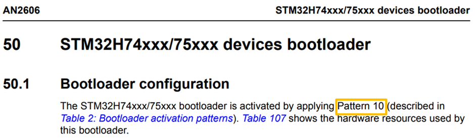

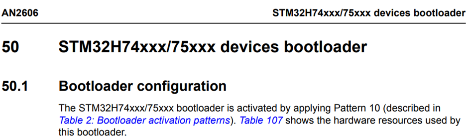

Step 1. Locate your STM32 device in AN2606. This section will reveal the activation pattern you need to apply. In addition, provides the various available bootloader interfaces for your device and even more importantly, the hardware resources required by the bootloader.

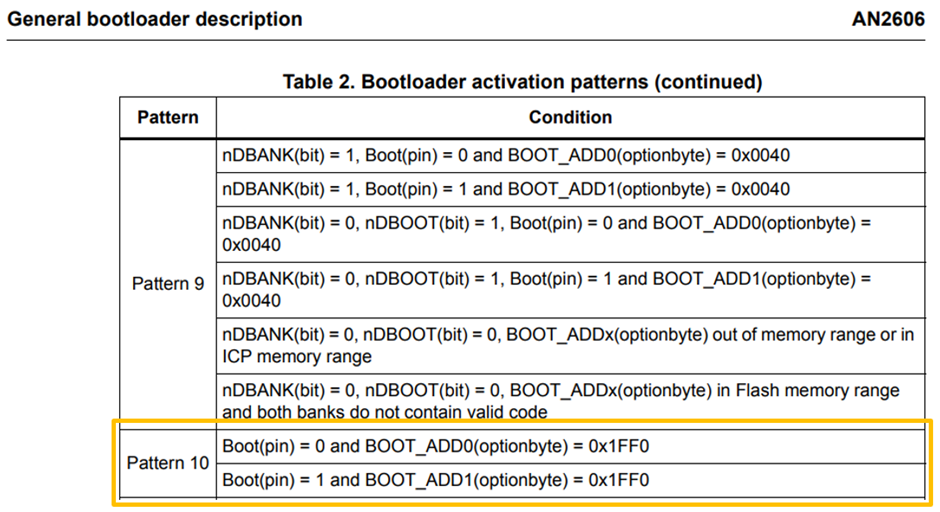

Step 2. Locate the pattern denoted in your target MCU’s bootloader configuration description and in the bootloader, activation patterns table. Note that if there are multiple options for a pattern, you may select any option of your choice to apply.
In our example, the pattern we must use is pattern 10.

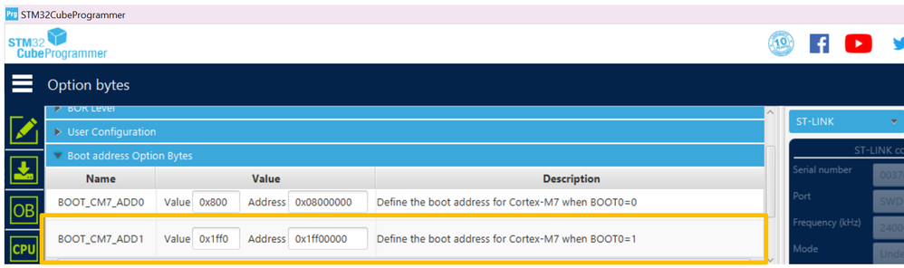

Step 3.
As pattern 10 has two different options, we will select the second pattern 10 option: Boot(pin) = 1 and BOOT_ADD1(optionbyte) = 0x1FF0. On the Nucleo-H743ZI, I have verified that the BOOT_CM7_ADD1 value and address in the MCU’s option bytes is set to 0x1FF0 using STM32CubeProgrammer. I have also connected the BOOT0 pin (located on CN11 pin 7) to VDD.

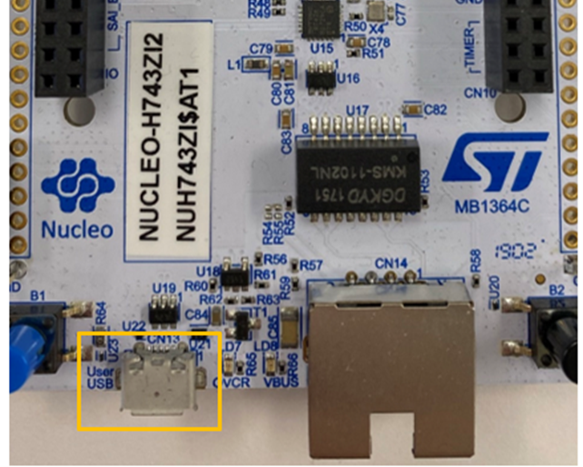

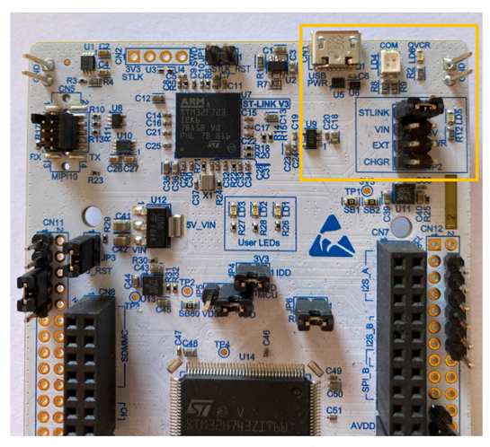

You will need two micro-USB cables, one to power the board and another to launch the USB DFU bootloader.
First, locate the user USB port on your board and attach the board to your host machine with a micro-USB cable.
Second, locate the ST-LINK USB port on your board and connect to the port using the second micro-USB. Note that there are various ways to power the board such as using the on-board ST-LINK or an external 5V power source. Whatever the board’s power source is selected to be; you will need to modify the board’s jumper 2 (JP2) to reflect the 5V power supply source to the Nucleo-H743ZI board.

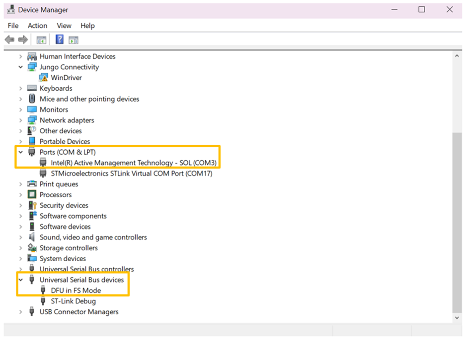

Step 5. Launch your computer’s device manager. Here you should be able to see that the USB bootloader is now running, and the board is detected as a DFU device.

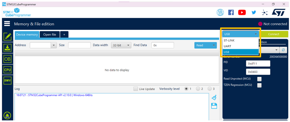

In STM32CubeProgrammer you will want to select the USB connectivity option in the drop-down menu next to the green “Connect” icon.
Step 7.

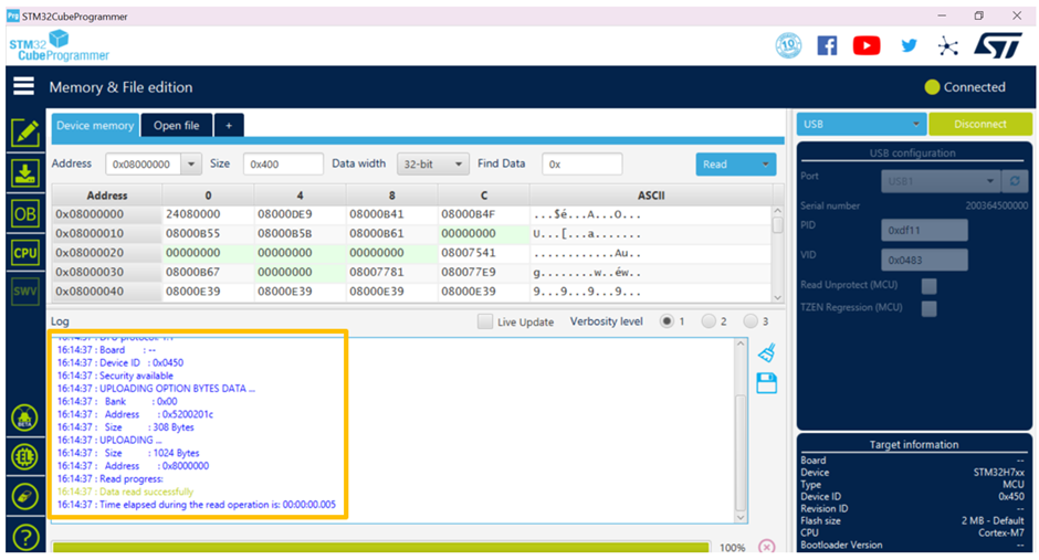

Next to where you selected USB connectivity, click on the ‘Connect’ icon. Congratulations! We have successfully used STM32CubeProgrammer to launch ST’s internal USB-DFU bootloader on the Nucleo-H743ZI board.
The STM32CubeProgrammer GUI has various applications that can help you with your project. Some of the things you can do include but are not limited to reading from / writing to flash memory and RAM, reading / programming the device option bytes, and checking CPU register contents.

The picture in step 3 of the Option Bytes options is no longer correct (v2.10.0). There is no "Boot address Option Bytes" choice. What need to do to have the Programmer let me load code into my STM32L041xx?

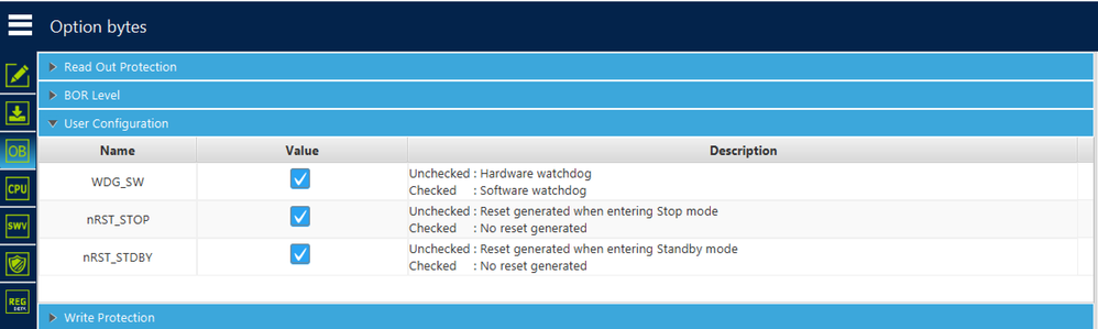

When you replied to @MStev.4  about needing to verify the value of nBoot1 in the user option bytes, where is this done? As seen in the image below I have the following settings in the Option bytes:
