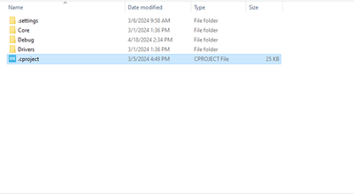

3.3 Using the Embedded Tools extension to convert STM32CubeIDE projects to VS Code projects
As you develop your STM32 applications in VS Code, you may desire to convert some of your existing STM32CubeIDE projects into VS Code projects. This is accomplished through the Embedded Tools Extension in VS Code.
  1. Open [Extensions] (Ctrl + Shift + X) from within the VS Code application
  2. Download the Embedded Tools extension
  1. Once the extension is installed, you can type >Embedded Tools: Create Project into the search bar
  1. Once you select that option from the dropdown menu, you can select the .cproject file from your existing STM32CubeIDE project.
  1. Now, you have successfully opened your existing STM32CubeIDE project in VS Code.

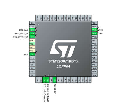

  1. Create a new project. When configuring your project in STM32CubeMX, note that USART2 is enabled on PA2 and PA3. We use USART2 to output a message onto the Serial Monitor.
