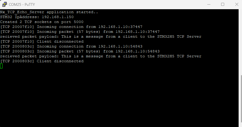

    6. Testing the application
    We can now test our application by generating multiple packets on the same port (5000).
    We can see that we are receiving incoming connections on the same port.

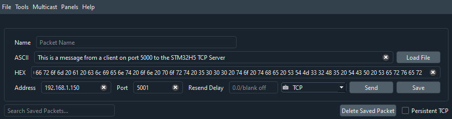

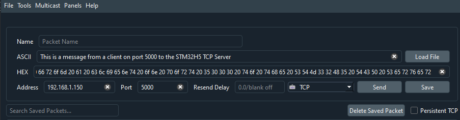

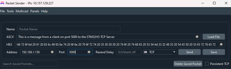

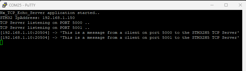

    Handling multiple clients on separate ports
    You can find attached the file app_netxduo++clients_separate_port.c that you can replace in this project to test this use case.

    To test the application, we use a packet sender to generate two packets on different ports (5000,5001).
    We can see in this trace that the server running on the STM32H5 is receiving both messages from different ports.
