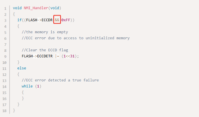

Below is an example of an NMI handler for this scenario:
void NMI_Handler(void)
  if((FLASH->ECCDR & 0xFF))
    //the memory is empty
    //ECC error due to access to uninitialized memory
    //Clear the ECCD flag
    FLASH->ECCDETR |= (1<<31);
  else
    //ECC error detected a true failure
    while (1)

这里是不是有问题?
Sarra.S
Hi @aa3, thanks for noting this!
Indeed it should be:
This will be corrected!
