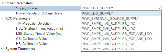

1. STM32CubeMX is not showing the DIRECT_SMPS_SUPPLY option
As illustrated in figure 1, the SMPS (PWR_DIRECT_SMPS_SUPPLY) power configuration option is not displayed, while LDO (PWR_LDO_SUPPLY) and other power configurations are available. This may appear to be a bug or limitation in STM32CubeMX to the user. However, this is not the case.
Figure 1. PWR_DIRECT_SMPS_SUPPLY is not shown in STM32CubeMXFigure 1. PWR_DIRECT_SMPS_SUPPLY is not shown in STM32CubeMX

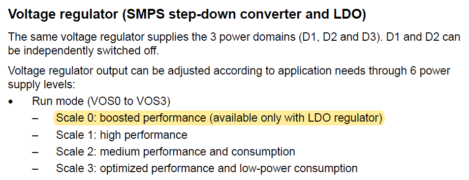

The Voltage Scale 0 (VOS0 - boosted performance) is available only with the LDO regulator, as shown in Figure 2 below.
Figure 2. VOS0 usage restrictionFigure 2. VOS0 usage restriction

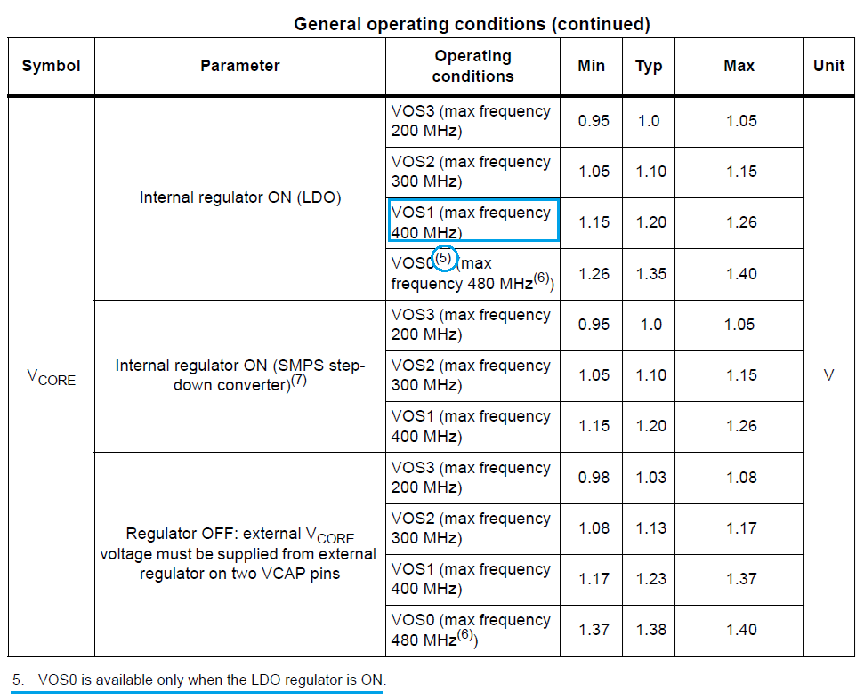

The Boosted performance refers to a system frequency greater than 400 MHz, where VOS0 (Voltage Scale Level 0) must be used. As illustrated in figure 3, the maximum frequency supported with VOS1 is 400 MHz.
Figure 3. VOS versus maximum frequency (datasheet excerpt)Figure 3. VOS versus maximum frequency (datasheet excerpt)

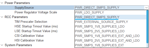

If the system frequency is configured to exceed 400 MHz, STM32CubeMX automatically sets the voltage scale to VOS0 and disables the DIRECT_SMPS_SUPPLY option by hiding it. To enable this option, set the system frequency to a value less than or equal to 400 MHz. Figure 4 demonstrates the DIRECT_SMPS_SUPPLY option displayed in STM32CubeMX.
Figure 4. PWR_DIRECT_SMPS_SUPPLY is shown in STM32CubeMXFigure 4. PWR_DIRECT_SMPS_SUPPLY is shown in STM32CubeMX

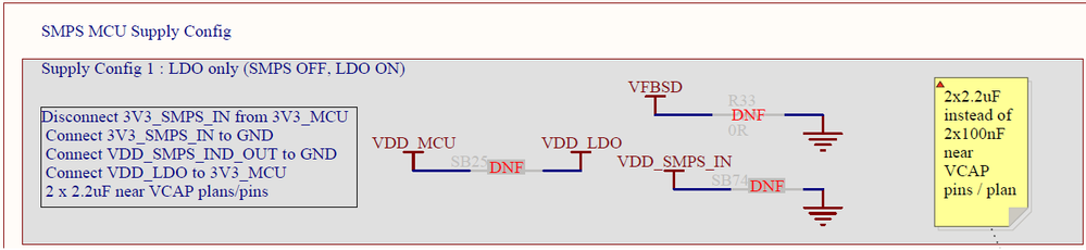

For instance, if you are using the NUCLEO-H755 board, the maximum frequency allowed with this board is 400 MHz, as the default power supply configured by hardware is SMPS. To achieve the maximum frequency of 480 MHz, you must modify the hardware configuration on the board to operate in LDO mode. Refer to the board’s schematic for details on the required modifications. Figure 5 illustrates the changes needed to switch the NUCLEO-H755 board to LDO mode.
Figure 5. Modification of NUCLEO-H755 to be in LDO mode instead of SMPSFigure 5. Modification of NUCLEO-H755 to be in LDO mode instead of SMPS
Ensure that the correct power supply is configured according to the board’s power setup. Otherwise, the MCU may become locked. In such cases, follow the procedure to unlock the MCU.
