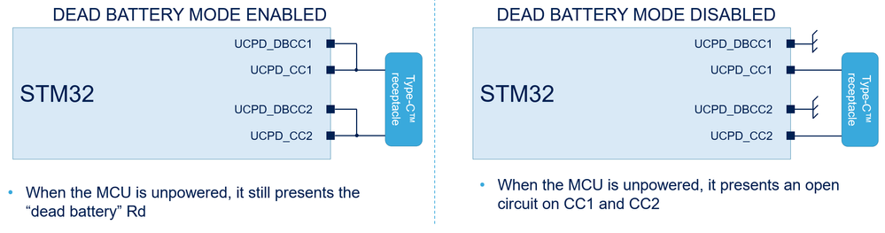

1. How should DBCC pins be connected for dead battery support?
For dead battery support, the DBCC pins (UCPDx_DBCC1 and UCPDx_DBCC2) must be externally connected to their respective CC pins (UCPDx_CC1 and UCPDx_CC2). This connection allows the internal pull-down resistor to signal a VBUS supply request when the device is unpowered.
2. What should be done if dead battery support is not required?
If dead battery support is not required (for example, for source-only products), the DBCC pins (UCPDx_DBCC1 and UCPDx_DBCC2) must be tied to ground. This prevents the activation of the internal pull-down resistors, allowing the pins to be used for other functions.

7. What happens when the MCU is unpowered?
When the MCU is unpowered, it still presents the “dead battery” Rd, provided that UCPDx_DBCC1 and UCPDx_DBCC2 pins are each connected to UCPDx_CC1 and UCPDx_CC2 pins, respectively. If dead battery behavior is not required, tie UCPDx_DBCC1 and UCPDx_DBCC2 pins to ground.

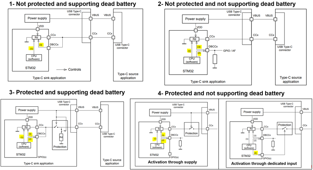

Applicative use cases
The following section lists the principal topologies of USB Type-C® applications with the dead battery feature as detailed in table 12 in AN5225:
1. VBUS-powered sink example (not protected and supporting dead battery)
  • When STM32 MCU is unpowered, Rd is driven by DBCCx (shorted to their respective CCx pins). Upon powering the device, the Rd value transitions to the one defined in the control registers.
2. Sink without dead battery support (not protected and not supporting dead battery)
  • The device cannot connect to a source when unpowered. DBCCx pins could be reused for other purposes.
3. Protected sink with dead battery support
  • A protection circuit (like TCPP01-M12) is inserted between STM32 pins and CCx pins on the connector. This protection circuit isolates the device's CCx pins from the CCx lines of the Type-C connector.
  • When STM32 MCU is unpowered, Rd is driven by TCPP. When VBUS is provided, the TCPP circuit connects the connector pins to STM32 pins.
4. Protected sink without dead battery support:
  • Protection circuit is deactivated when supplied.
  • Protection circuit is deactivated by software through dedicated input.
  • Typically, when unpowered, Rd is controlled by a TCPP protection circuit. When VBUS is provided, TCPP connects the connector pins to STM32 pins.
  • Possible hardware implementations:
