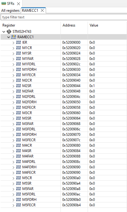

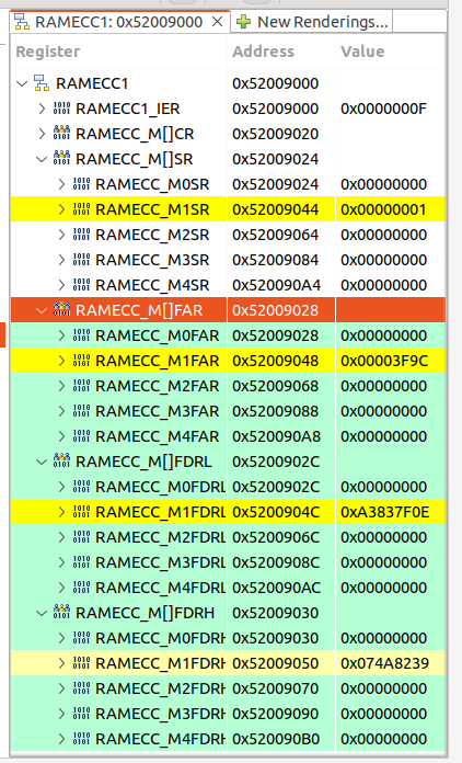

That does not really work out. I got the following notification (on STM32H753AII):
RAMECC1_M1SR (0x52009044) = 3 (Single and double ECC error)
OK, so this is D1 monitor 2 which belongs to ITCM. Should be a 64-bit bus.
RAMECC1_M1FAR (0x52009044) = 0x3ffd
RAMECC1_M1FDRL (0x52009048) = 0x152f2fef
RAMECC1_M1FDRH (0x52009044) = 0xa9ebe8f8
ITCM base address is 0x00000000.

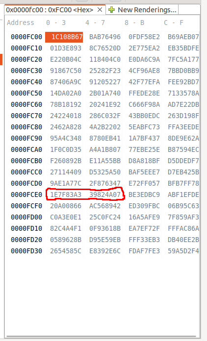

Failing address is supposed to be 0x00000000 + (0x3ffd * 8 ) = 0x01ffe8.
There is nothing mapped to this address; naively writing the data there results in HardFault.
Shall I mask the address register first to a few lower bits? (Since the maximum size is 64k, and scaling factor is 8, only the lower 13 bits could possibly be set for a valid address.)
Indeed, if I just mask the FAR content like described, I get 0x1ffd to work with which results in memory address 0x0FFE8. The content there in the Memory monitor matches the provided Data Register content.
Is it safe to just mask it like this? Are the FAR higher bits don't care or do they carry additional information?

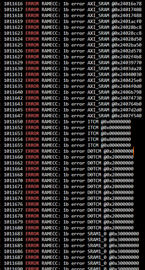

theHolgi
Associate II
@KORourke Now I know what the "interleaved" means.
For DTCM, it's not that the two RAM blocks are put one after another, like it is the case for D2 SRAM.
They are interwoven, i.e. we have a 64-bit bus but accessing two 32-bit units of RAM (of 64 kB = 16 kWords each) simultaneously. So for address calculation you multiply the FAR content by 8, but being a 32-bit monitor, each unit will only provide you data in the FDRL register.
DTCM ramRAMECC1_Monitor3
(0x52009060)
DTCM ramRAMECC1_Monitor4
(0x52009080)
0x20000000FAR == 00x20000004FAR == 0
0x20000008FAR == 10x2000000AFAR == 1
0x20000010FAR == 20x20000014FAR == 2

The ECC interrupt occurs; scanning the state registers reveals a 1 at address 0x52009044 (single bit failure).
This belongs to D1 domain (RAMECC1) monitor 2 (address offset 0x40), which is, according to RM0433 Table 11, assigned to ITCM-RAM which is 64 bit.
FAR at 0x52009048 reveals 0x3F9C.
RAM address = ITCM base + (8 * FAR) = 0x00000000 + (8 * 0x3F9C) = 0x001FCE0
This is an invalid address. The last valid address of ITCM would be 0x0000FFFF.
On the other hand, assuming that only 13 bits of FAR can possibly be valid, the content would be 0x1F9C which results in RAM address 0x0000FCE0, which fits pretty well when comparing the content of the two failing data registers and the observed RAM content from Memory monitor.Bildschirmfoto vom 2024-07-06 21-44-39.png
So the question still is, why is there sometimes a stray extra bit set. (I've never observed it at a higher position).
But obviously it can just be ignored. I have not yet observed this behavior for any other monitor than ITCM, actually.

From which IDE does this screenshot come from? And which version of the tool? On which OS?
Which debugger do you use? (I've found a picture of STM32CubeIDE on MacOS with JLink displaying the SFRs in the memory view: from this I would guess that you are using JLink, right?)
I don't have this view with STM32CubeIDE version 1.16.0 and STLink-V3 debugger. I have a separate SFR registers view as shown in the picture below.
2024-07-12 19_02_02-.png There is no RAMECC_M0xx registers; it starts with RAMECC_M1xx for monitor 1.
It seems there is a shift in your view, with the values of monitor 1 displayed with the addresses of monitor 2.
Moreover, the RAMECC_M1FDRL = 0xA3837F0E. In memory, the value at @0x0000FCE0 is 0xA3837F1E, which is a bit different.
Have you verified that you don't find the content of the FDRL and FDRH registers in AXI SRAM?

About the difference between FDR and memory view, that's actually kind of interesting since with the single ECC error that is signaled, the content should still be unambiguous even on a second reading, which the debugger connection will do.
My overall imression is that the hardware will not like multiple reads on failing memory, or follow-up errors on a different address (the memory view reads a fairly large section of uninitialized RAM), and therefore I am generous about 1 bit difference to the expected value.
I would make sure to NOT have any memory view open before you reach the fault handler and have written down the peripheral's registers, and then trust the memory view only for plausibility cross-reference.

     We had a chance to put STM32H743 under proton single event test, using ~200MeV proton beam.
Because there is NO official documentation on how to "write back the corrected data" and offering a code example, we basically adopt the code of @theHolgi in the previous reply. We read the whole RAM except for ETMRAM, and logout the the falling address if callback triggers. In the callback, data writeback using the data contained in the RAMECC_MxFDRL/H (we suppose it is the CORRECTED data to writeback, even though it is called falling data register).
   We have observed something really bizzare, a typical example is here:
Basically, AXI RAMECC works as expeced. However, for other RAMs, it always report the first address as failing address. Moreover, in the main loop we also check if the RAM is the same as the predefined data, in case RAMECC fails to trigger. Amazingly, the software RAM check only found two times of dismatch during the whole test.
To sum up, if the RAMECC is working properly, it shows that except AXI RAM, all other SRAMs only fail at the initial address, even though it triggers many multiple times all at once. This is something unbelievable. We would like someone to offer a deeper explanation for this.
