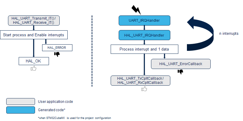

    • HAL_UART_Transmit_IT() / HAL_UART_Receive_IT()
    • with parameters:
      • Pointer to data buffer
      • Amount of data elements to transmit / receive
  • Interrupt Service Routines and Callback functions
    • UART_IRQHandler()
    • HAL_UART_IRQHandler()
    • HAL_UART_TxCpltCallback() / HAL_UART_RxCpltCallback()
The HAL function returns the process status after starting the data processing and enabling the appropriate interruption.
The end of the operation is indicated by a callback function: either transmit / receive complete or error.
The callback functions are declared as weak functions in the driver, with no code to execute. This means that the user can declare the Tx / Rx callback again in the application and customize it to be informed in real-time about the process completion and to execute some application code.

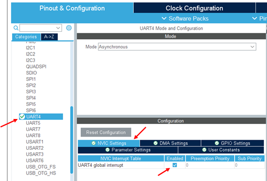

  • When STM32CubeMX is used to generate the project, the UART interrupt is not enabled by default.

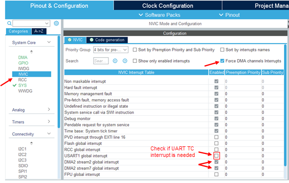

  • In any case, if the UART IRQ doesn't fire, please verify that it has been enabled. In the specific case of STM32CubeMX, verify that the checkmark is there in the NVIC settings to validate the interrupts as shown on the screenshot below.

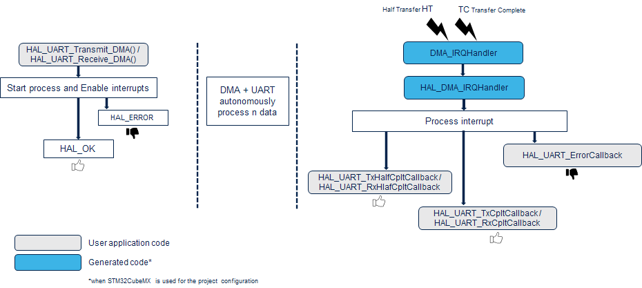

    • HAL_UART_Transmit_DMA() / HAL_UART_Receive_DMA()
    • with parameters:
    • DMA_IRQHandler()
    • HAL_DMA_IRQHandler()
    • HAL_UART_TxHalfCpltCallback() / HAL_UART_RxHalfCpltCallback()
The principle is the same as in interrupt mode except that the DMA manages the data buffer transmission entirely. It continuously uses the data buffer to copy data to / from the USART data register until the DMA counter reaches 0.
When the DMA HT (half transfer) or TC (transfer complete) interrupt occurs, the UART half transfer callback or the transfer complete callback is called. Like in interrupt mode, the weak default callback executes no code. It can be declared and customized in the application.

  • When STM32CubeMX is used to generate the project, the UART interrupt is not enabled by default. If HAL_UART_TxCpltCallback is used in normal buffer mode, the UART interrupt must be enabled.
  • In any case, if the DMA IRQ doesn't fire, please verify that it has been enabled. In the specific case of STM32CubeMX, the checkmark should be there in the NVIC settings to validate the default behavior as shown on the screenshot below.
  • In any case, if the HAL_UART_TxCpltCallback is not called and normal buffer mode is used, please verify that the UART interrupt has been enabled and that the UART_IRQHandler has been implemented. In the specific case of STM32CubeMX, the checkmark should be there in the NVIC settings to validate the UART interrupts as shown on the screenshot below.

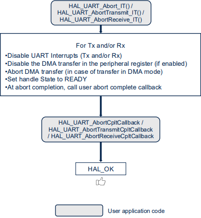

  • Basic Abort functions
    • HAL_UART_Abort() / HAL_UART_AbortTransmit() / HAL_UART_AbortReceive()
If necessary, a callback can be called to execute some user application code.
  • Abort functions with callbacks
    • HAL_UART_Abort_IT() / HAL_UART_AbortTransmit_IT() / HAL_UART_AbortReceive_IT()
  • Callback functions
    • HAL_UART_AbortCpltCallback / HAL_UART_AbortTransmitCpltCallback / HAL_UART_AbortReceiveCpltCallback
