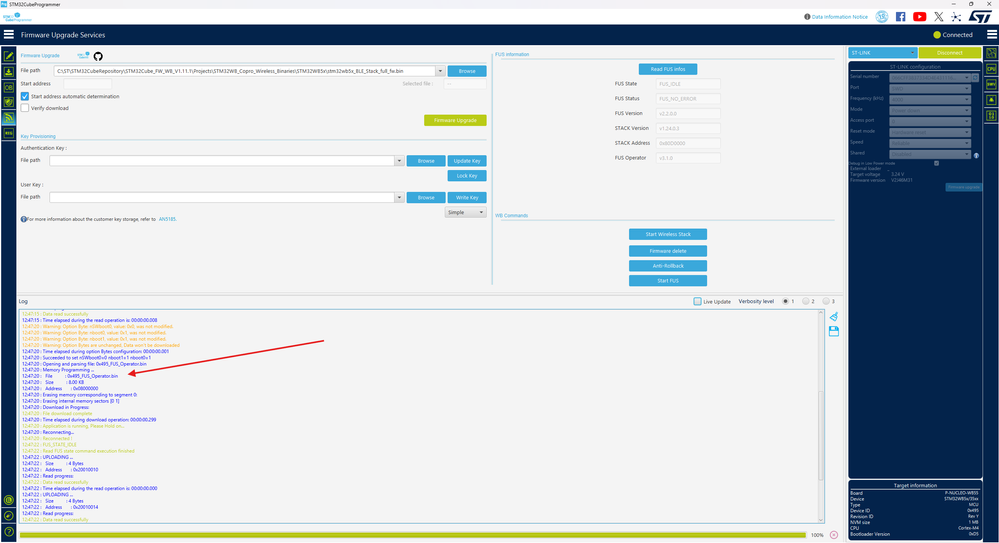

When using STM32CubeProgrammer to perform FUS operations via an SWD connection, an embedded firmware known as the FUS Operator is flashed onto the M4 Core of the STM32WB.
This FUS Operator is an embedded application used to handle communication between STM32CubeProgrammer and the M0+ Core of the STM32WB. It manages any FUS operations such as reading of the FUS state, upgrading the FUS or wireless stack, or deleting the existing wireless stack.
This means that any firmware present on the M4 Core is overwritten by the FUS operator and will need to be reflashed after completing FUS operations.
