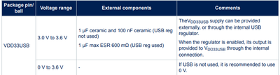

I'm designing a board with an STM32H7R3 device. This snippet from Table 4 in AN5935 recommends using 0V if the USB is not used, which seems to contradict the advice here. Which would you recommend I follow?
FBL
Hi @lelelele
For STM32H7RS, when USB is not used, we don't have a particular constraint. User can connect VDD33USB to 0V to minimize any possible leakage. We are updating the FAQ to add this as a note.
