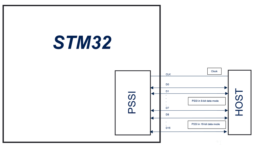

  • Parallel synchronous slave interface.
What the PSSI interface is?
  • A generic synchronous 8/16-bit parallel data input/output slave interface that can send or receive high-speed data flows.
  • It consists of up to 16 data lines plus a clock line. The clock polarity can be configured so that data can be captured or transmitted on either the clock rising or falling edge.

The PSSI interface is:
  • Generic
  • Fast
  • it can only operate in slave mode so a clock must be provided from the master
  • Able to go upward in terms of frequency

The PSSI peripheral main features are the following:
  • 8-bit or 16-bit parallel data input or output
  • 32-byte FIFO
  • DMA capability
  • Data enable alternate function input and ready alternate function output.
