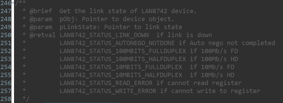

In the PHY library (lan8742.h), the LAN8742_GetLinkState function is utilized to check the state of the PHY device specified in the parameters. As illustrated below, this function returns status codes that indicate the link status. It informs us if the link is up or down, the result of the autonegotiation process, and the selected speed and duplex settings. Additionally, it could signal if an error occurred during the read/write process to or from the registers.

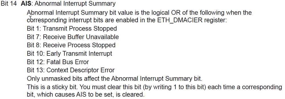

During each interrupt routine, the application reads the status register to determine the current status of the DMA. This status can be found in the ETH_DMACSR register, which provides information on whether the transmit or receive process has been completed or if it has been halted due to an error. The types of errors that can be detected include unavailable receive or transmit buffers (RBU/TBU), context descriptor errors (CDE), or even fatal bus errors.
