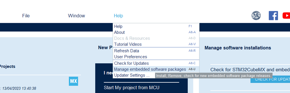

With STM32CubeMX downloaded, you can install the relevant packages by selecting help -> manage embedded software packages. 1 Manage embedded software packages.png

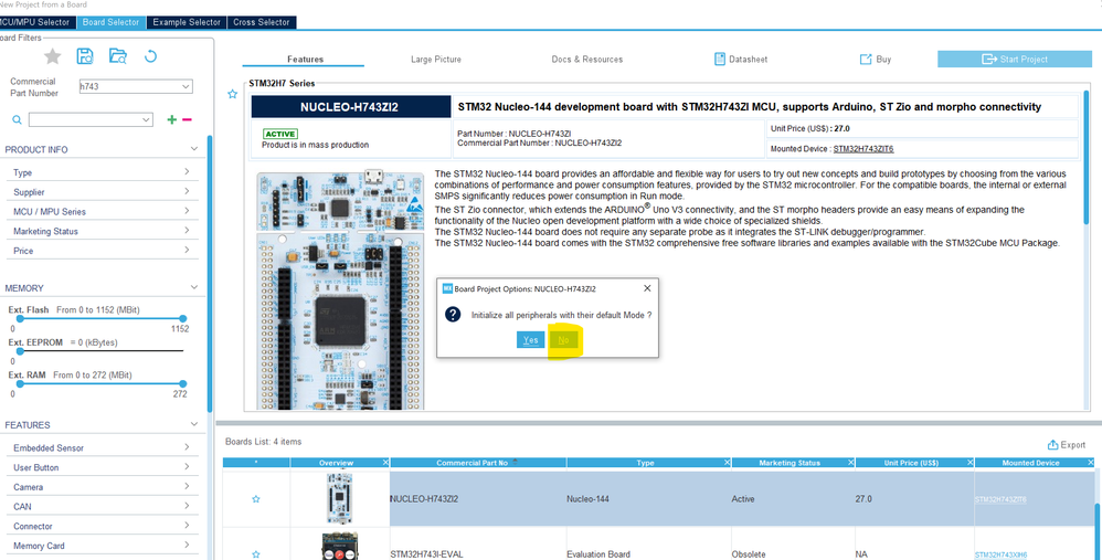

For this project, we start from the board selector, so, click ACCESS TO BOARD SELECTOR:
And find the NUCLEO-H743ZI:
When prompted, select no to initialize all peripherals with their default modes.

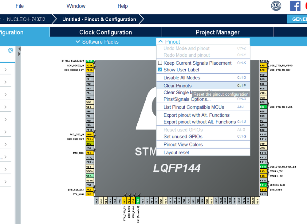

Once in the pinout configuration, to give us a blank slate, select pinout->Clear pinout.

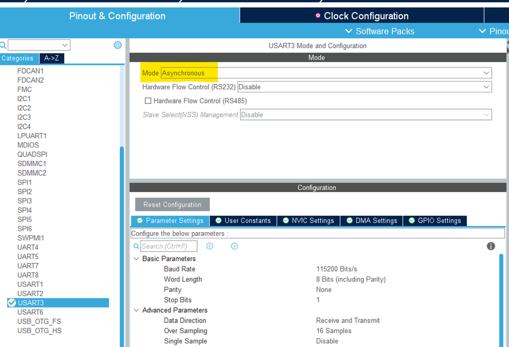

UART Configuration
First, we set up a UART that is connected to the onboard STLINK. This is used for printing the IPv6/IPv4 addresses, and to indicate to us the state of the application.
Select USART3 and set the mode to asynchronous. The default configurations for the peripheral are already what we want:

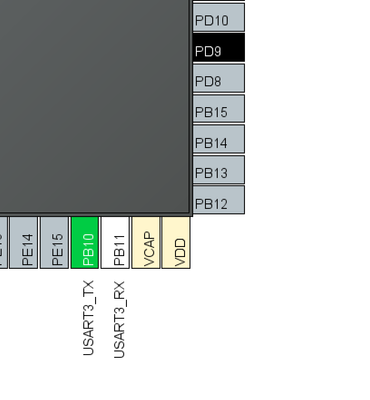

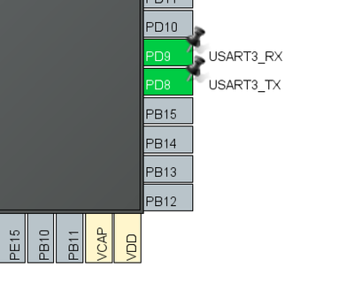

We need to move the GPIOs to connect them to the onboard STLINK. In the GUI, you can CTRL+click and drag the pins to reassign them.
USART3_RX -> PD9
USART3_TX ->PD8

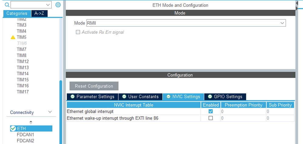

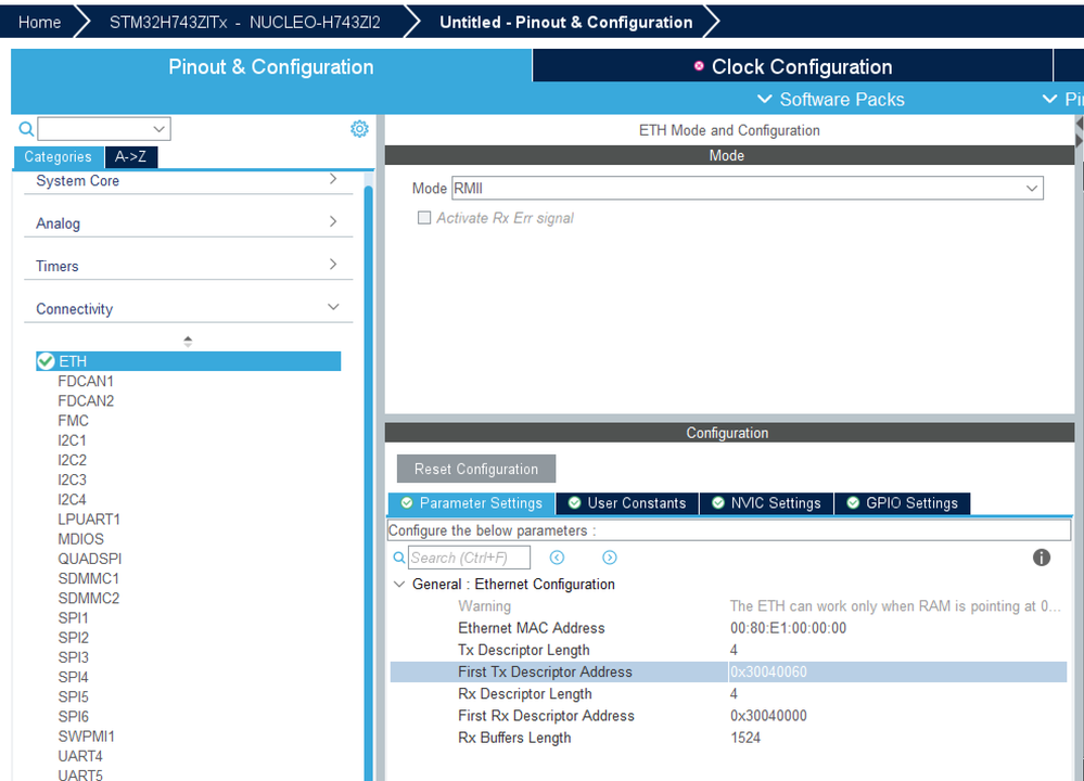

Ethernet Configuration
First, select the ETH peripheral, and enable it as an RMII interface, which is used on this board. We also need to modify the default addresses for the Ethernet descriptors. By default, it locates the descriptors in 0x30000000, which is SRAM1. The descriptors can be placed flexibly, but I prefer to place them, in SRAM3 located at 0x30040000, clear out of the way of any other RAM that you may use.

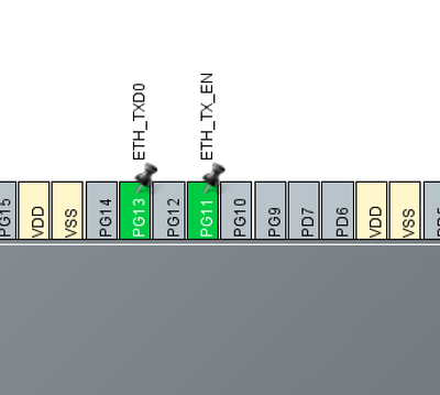

We need to change around some of the GPIOs for the ETH to reflect the board layout as well using CTRL+click and drag to the correct pins.
ETH_TXD0 -> PG13
ETH_TX_EN -> PG11

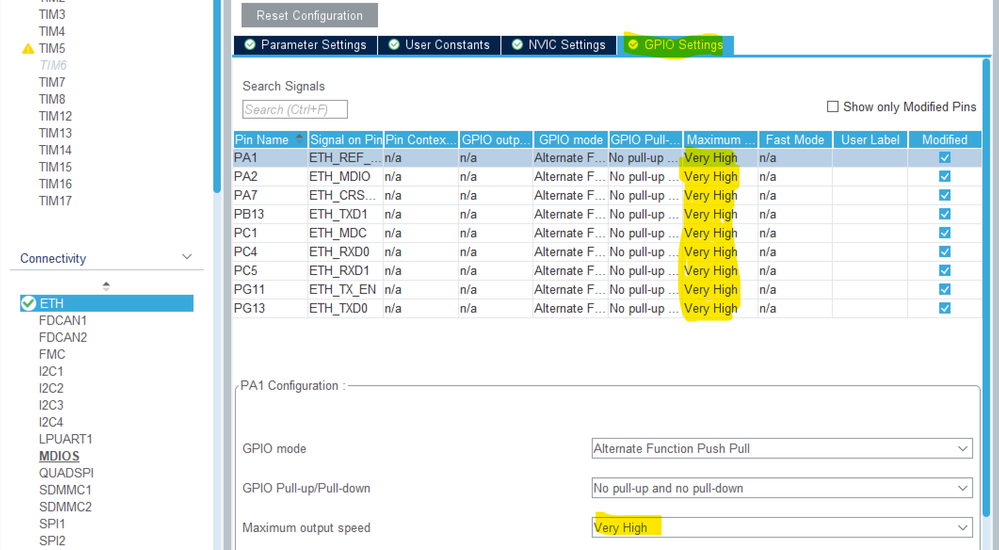

Next, in ETH GPIO settings, make sure all GPIOs are set to very High speed:
In the NVIC tab, enable the global Ethernet interrupt:

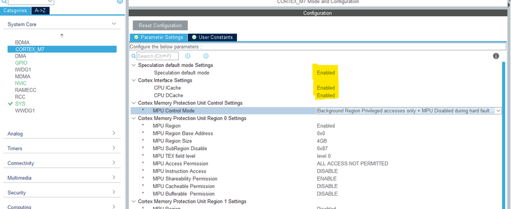

MPU configuration
Since the ETH peripheral on the H7 requires that CACHE be enabled, we also need to enable the MPU (memory protection unit.) This ensures that the CACHE does not mess with the descriptors and receive buffers for the Ethernet.
The MPU configurations can be found in the CORTEX_M7 category under system core.
First, we want to enable ICAHCE and DCACHE, and set speculation default mode to enabled. Doing so creates a default configuration for MPU region 0, which covers the entire 4GB address space of the core with ALL ACCESS NOT PERMITTED. This gives a default configuration as a safety net, and now any subsequent configurations of MPU regions allows us to set the configurations for specific regions. When two MPU regions have overlapping addresses, the higher numbered region overwrites the configurations of the lower numbered regions for the address range that is configured in that higher numbered region.

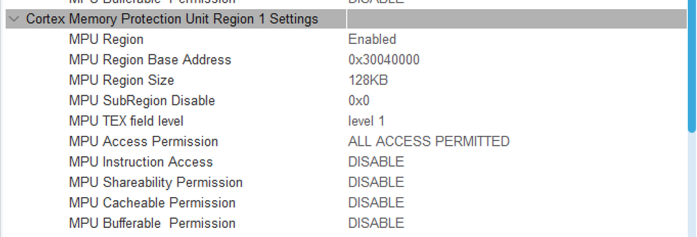

With that said, we configure region 1 to manage the access to the Ethernet descriptors and receive buffer. In this case, we want to ensure that the MPU has full access to the area. We adjust the TEX field level to level 1 to indicate that it is a shareable device, but we do not want the region to be cacheable. The region size here is set to 128KB to ensure that we are covering all the receive buffers. Should you want to be more efficient you can likely get away with configuring the region to be smaller than this:

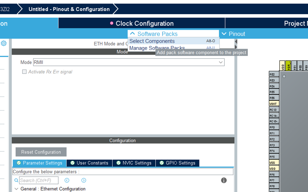

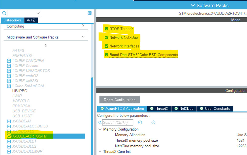

With the Ethernet configured, we can bring Azure NetXDuo into the project. Near the top of the application, you select software packs -> select components:
Assuming that the X-CUBE-AZRTOS-H7 package is installed, it should be selectable as a drop-down in this menu.

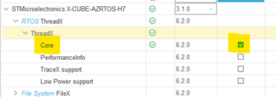

As is the case with all the components in the Azure package, they rely on the use of the Azure RTOS: ThreadX, so we need to activate this:

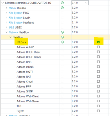

And activate NetXDuo core:

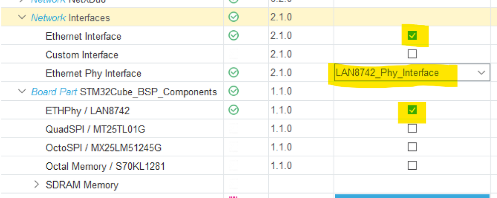

Lastly, we need to make sure the package is aware of what hardware driver and interface it needs to use for the PHY layer:
Under middlewares and software packages, we need to select the Azure H7 middleware, and be sure to enable all components previously selected:

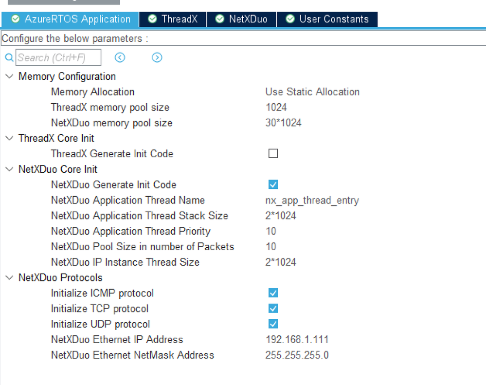

In the AzureRTOS application tab, I prefer to change my NetXDuo memory pool size to 30K to give myself more wiggle room on allocating packets and increase the stack sizes. I also prefer to change the IPv4 address to something more distinctive, but most of these parameters are flexible depending on the specific needs and constraints of your application:

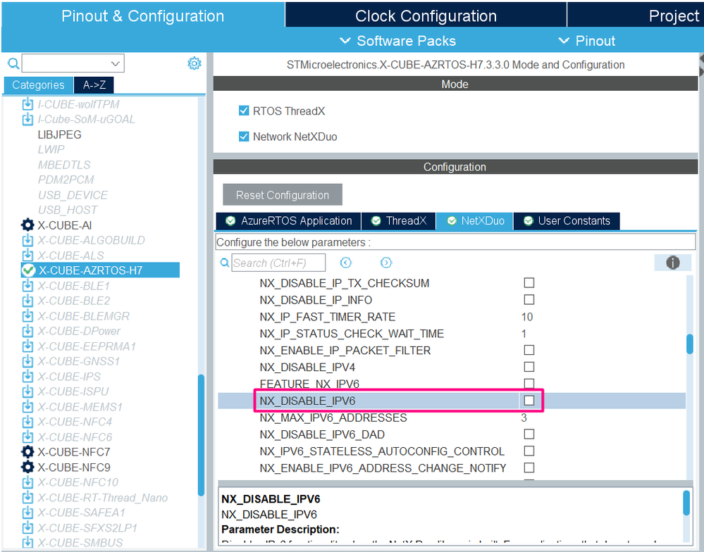

Since we intend to use IPv6 in the application, we need to enable it in the NetXDuo tab. Enabling this feature effects the code of creating a define which uses preprocessors to allow for compilation of all IPv6 related code. By using only IPv4, you decrease the memory footprint of the NetXDuo library (uncheck NX_DISABLE_IPV6):

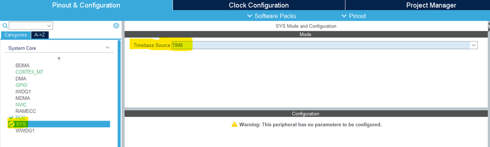

Changing System Time Base to Accommodate ThreadX
When using an RTOS, the RTOS is configured by default to use the SysTick timer for managing the timing of its threads. Since the default configuration for the HAL libraries is to also use the SysTick for its timing operations, we need to change the timebase for the system. Allow only ThreadX alone to use the SysTick. In SYS, change the timebase source to TIM6.

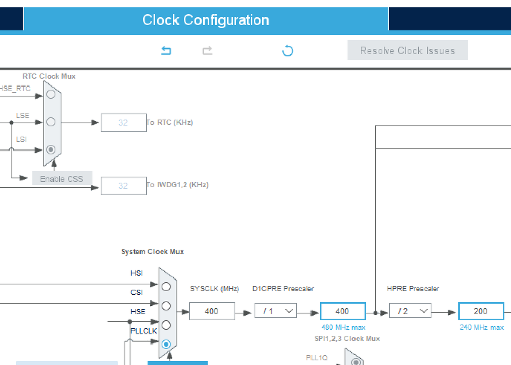

Clock Configuration

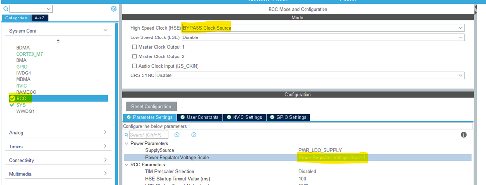

The last thing we need to do is configure the clock. Before we go to the clock configuration tab, we must change the RCC settings. This Nucleo board sources a high accuracy reference 8MHz clock from the clock output of the STLINK, so we set the HSE to BYPASS clock source. When working with Ethernet applications, it is recommended to use some sort of stable and accurate, external high-speed oscillator, typically a quartz oscillator as opposed to the internal high-speed oscillator.
We also want to set the voltage scale to scale 1 to allow up to 400MHz core system clock frequency:

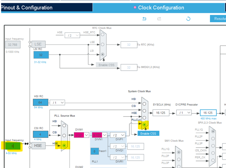

Now, open the clock configuration tab. Set the HSE frequency to 8MHz, select HSE as the PLL source, and PLL output as the system clock source:
Then enter 400 into the box for the system clock speed, and it should automatically change the PLL settings to achieve 400MHz with your selected sources:

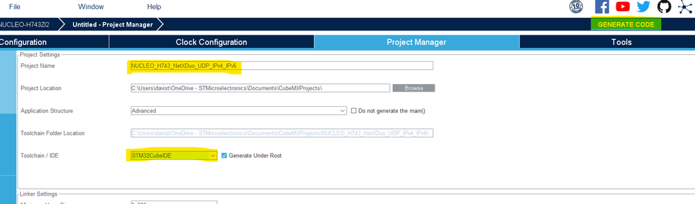

That is it for the STM32CubeMX configuration. Navigate to the project manager tab, give your project a name, and generate code for STM32CubeIDE:

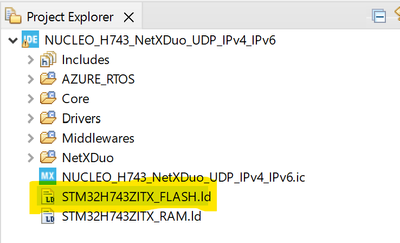

Linker File

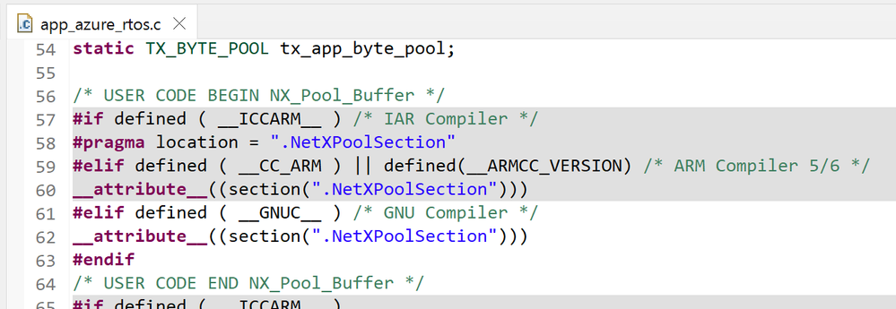

Before moving onto the application level code, we must add some code to the linker file. Because the Ethernet descriptors and NetX memory pool to be located in a specific memory address range, we need to make sure the linker reflects this. The default generated linker does not account for our specific configurations. First, open the linker file STM32H743ZITX_FLASH.ld

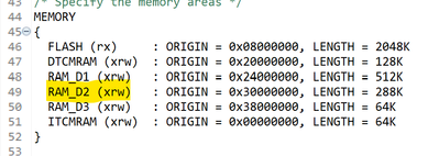

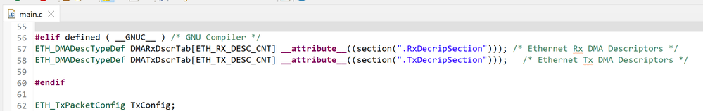

By default, the linker already has a definition for the RAM in which our descriptors and Ethernet receive buffers will live:
For the next step, we need to add a new memory section somewhere in the SECTIONS brackets in the linker. This article was made by using the STM32CubeMX version 6.8.1. In versions before 6.13.0 the code was generated with typos (RxDecripSection instead of RxDescripSection, and the same for the TX). These typos were corrected in the new STM32CubeMX releases (6.13.0 onwards). Therefore, at this point, refer to the variables DMARxDscrTab and DMATxDscrTab declared at the beginning of main.c to see the correct name for your sections.
STM32CubeMX versions before v6.13.0:
STM32CubeMX versions v6.13.0 onwards:
For STM32CubeMX versions before v6.13.0 add the following sections:
.tcp_sec (NOLOAD) :
    . = ABSOLUTE(0x30040000);
    *(.RxDecripSection)
    . = ABSOLUTE(0x30040060);
    *(.TxDecripSection)
    . = ABSOLUTE(0x30040200);
    *(.NetXPoolSection)
  } >RAM_D2 AT> FLASH
For STM32CubeMX updated versions (v6.13.0 onwards):
.tcp_sec (NOLOAD) :
    *(.RxDescripSection)
    *(.TxDescripSection)
    *(.NetXPoolSection)
  } >RAM_D2 AT> FLASH
The section is placed in RAM_D2, but specifically places in the aforementioned SRAM3 that we intended. These sections are named specifically to work with code that generated by STM32CubeMX that attempts to assign buffers to Linker sections using attributes, but the necessary code is not in the linker by default. Here are the relevant snippets:

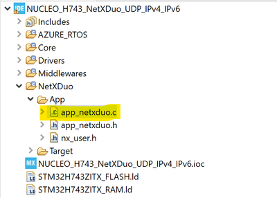

Application Level Code
First, in main.c, lets add the code that allows us to use the printf function with our USART virtual com port. In main.c, user code begin 0 section:
/* USER CODE BEGIN 0 */
int __io_putchar(int ch)
  /* Place your implementation of fputc here */
  /* e.g. write a character to the USART1 and Loop until the end of transmission */
  HAL_UART_Transmit(&huart3, (uint8_t *)&ch, 1, 0xFFFF);
  return ch;
/* USER CODE END 0 */
Finally, we can add the code which actually creates the UDP socket and receives a message. Since NetXDuo is designed to work with ThreadX, the generated code has already set up a framework to create an entry task for your NetXDuo application. In main.c, CubeMX has already generated code that, calls a function to initialize ThreadX and NetXDuo. After execution starts, you will eventually end up in the file app_netxduo.c, the function MX_NetXDuo_Init. This is the function that initializes the IPv4 and creates the entry thread for the NetXDuo app. This file is where we add our relevant application code.

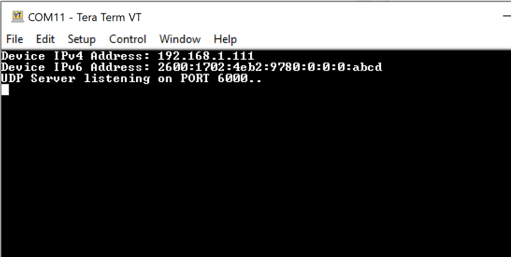

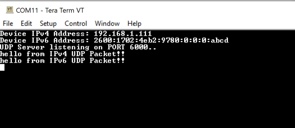

It prints out both preconfigured static IPv4 and IPv6 address on the COM port. In addition, creates a UDP socket and binds it to port 6000. Finally, the main loop continuously waits for packets and prints them out on the COM port.
At this point, the project is ready to run. Connect the NUCLEO-H743ZI to your PC, and click the debug symbol in STM32CubeIDE, keep debug configurations at default.
Testing the Application
Setting up Tera Term

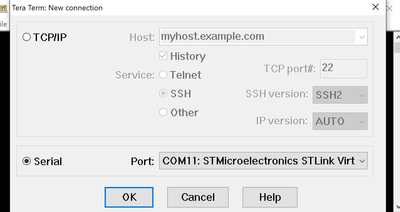

With the board plugged in, Tera Term should recognize the STLINK virtual com port. Select it an OK:

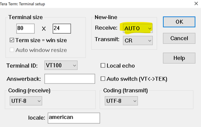

Now in setup->terminal, New-Line receive to AUTO and hit OK

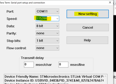

And setup->serial port, set the baud rate to 115200 and hit New Setting:

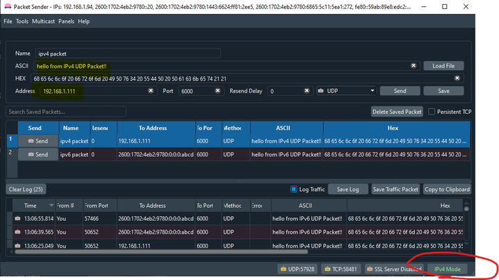

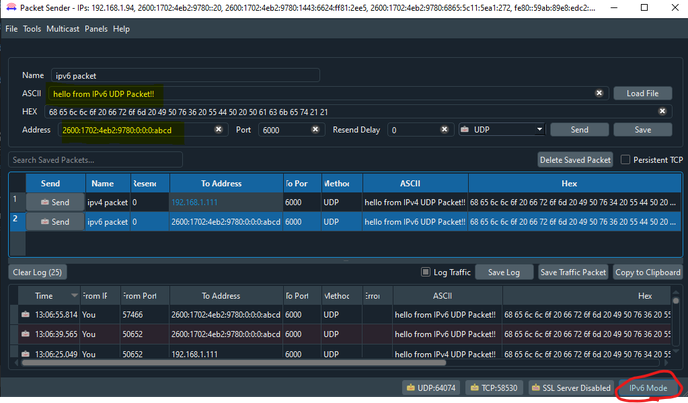

Send UDP messages to H743 with packet sender
For testing, I am using an application called packet sender. It supports sending UDP messages over both IPv4 and IPv6.
https://packetsender.com/

With the board hooked up to the router, plugged into a PC via USB, and Tera Term configured, if you reset the board, you should see the IPv4 address, IPv6 address, and UDP port printed on Tera Term:
In the packet sender we can configure the UDP packet to reflect these parameters, send the packets over the network, and see the messages print out on the terminal:

Important thing to note, there is inconsistency across the auto generate code for the boards. For the H743, thh section is auto named '
RxDecripSection
TxDecripSection
however, in the H753zi its:
RxDescripSection
RxDescripSection
So, if you are following this tutorial, ensure you update the spelling to match when adding the .tcp_sec to the linker script. That missing 's' was a nightmare to discovery :)

Hello @potatobandit ,
We corrected the typos in the names of the memory sections, moving from RxDecripSection/TxDecripSection to RxDescripSection/TxDescripSection on STM32CubeMX v6.13.0. So, if you are using any STM32CubeIDE version higher than v6.13.0 you need to update the section names.
We've updated this article to also be compliant with the new STM32CubeMX release. It's under update and should be public in a few days.
Thank you very much for letting us know about the problem.

Why is the MPU region for the descriptors configured  as not bufferable and not shareable?
