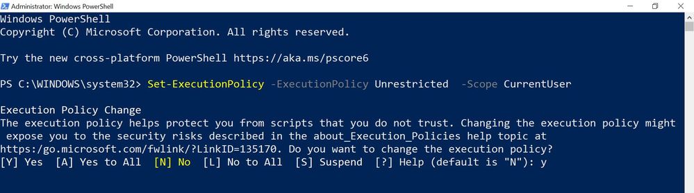

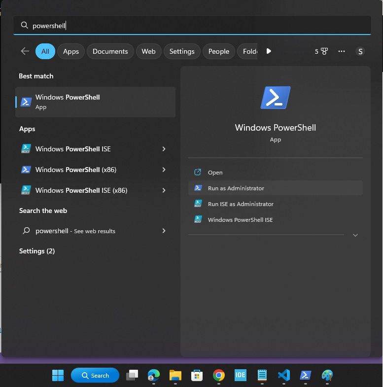

Configure PowerShell:
  1. Open PowerShell
  1. Set execution policy
Set-ExecutionPolicy -ExecutionPolicy Unrestricted  -Scope CurrentUser
  1. Enter ‘y’ to accept the execution policy changes

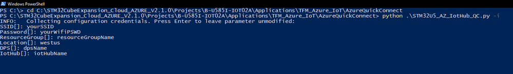

  1. Run the script with -i argument:
Python .\STM32U5_AZ_IotHub_QC.py -i

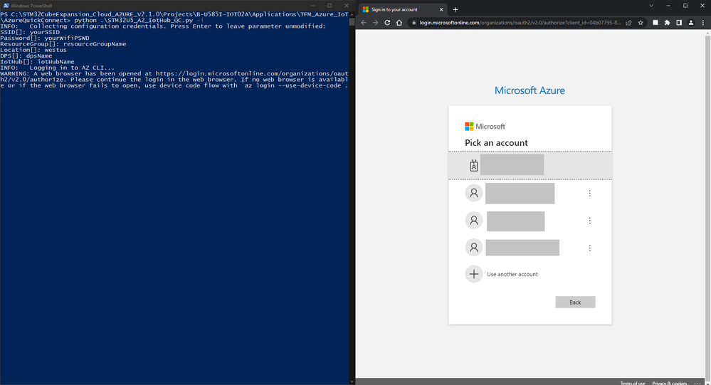

  1. Enter your Configuration Credentials:
  1. Login to your Azure Account:
  1. Monitor Script execution
