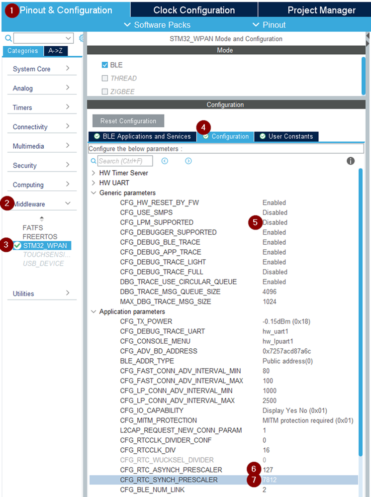

  1. Open its BLE_p2pServer.ioc with CubeMX v6.3.0+.

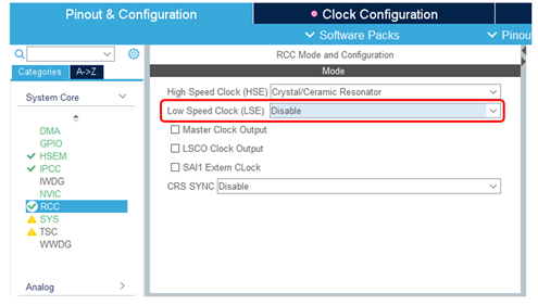

  2. From the “RCC” configuration window, change the LSE mode to “Disable”

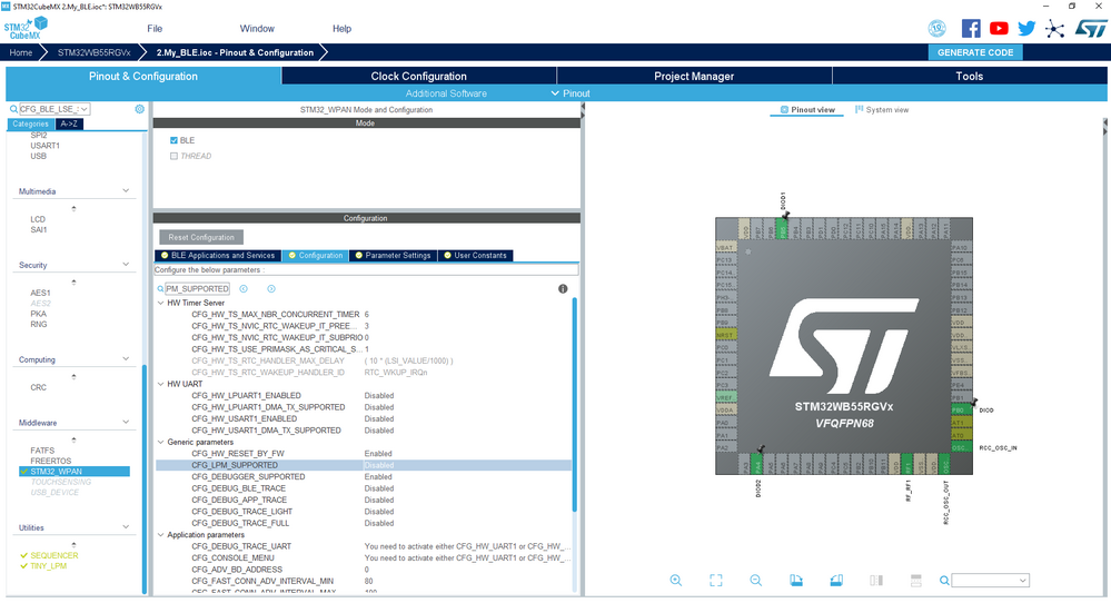

  1. From the “STM32_WPAN” middleware configuration window, go to the “Configuration” tab

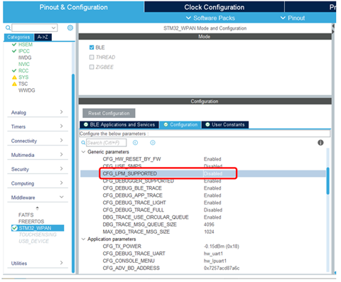

    1. Change the CFG_LPM_SUPPORTED parameter to “Disable”. This disables the low power manager support to keep the system always in Run mode.

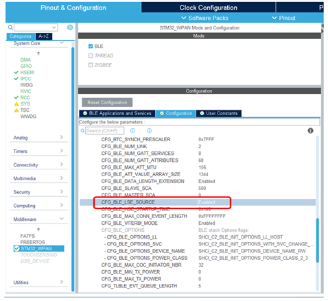

    1. Change the CFG_BLE_LSE_SOURCE parameter to “Enable” to select the extern HSE as the source of the RF wake-up.

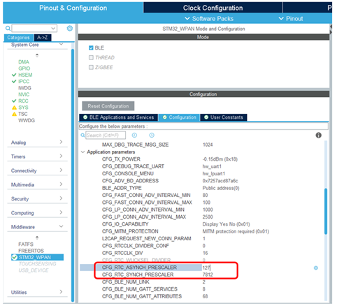

    1. Change the CFG_RTC_ASYNCH_PRESCALER parameter to 127 and CFG_RTC_SYNCH_PRESCALER to 7812 to obtain an internal clock frequency of 1 Hz (ck_spre). This will also keep the same real time base for the Virtual Timer utility (from hw_timerserver.c).

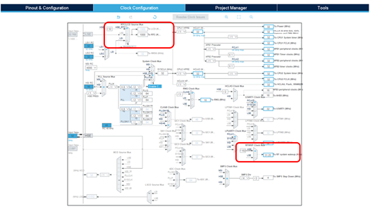

  1. Change the clock tree configuration
    1. Select “HSE_RTC” for the RTC Source Mux
    2. Select “HSE” for the RF system wakeup

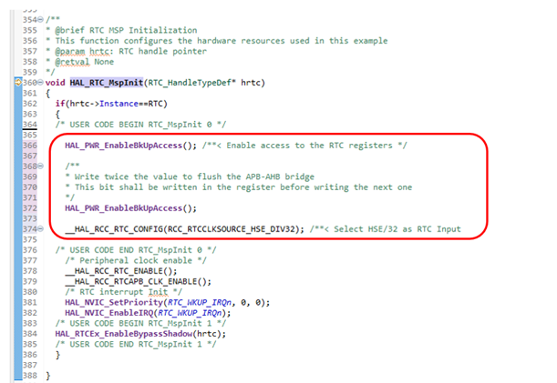

  1. Find stm32wbxx_hal_msp.c and add the following lines of code inside HAL_RTC_MspInit().

Can you a little clarity about - CFG_BLE_LSE_SOURCE  and CFG_RTC_ASYNCH_PRESCALER
I don't have this setting in my CubeMX, please see the attached image. Do you know how I can fix it
_legacyfs_online_stmicro_images_0693W00000UnrDBQAZ.png?
gongw
First please use the latest CubeMX v6.6.1 and CubeWBv1.14.1.
Please go down to the middle position of Application parameters by scrolling the lightblue scrollbar
_legacyfs_online_stmicro_images_0693W00000UnsqYQAR.png​Br,
willee​
IRakh.1
Associate III
Hi Laura, thank you for your response, I did your recommendation, but still in my CubeMX don't have settings for CFG_BLE_LSE_SOURCE
if I correctly understand I can use the command in the code to fix it, how do you think?
#define CFG_BLE_LSE_SOURCE 1
and CubeWBv1.14.1 is it only examples of code, not more, yes?
gongw

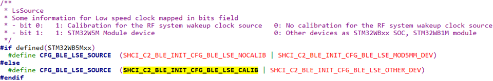

For settings for CFG_BLE_LSE_SOURCE, you need to modify CFG_BLE_LSE_SOURCE as below after generated code.
Br,
willee
