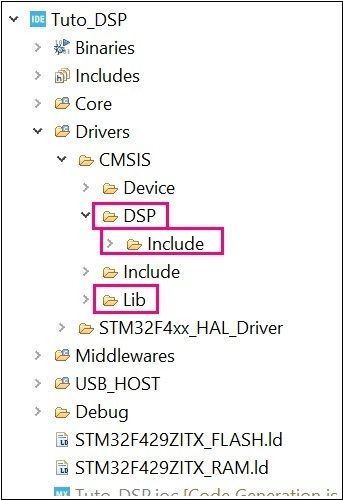

Here are the steps to follow to copy the DSP drivers into the project:
  1. Support DSP in the project workspace
  • In the generated project, create a folder under ..\Drivers\CMSIS named DSP.
  • Copy <STM32Cube_Repository>\STM32Cube_FW_F4_V.X.XX.X\Drivers\CMSIS\DSP\Include and paste in in the created folder
  •  Copy <STM32Cube_Repository>\STM32Cube_FW_F4_V.X.XX.X\Drivers\CMSIS\Lib and paste it under ..\Drivers\CMSIS.
After being copied and refreshing the project, the added folders appear automatically in the STM32CubeIDE workspace:

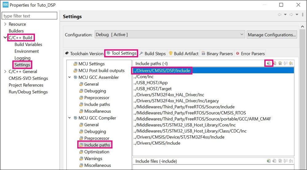

           ii. Include paths
The purpose of this part is to describe the steps to follow in order to support new header files:
  • Select the project from the Project Explorer section
  • From Project menu or File menu, go to Project properties > C/C++ Build >
Settings > Tool Settings > MCU GCC Compiler > Include paths.
  • Click on “Add” to include the new paths.
  • Add ../Drivers/CMSIS/DSP/Include path

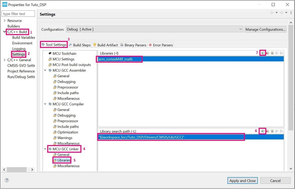

The first step is to add the libraries' path in the project settings:
  • Select the project from the Project Explorer section, then from Project menu or File menu, go to Properties > C/C++ Build > Settings > Tool Settings > MCU CGC Linker > Libraries > Library search Path > Add.
  • Select the GCC library present in the workspace path: ../Drivers/CMSIS/Lib/GCC.
  • Now, to add the specific library to work with, select the project from the Project Explorer section.
  • From Project menu or File menu, go to Properties > C/C++ Build > Settings > Tool Settings > MCU CGC Linker > Libraries > Libraries (-l) > Add and insert the following library: "arm_cortexM4lf_math".
Warning:
  • Make sure that you are using the “/” and not the “\” in the paths.
  • Do not use “:libarmcortexM4lf_math.a”. This usage is not recommended as it can lead to side-effects in some use cases.
  • Use "arm_cortexM4l_math" with STM32WL series.

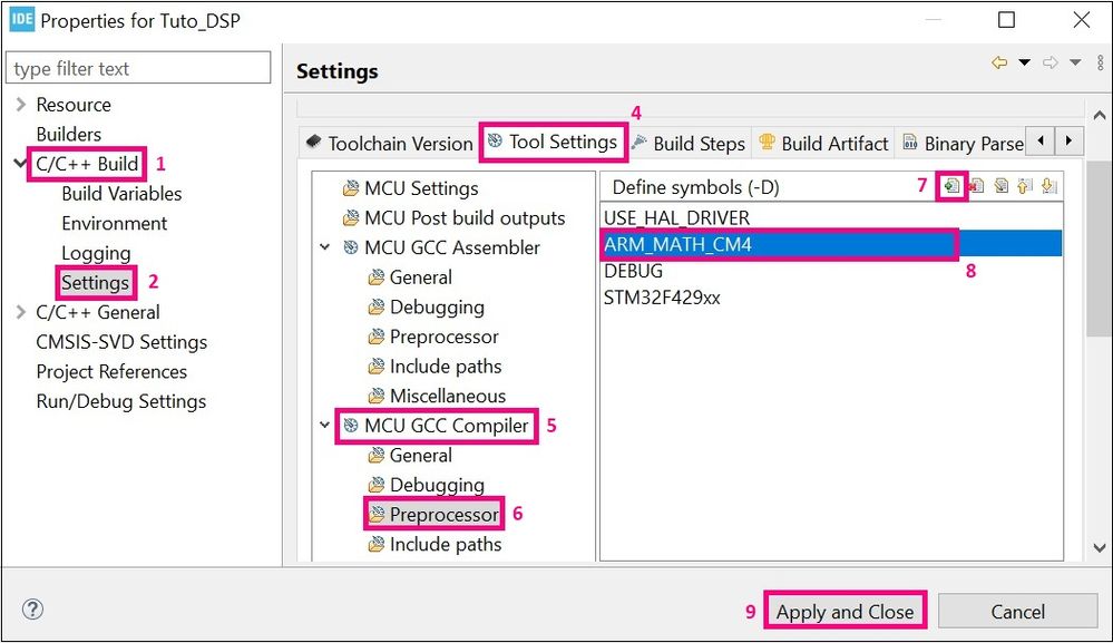

The final step, is to add the “ARM_MATH_CM4” symbol to the project, as presented in the photo below:
 Note:
  Please do not forget that this step depends on the core you are using.
