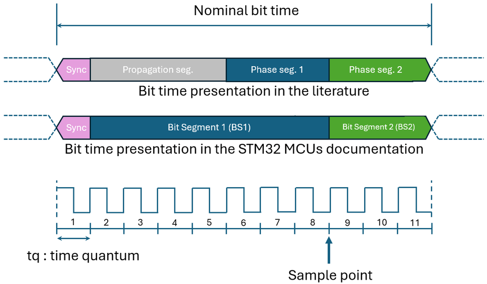

As shown by the figure 1, the CAN bit is divided into several segments. Figure 1 below shows the representation of the CAN bit and its timing described in the literature: Synchronization segment, Phase segment 1 and Phase segment 2 as well as in the CAN bit and its timing in the STM32 documentation which are the Synchronization segment, Bit segment 1 (BS1), and Bit segment 2 (BS2).
  Figure 1. The CAN bit time

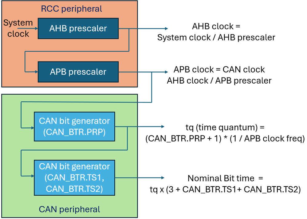

Figure 2 gives a view on how the CAN bit time is generated.
Figure 2. CAN bit time generation on STM32Figure 2. CAN bit time generation on STM32

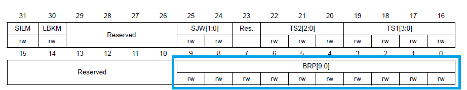

On STM32, the register responsible for the CAN timing is the CAN_BTR register. Refer to the reference manual of the product/section “Controller area network (bxCAN)”.

On STM32, the tq is generated from the APB clock divided by the CAN prescaler (see Figure 2) that needs to be set in the CAN_BTR.BRP field:  .Figure 3. CAN prescaler field in CAN_BTR registerFigure 3. CAN prescaler field in CAN_BTR register

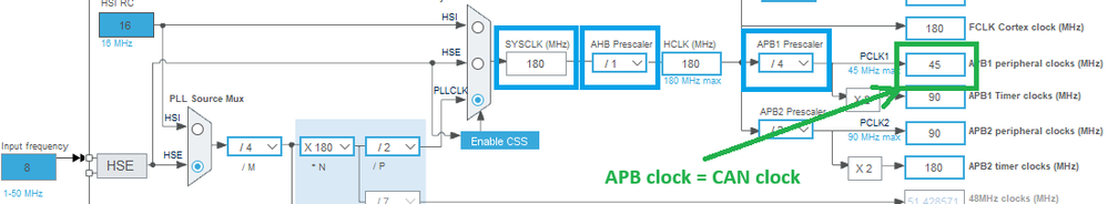

In the case of STM32CubeMX, if we take the STM32F439 MCU as an example, and if the RCC clock configuration is as follows:
Figure 4. RCC clock configuration exampleFigure 4. RCC clock configuration example

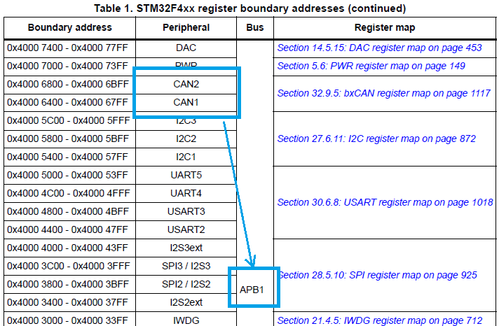

As the CAN instances are located on the APB1 domain, and the CAN clock is generated from the APB1 clock. From the STM32F4xx MCU reference manual (RM0090) we can see:
Figure 6. The CAN instances are located on APB1 domainFigure 6. The CAN instances are located on APB1 domain
That is why APB1 prescaler is used in the tq calculation.

In the STM32 documentation, the propagation segment and Phase segment 1 are merged to form the Bit segment 1 (BS1). See Figure 1.
So, the bit time segment 1 is defined as: tBS1 = tprop_seg + tph_seg1

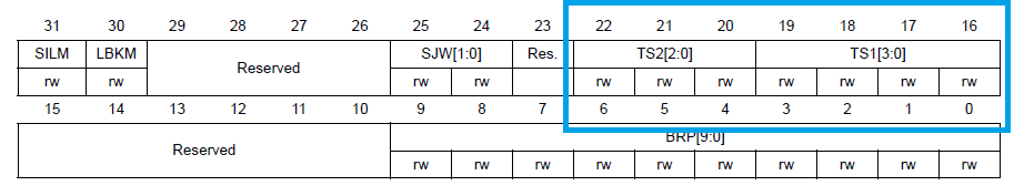

On STM32, the possible values of time quanta (TQ) for BS1 can be set between 1 and 16. For BS2, the TQ can be set between 1 and 8 in the CAN_BTR register. When TS1 or TS2 value is set to 0, it is interpreted as 1TQ.
Figure 7. Time segment 1 and Time segment 2 fields in CAN_BTR registerFigure 7. Time segment 1 and Time segment 2 fields in CAN_BTR register
So, the duration of tBS1 is between 1 x tq and 16 x tq and the duration of tBS2 is between 1 x tq and 8 x tq.
On the STM32, the bit time is defined as follows:
Note, 1 is added to CAN_BTR.TS1 and to CAN_BTR.TS2, 0 is actually corresponding to the value 1*TQ in these fields.
Since the synchronization phase duration is fixed to 1*TQ, the CAN nominal bit time will be (equation 5):

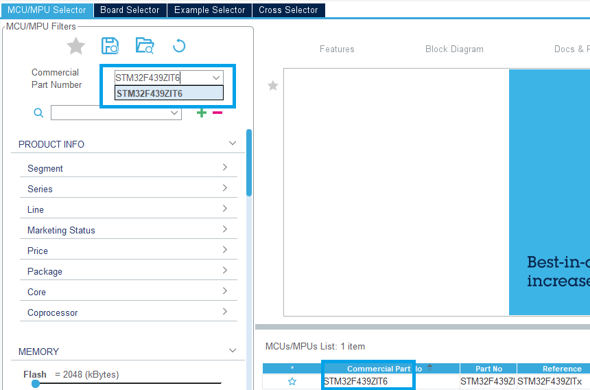

In STM32CubeMX, we start the project from the MCU part number STM32F439ZI (See Figure 8).
Figure 8. STM32F439ZI MCU selection in STM32CubeMXFigure 8. STM32F439ZI MCU selection in STM32CubeMX

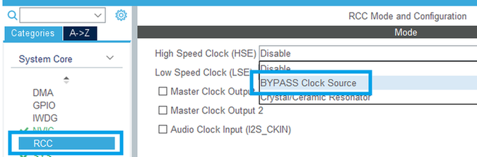

As the STLINK-MCO clock source is used, we need to set the HSE in Bypass mode.
Figure 9. Setting HSE in Bypass mode in STM32CubeMXFigure 9. Setting HSE in Bypass mode in STM32CubeMX

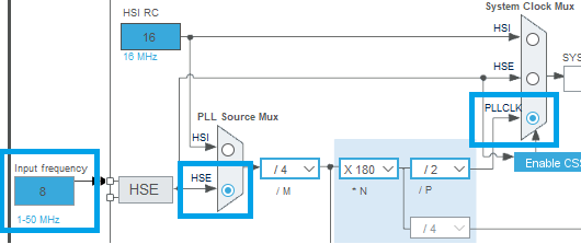

Now, make sure that the input clock is set at 8 MHz. Select HSE as a PLL source and the clock source of the system clock is generated from the PLL as shown in Figure 10.
Figure 10. Configuring the system clock source in STM32CubeMXFigure 10. Configuring the system clock source in STM32CubeMX
If STM32CubeMX shows errors, select them to fix them automatically by the tool according to the system clock frequency you need to use.

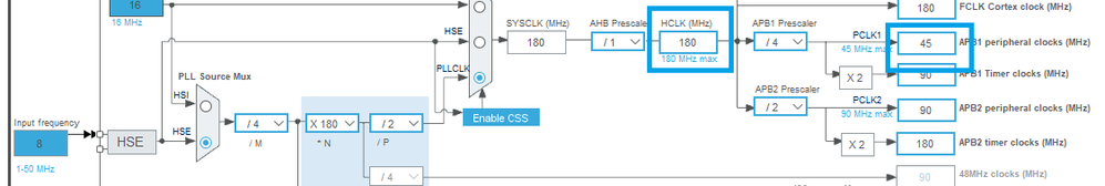

In our case 180 MHz is used as a system clock frequency of the MCU. The APB1 from which the CAN peripheral is clocked, is set to 45 MHz which is its maximum value as indicated in the STM32CubeMX (see Figure 11).
Figure 11. System clock and APB1 clock valuesFigure 11. System clock and APB1 clock values

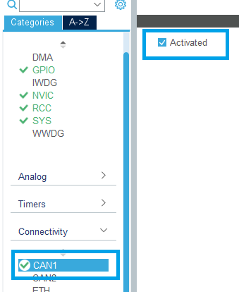

Now, we are going to enable CAN1 by activating it in CAN menu as shown in Figure 12.
Figure 12. Activating CAN1 peripheral in STM32CubeMXFigure 12. Activating CAN1 peripheral in STM32CubeMX

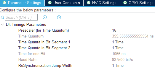

As shown in the Figure 13, the default CAN timing settings are not suitable for our case and need to be updated. The bitrate is set to 937500 bit/s while we need to set it to 500 kbit/s.
Figure 13. Default CAN timings in STM32CubeMXFigure 13. Default CAN timings in STM32CubeMX

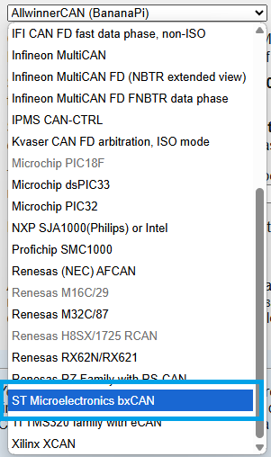

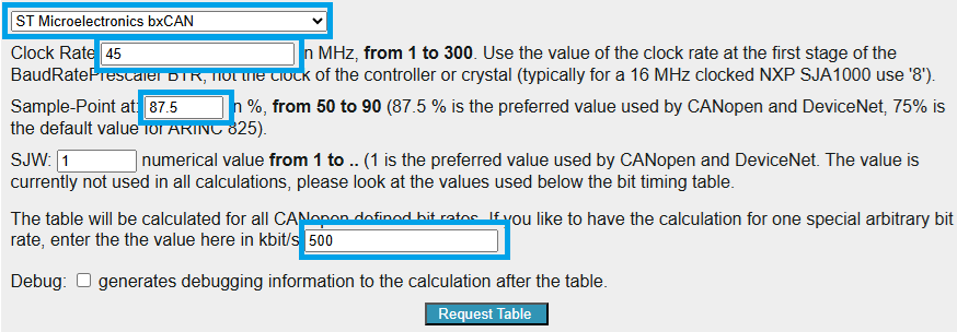

At this stage, we use this CAN bit timing web tool that helps us selecting the recommended values. These values are for the CAN prescaler, Time Quanta in Bit segment 1 (BS1), and the Time Quanta in Bit segment 2 (BS2) based on our needs: CAN bitrate = 500 kbit/s with a simple point set to 87.5% as provided in the table 2.
In the web tool, we start by selecting the version of the CAN to be used. We select “STMicroelectronics bxCAN” as shown in Figure 14.
Figure 14. Selecting the correct CAN versionFigure 14. Selecting the correct CAN version
There is no need to select the CAN clock frequency in MHz. In our case, the CAN clock is the same as APB1 (see Figure 2). As the APB1 clock = 45 MHz (see Figure 11), we put 45 in the “Clock Rate field” as shown in Figure 15.
Figure 15. Putting the CAN clock frequency in MHzFigure 15. Putting the CAN clock frequency in MHz
The default value of the sample point is already set to 87.5% as shown in the Figure 16. We keep that value.
Figure 16. Sample point is already set to 87.5%Figure 16. Sample point is already set to 87.5%
As the CAN bitrate to be used is 500 kbit/s, we need to put 500 as shown in the Figure 17.
Figure 17. CAN bitrate at 500 kb/sFigure 17. CAN bitrate at 500 kb/s
For those who needs to change the SJW value, you can do it over “SJW” field. In our case, we keep the default value = 1.
Figure 18 shows the full picture of the settings in the web tool.
Figure 18. A full picture of the settingsFigure 18. A full picture of the settings

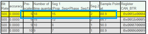

The tool generates a table where it provides many settings with these same CAN bitrates. There are different sample points as it did not find a suitable CAN parameters matching the 87.5% as a sample point. See figure 20.
Figure 20. Generated CAN timing tableFigure 20. Generated CAN timing table
In STM32CubeMX, we set these recommended values in the “Bit timings Parameters” menu as shown in Figure 21.
