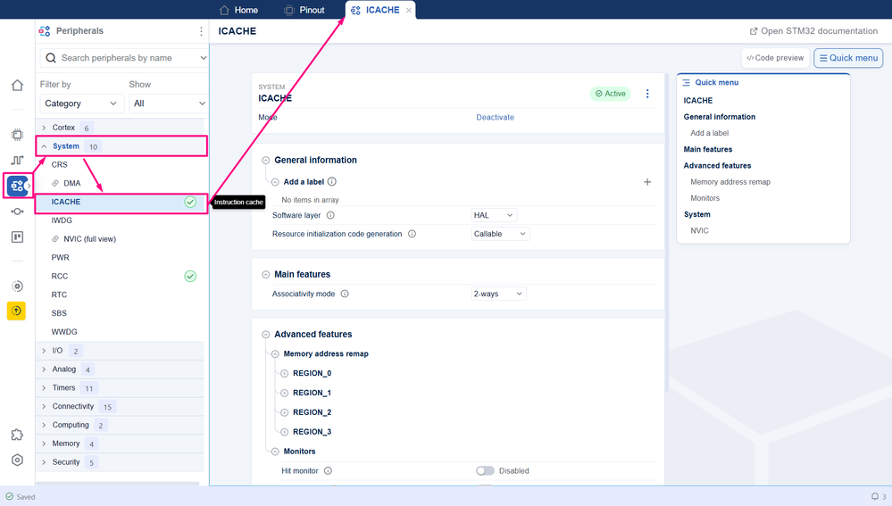

After creating the project, open the "Peripherals" menu and locate "ICACHE" under the System drop-down list.
In this menu, you can view all settings for the ICACHE memory as discussed in the introduction.

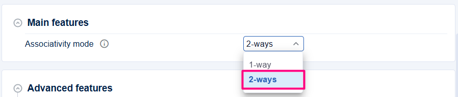

Set the associativity mode. For this example, since power consumption is not a concern, set this to 2-ways.
Next, configure the advanced features. The first configuration is related to memory address remap. This feature is not covered in this article, but it should be used when caching external memory in your application.

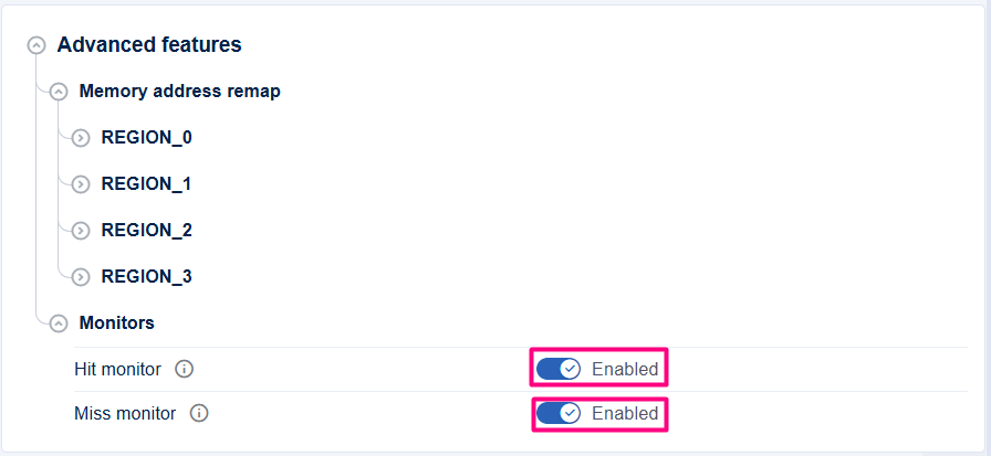

In the advanced features, enable the hit and miss monitors to measure the hit rate:

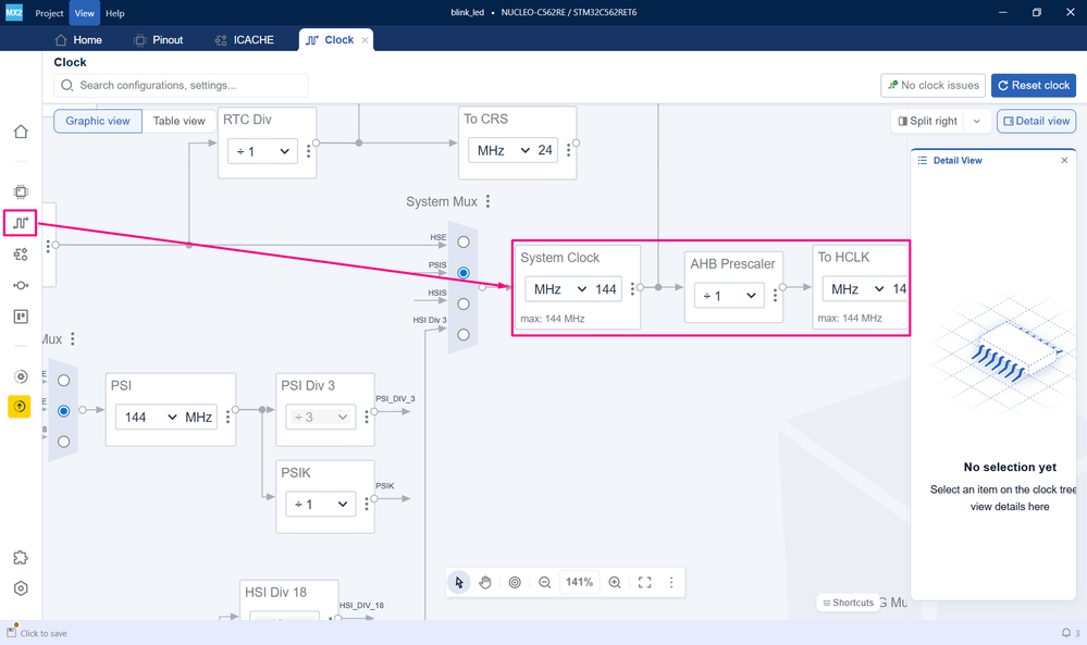

To maximize performance, increase the CPU clock frequency to 144 MHz in the clock tree.

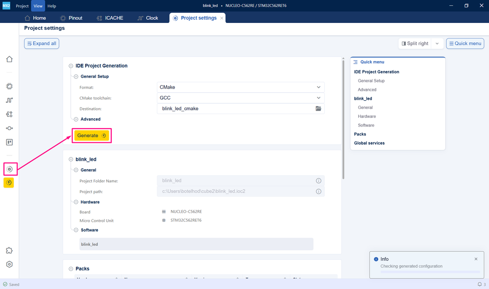

Configure the project generation settings to fit your environment. For this article, CMake is used to open the project in VS Code with the STM32Cube extension.
After completing these steps, generate the code and explore the application with the ICACHE feature enabled to achieve the best performance:

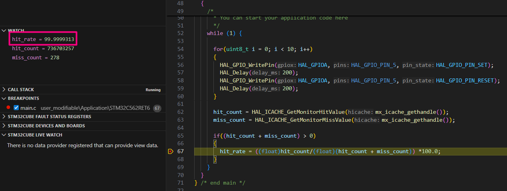

To measure the hit rate for the application, call two HAL functions to read the hit and miss counter values from the ICACHE registers:
uint32_t hit_count = HAL_ICACHE_GetMonitorHitValue(mx_icache_gethandle);
uint32_t miss_count = HAL_ICACHE_GetMonitorMissValue(mx_icache_gethandle);
With these values, compute the hit rate using the following formula:
float hit_rate = ((float)hit_count/(float)(hit_count + miss_count)) *100.0;
3.1 Validation

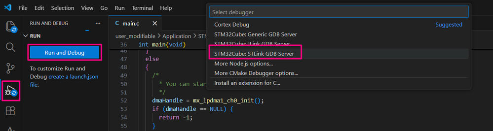

After building the application, locate the [Run and Debug] icon, create your debug session by selecting the [STM32Cube: STLINK GDB Server] option:
Add the hit_rate variable in the Watch and run the project. This code is using a simple blink LED code, and the hit rate of 99.999313% was achieved
