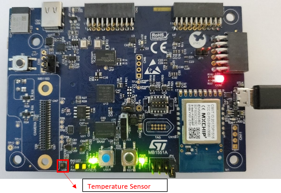

The board we use is a B-U585I-IOT20A board. It provides functionalities such as a temperature and humidity sensor (highlighted in red) as well as a low power microcontroller and other sensors such as a magnetometer, accelerometer, gyroscope, pressure, Time-of-Flight, and gesture-detection. It also provides a Wi-Fi module, which allows us to connect it to Azure IoT Central.

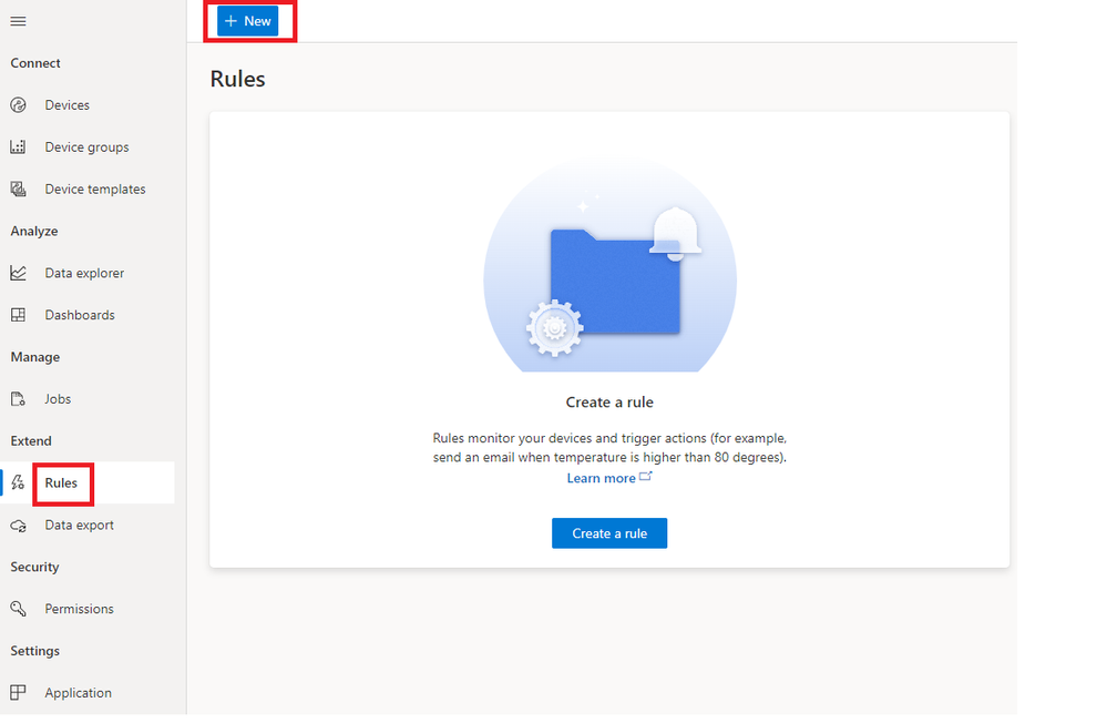

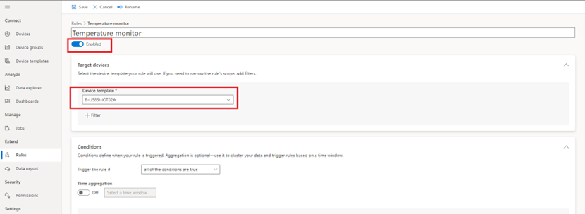

  1. In the left pane, select Rules.
  2. If you have not created any rules yet, you see the following screen:
  3. Select + New to add a new rule.
  1. Enter the name Temperature monitor to identify the rule and press Enter.
  2. Select the B-U585I-IOT20A device template.

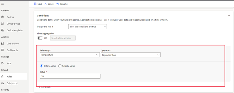

Conditions define the criteria that the rule monitors. In this tutorial, you configure the rule to fire when the temperature exceeds 20° C.
  1. Select Temperature in the Telemetry dropdown.
  2. Next, choose Is greater than as the Operator and enter 20 as the Value.

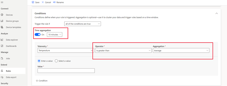

Choose an aggregation type, such as average or sum, from the aggregation drop-down menu when you choose a time aggregation.
    • The rule executes for every telemetry data point that satisfies the requirement without any aggregation. For instance, if you set the rule to activate when the temperature rises over 20, the device temperature will nearly immediately cause the rule to activate.
    • If the requirement is met using aggregation, the rule is activated if the total value of the telemetry data points inside the time span. If the rule conditions are set to trigger when the average temperature is greater than 20 in the span of 10 minute, the rule will fire only once every 10 minutes.
You can add multiple conditions to a rule by selecting + Condition. When multiple conditions are added, you can specify if all the conditions must be met or any of the conditions must be met for the rule to trigger. If you are using time aggregation with multiple conditions, all the telemetry values must be aggregated.

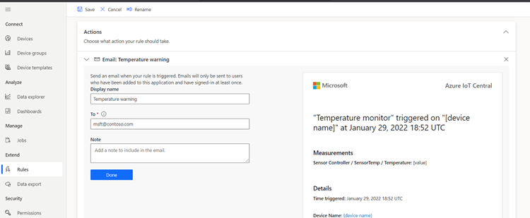

  1. Select + Email in the Actions section.
  2. Enter Temperature warning as the display name for the action, your email address in the To field.
Note: Emails are only sent to the users that have been added to the application and have logged in at least once.

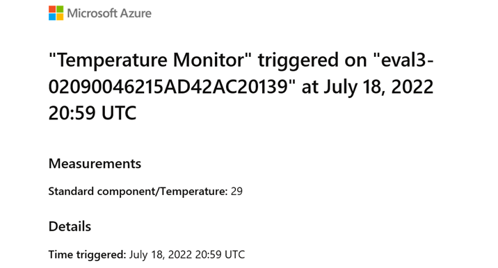

  5. After a while, you receive an email message when the rule fires:
