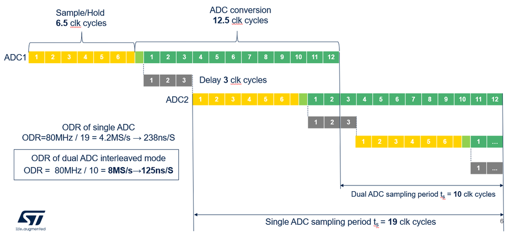

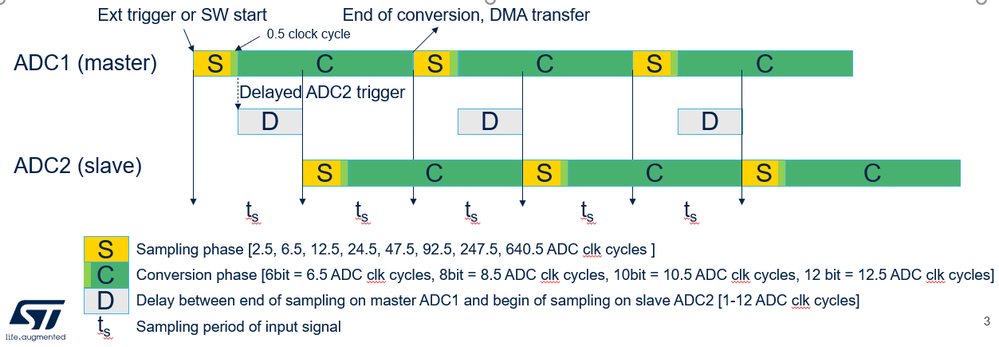

  • It allows performing faster ADC conversion by using two ADCs on the same input channel
  • Once sampling phase is finished on “master” ADC1, after programable delay D , “slave” ADC2 is triggered  by ADC1 and can start its sampling phase on the same pin

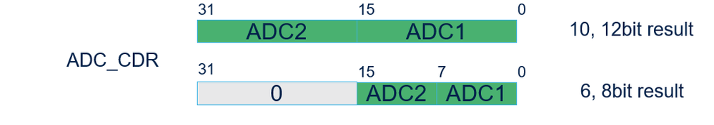

  • After ADC2 conversion finish, DMA is triggered to perform a data transfer from ADC_CDR register (Common Data Register for ADC1, ADC2) to the buffer and end of conversion flags are cleared for both ADCs
  • Depending on the selected ADC resolution content of ADC_CDR register can have different structure:
  • User is responsible for proper timing programming of ADC2 in order to have data ready for ADC1 and ADC2 at ADC1 end of conversion

  • Acquire data in ADC interleave mode @ 12-Bits resolution and high sampling rate
  • ADC input fast channel is used, see DS: PC0,PC1,PC2,PC3,PA0 can be selected as fast channels, see also AN2834 for SAR ADC sampling diagram and related details.
  • Number of samples to acquire: 40,
  • ADC clock: synchronous 80MHz (highest possible STM32L476 SYSCLK frequency),
  • Sample/Hold period T_SMPL = 6.5 clock cycles following given R_AIN/C_AIN (worst case),
  • Delay of slave ADC trigger: 3 clock cycles; T_SAR = 12.5 clock cycles (12-Bits),
  • Single ADC ts = T_SMPL + T_SAR = 19 clock cycles → trigger of slave ADC after 6.5+0.5+3=10 clock cycles, Output Data Rate of single ADC, ODR= 80MHz / 19 clock cycles = 4.2MS/s,
