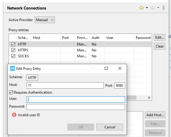

I'm right now preparing for the WS tomorrow and would like to setup my system so I'm ready. One issue I face is this part:
This is under "Network connections configuration" Proxy entries for HTTPHTTPS and SOSKS.

2021-03-16 7:03 AM
Sorry - I just saw the picture supporting my question was missing. Added now I hope this help in understanding my question :)
2021-03-16 7:19 AM
Please, try without proxy
2021-03-16 7:27 AM
please try one of the options - Direct meaning your PC is not sitting behind a proxy - clean way to the Internet, or Native - meaning the system configuration will be taken. Manual config is the last option in which you specify your proxy with credentials different from the system, or if the proxy server is different.
