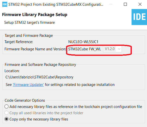

I'm working with STM32CubeWL, version 1.1.0. Starting a new project from .ioc file seems that the firmware will be upgraded to the version 1.2.0. Is this correct?
Can I find, somewhere in the source code, the firmware version?
Can I avoid this behavior? The built project compile with error (fatal error: stm32wlxx_nucleo_radio.h: No such file or directory and similar).
Starting a new project from .project file (C:\Users\fabrizio\Downloads\STM32Cube_FW_WL_V1.1.0\Projects\NUCLEO-WL55JC\Applications\LoRaWAN\LoRaWAN_End_Node\STM32CubeIDE). On this case, the project can be built without error.

2022-08-30 10:11 AM
I've found it.

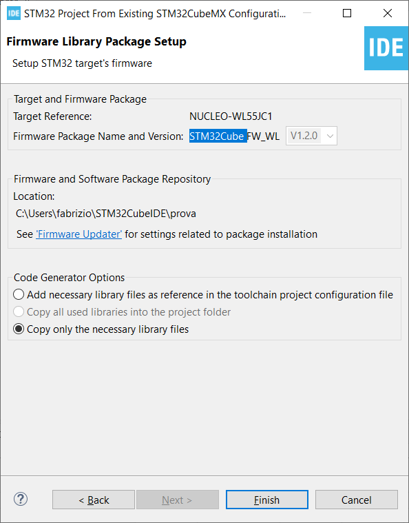

Anyway, I'm not able to change the "Firmware Relative Path", it's not editable even removing flag to Use Default Firmware Location.
Even the field "Firmware Package Name and Version" is greyed if I start new project from STM32CubeIDE.
I suppose that the same behavior is obtained editing the .ioc file and setting the item ProjectManager.LastFirmware=false
