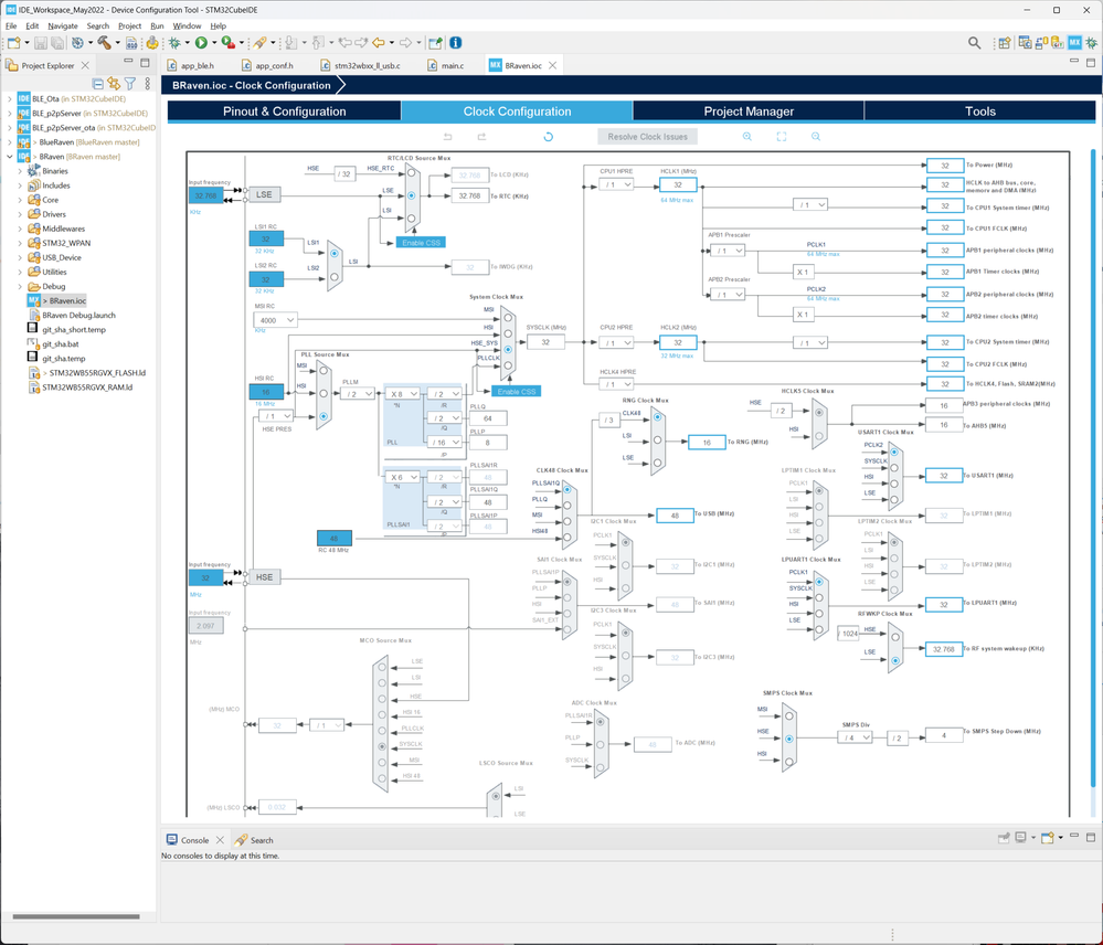

I started with the .ioc file from the P2PServer and used CubeMX to generate my own project. With the help of some code from the p2pserver project, the project works fine without USB enabled, and I was able to modify it to enable it to work with FUOTA. I used CubeMX to enable the USB full-speed device, set the heap size to 0x2000, changed the GPIO speed to very fast, changed app_conf.h to the following:
#define CFG_USB_INTERFACE_ENABLE 1and still I get the same problem where computer I plug the USB into says there's a problem with the device. I have tried disabling low power mode with no success, and I also updated the clock configuration to better match my working USB example:
@Khouloud OTHMAN @Remi QUINTIN Are there any known examples of USB working alongside USB? I just received the first small production run of a new product I'm making where I was counting on using the USB device along with BLE.
