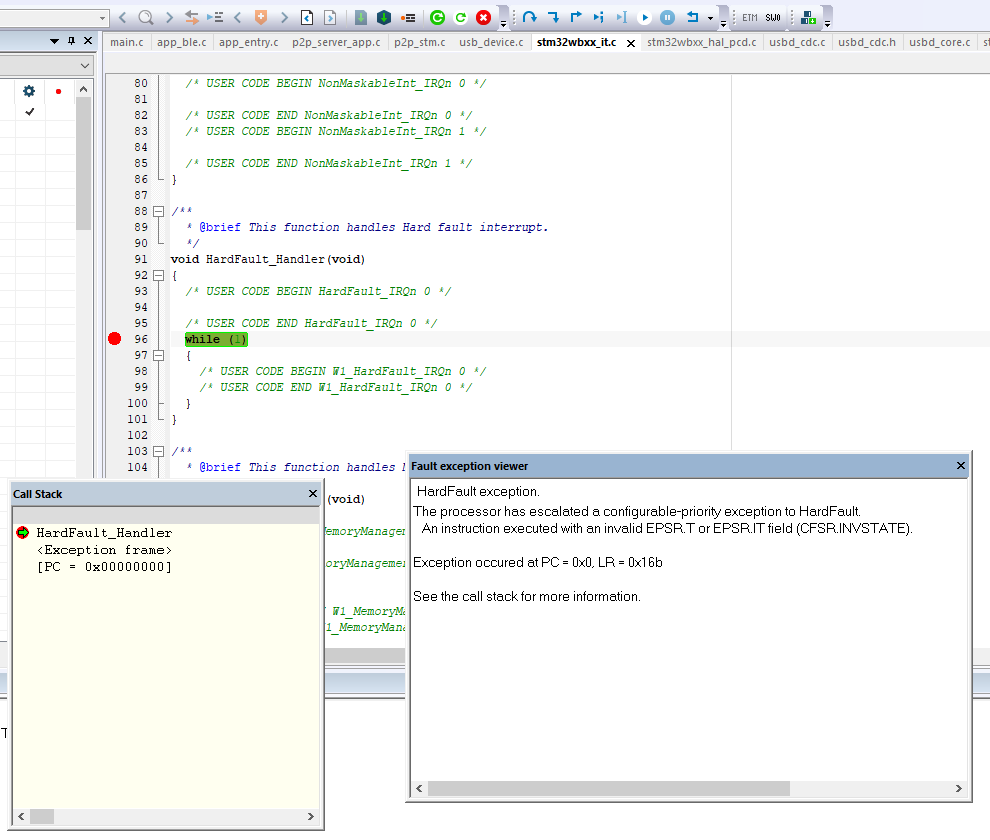

I'm using CubeMx to create a project with usb cdc serial port and BLE functionality. CubeMx generates a sequencer UTIL_SEQ_Run(~0); that runs the BLE state machine. In the code below, if I comment out UTIL_SEQ_Run(~0); the code runs fine per Workshop #3 on Youtube. Prints out the data "Hello World" to hyperterminal. As soon as I uncomment UTIL_SEQ_Run(~0); and run the app in the debugger I get a hard fault. Has anyone seen this behavior while trying to run the sequencer with usb cdc? Any thoughts as to how to debug this as far as where I should start looking?

2020-08-06 12:32 AM
Yes, I had the same issue. Apparently the BLE stack uses the USB clock for RNG purposes, and the clock can't have shared ressources.
See solution here:
2020-08-06 7:20 AM
2020-08-06 7:44 AM
Oh, yes, it doesn't look the same as the problem I was facing: I did not have a hardfault, but my USB was not working
Also, as far as I know, you're supposed to have only the UTIL_SEQ_Run(~0); in your while loop... If you want to print something (blink test with USB) try to set up a TIM interrupt that starts a new task in the sequencer.
Also, did you implement these 3 interrupts in your _it.c file? They are called by the RF stack.
