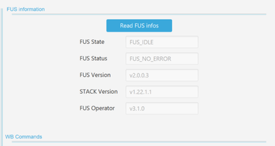

STM32Cube_FW_WB_V1.22.1/Projects/STM32WB_Copro_Wireless_Binaries/STM32WB5x/Release_Notes.html. Could you please try to connect throw USB, Update FUS and Stack and click on the button "Start Wireless Stack" (you may need to click twice if it generates an issue on the first click). If you still have an issue, Please send me the screenshot of the FUS information (similar to this one):

Hello @STTwo-32,
The board that I am having does not have a usb port configured. Does that means that it is impossible to install the wireless stack?

For now, as you can see on the first warning "With FUS v2.0.0, Coprocessor Binaries can be installed only through the USB interface". This limitation should be fixed on the future.
