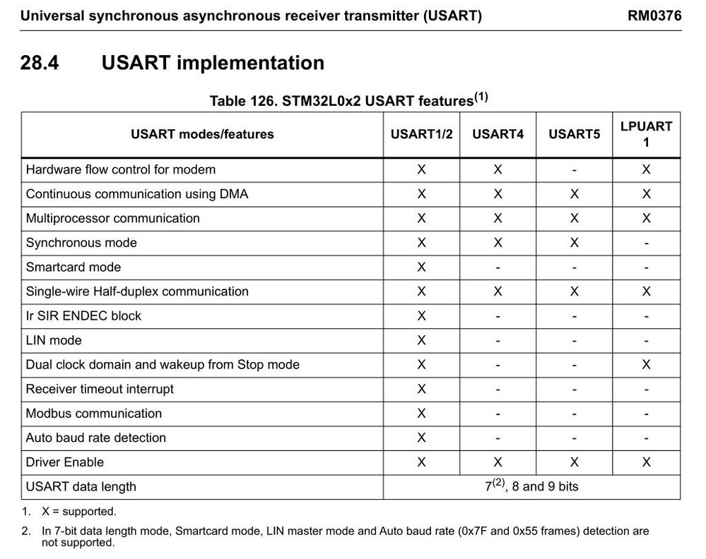

Hello, thank you for your answer!
I checked there are no other references to UART2 in the project.
It's like there's some Clock / DMA / Interrupt setting that works on UART2 that can not be applied to UART1 even if the data sheet would not look like:
