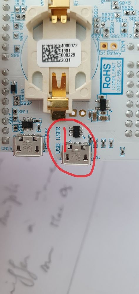

I have troubles with STM32CubeMonRF. I am trying to use sniffer with STM32WB55CGU6, but whenever I start it, I receive an error, please find attached. There was a description for most missing items. To fix it I have downloaded missing programs, copied stm32cubeMonRf_sniffer properly, but I can't figure out how to connect something to USB_USER or where can I find proper files for it. I have already checked User Manual but I could't find any answer for my problem. Could you please help me to fix this issue? I would be grateful.

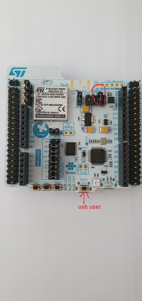

Can you tell me the board you're using, nucleo, or usb dongle. Because sniffer dongle will be supported only only in next release.
For nucleo board you need to move jumper on USB MCU 5V source and connect to USB User
see attached files
