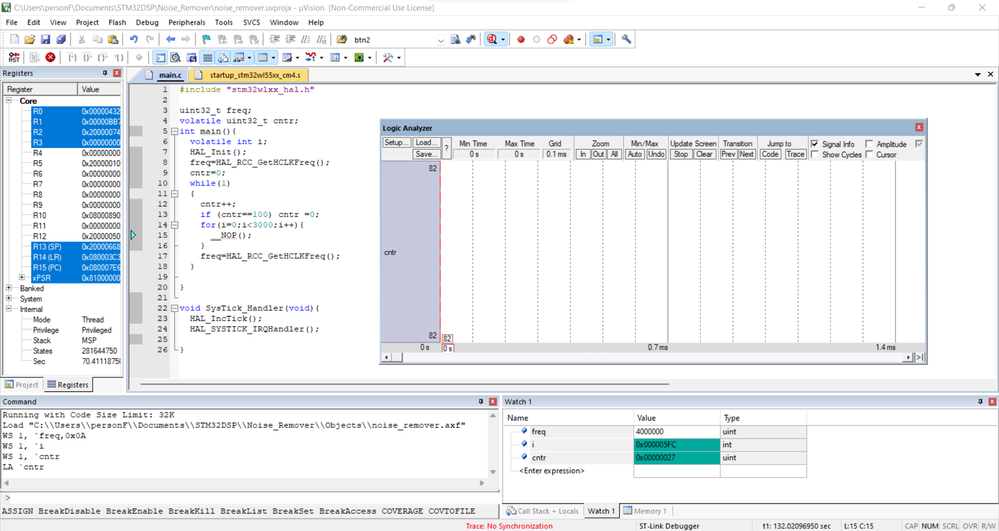

I am currently using NUCLEO-WL55JC board. However, I could not initialize the logic analyzer.
The watch tab works well, but the analyzer window seems not working. And, I have an error at the bottom showing "Trace: No Synchronization". I set the core frequency (4 MHz) as the same as board's frequency (4 MHz) as you see in the watch tab.
I checked SWO pin, it is connected.
What is your advice?
2022-04-23 1:45 AM
Solved! Inattention. "Solder Bridge 8" is labeled as "SB8", but I thought it was "Jumper 8".
"SB8" is located at the side of the CPU, I just soldered it. The trace works now!

I used an external ST-LINK debugger, but still, I could not manage to get synchronization. Anyone help?
