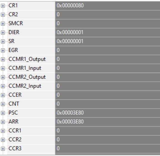

And here's the screen cap of my registers, obviously not right...
I put the breakpoint after all the initialization were done. What went wrong? Some of the registers have the right value, most don't.
Please help... once more!
