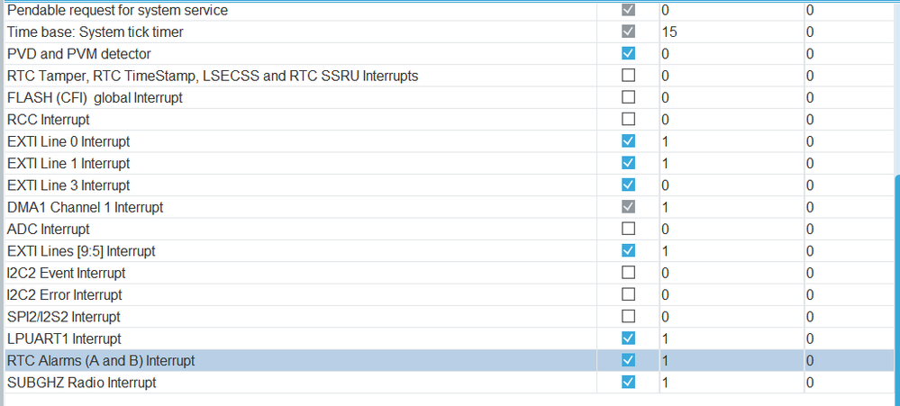

External GPIO Interrupt priority is 0(Highest) as we can't afford to miss pulse interrupt, and Timer is on priority and RTC Alarm interrupt is on priority 1 and SUBGHZ Radio interrupt on priority 1, as shown in below image.

Doing a blocking delay in the interrupt will be a problem, you need to leave immediately and check the pin state again later.

If you're blocking in the highest priority interrupt what else is going to happen?
Defer that stuff into the 1ms tick interrupt. Or timestamp signal edges and filter those.

I think you may have several possibilities :
First to avoid to been stuck and wait 50ms because of the debounce, you could add a well designed low pass filter to your reed switch to have the interrupt when you can really measure it.
Or you could, as when the TxDone interrupt is raise (without a low pass), launch a timer of 50ms that can call a function to handle your measure.
Or as @Community member said, you can lower the priority of this interrupt, because I think that RTC Alarm and SUBGHZ interrupt have to stay to the lower priority because even a little delay of a Rx can make you miss your downlink.
Anyway I think the RTC and the SUBGHZ should be at least at the same priority of your EXTI.
Please try the option you prefer and let me know if you have better results
Regards
2022-06-21 9:09 AM
The SX12xx devices will only capture signals if they are listening for them when they occur. If the chip is in an idle or transmit mode it's going to miss what's happening. Getting the chip in to an RX mode at the right frequency and channel parameters as quickly as possible increases the chance of you getting data off the air. Clearly there's still the possibility of missing data, or mid-air collisions, but if you're ready and listening at the right time, with sufficient margin, you're going to be successful more often than you will be randomly disappearing for large fractions of a second.
Interrupts and callbacks can be a big trap for sequential/linear programmers, you need to be mindful, and defer things you can't do immediately, so other things can occur concurrently.
