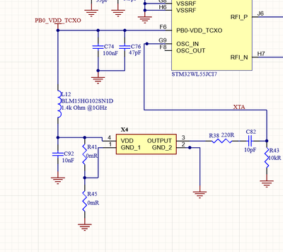

I actually determined the error and have been able to make the STM32 MCU work.
The error was that the ferrite bead leading to the RF crystal and a capacitor were accidently swapped when the board was being assembled.
L12 and C74 were swapped. This meant that the crystal was not receiving any voltage and there was no oscillation for the RF signal.

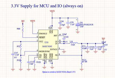

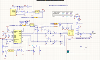

Yes, Below is the schematic for the RF and Antenna Portion of the board, I have also included the Schematic for the 3.3V Power Supply. Vsys ~ 25.6V.

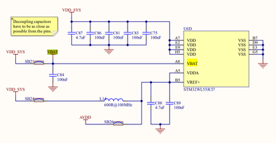

thank you for the schematic, is the VBAT pin connected to VDD on your board?
Best regards,
ST support
On this Board there is a VBAT and a VSYS, both should be around 25.6 V, the reason for the difference is that there is two power supplies on this board, a PV module and a battery. VSYS will be connected to one or both through a transistor. Interestingly a different variation of the board that was powered by the PV only worked perfect, while this variation that has both battery and PV does not work.
The VDD for the STM32, is powered from the 3.3V output from the DC-DC converter as shown above, VSYS is the supply for that converter.

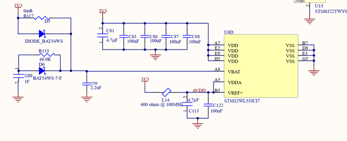

what I meant is VBAT pin on the MCU. Is it connected to VDD?
Best regards,
ST support
I see, below is our setup for our VBAT on our board.
D5 is actually supposed to be Depopulated but was accidently populated on the board, however removing D5 does not change how the antenna behaves.
FilipKremen
can you please measure voltage on the VBAT pin? Is the MCU same as on the previous board variation? Same revision?
