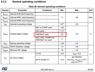

Are you using VREFBUF:

@Andrew Neil VREFBUF is disabled. RF stops transmitting when the supply voltage level is below 2.05V and I need to work with 1.8V for my application.
