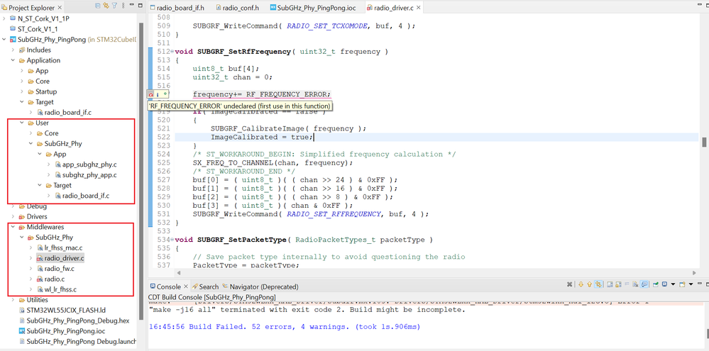

Hello, I'm practicing the "Point to Point Phy layer application lab" in the "MOOC STM32WL workshop" series.
After downloading the material and opening the project with CubeIDE and building the project, everything is fine.
however, when I try to add a peripheral like the I2C and generate the code, I always get a Board-Spesifications error.
For example, The Macro "RF_FREQUENCY_ERROR" was defined before the regeneration of the code.
I tried to delete the redundant files but it still doesn't work. i went around this by defining the peripheral manually and so far it's working, however it would be nicer and faster to have CubeMX working since the project is getting bigger.

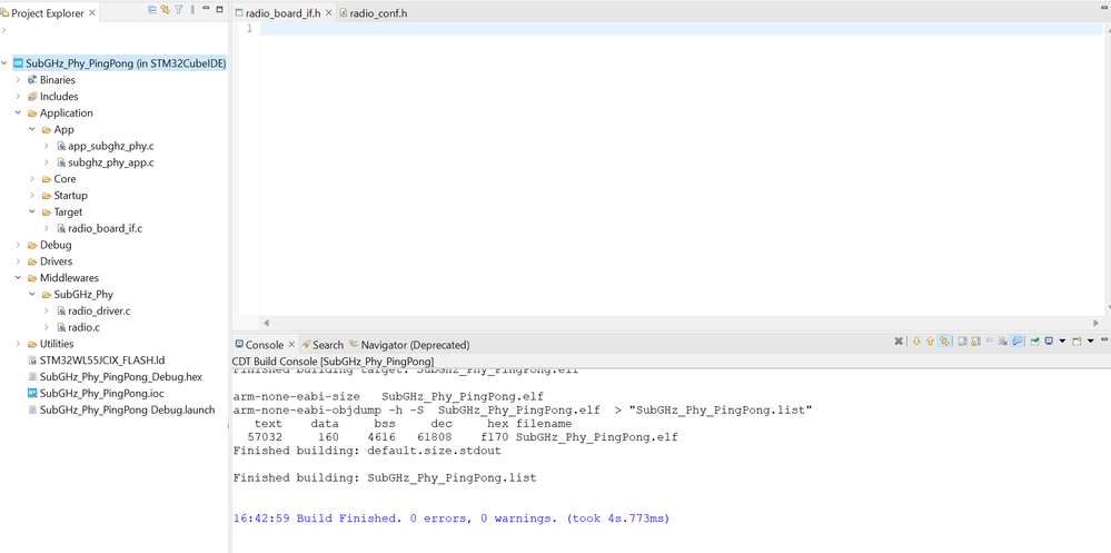

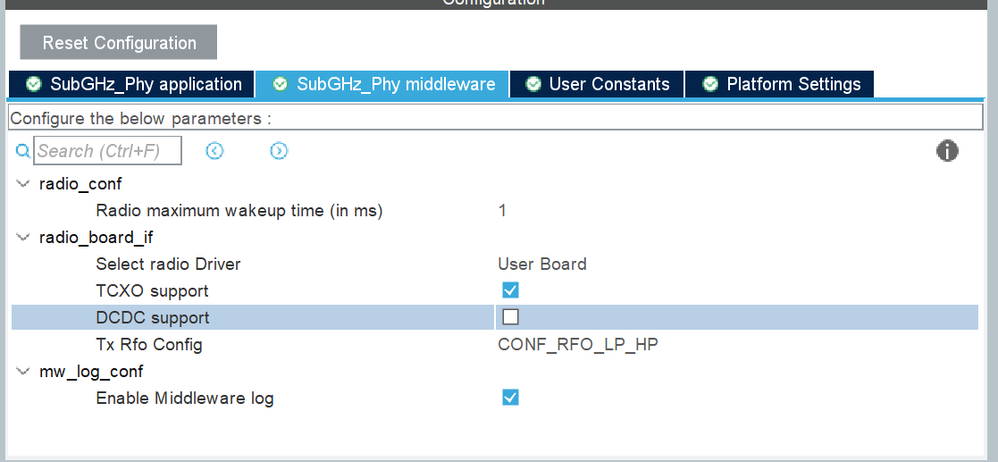

Salam, I used the same STM32Cube_FW_WL_V1.3.0 firmware version -> Ping-Pong example.
setting the radio_board_if to User Board (Fig1) and receive the same issue(Fig2).
FIG[1]
FIG[2]

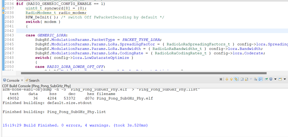

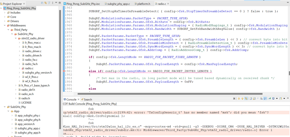

Removing all the Switch-Cases for the Non-LoRa-Modem(GFSK, GMSK) resolve the issue.
I suggest that ST adds a #ifndef for the different Modulation Codes, so only the dedicated code is the only one to be activated.

Other Errors were removed by Commenting-out the Non-LoRa Sections from the source code (not a professional solution but it works). Lastly, I had to manually copy the BSP Files of the STM32WL Radio to the BSP folder and define the #define USE_BSP_DRIVER.

2023-04-11 6:23 AM - edited 2023-11-20 8:56 AM
FIG[1]
FIG[2]
