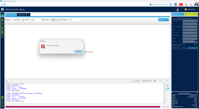

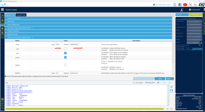

free_area_address = 0x08052000
mem::kBleStackExecAddress = 0x080D0000
I put BLE stack downloaded via my OTA implementation in free_area_address, now I start FUS and let it know via SHCI_C2_FUS_FwUpgrade to upgrade BLE stack. Our current stack is v1.16.0 and we are going to v1.21.0 hence release notes address taken from v1.21.0 for BLE stack (full).
When I provide any free flash area used as free space or scratch to this API, SFSA changes to that free area address.
This locks this area forever and I using my code or STM32CubeProgrammer cannot read or erase this area ever again.
